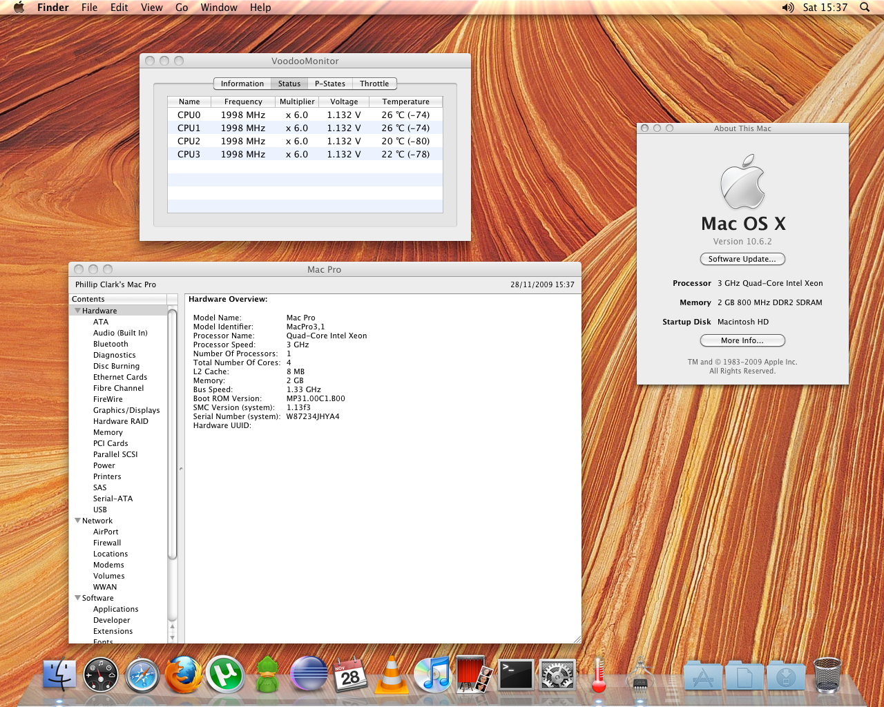

Also my motherboard GA-X48-DS4 has never been able to sleep regardless of operating system i have spoken to various gigabyte techs who were unable to resolve and suggested an RMA which i didnt want to do so i lived with it but since doing this DSDT modification sleep works 100% on mac now which is great.
Also geekbench now shows 6400 on mac and 5300 on windows 7 which i thought was lol.
attached is my current DSDT which for me has everything working.
Also a nice pic to show Temps as of this morning its slightly colder than it shud be because im freezing my ass off this morning they are usually about 28C or so which is impressive as before pstates were included they were about 40C with pstates they were about 33 -35 C and now with Cstates 28-30C.
Now finally all i have to tackle in my system is the dreaded Alc889a audio which i have working but a few irratating things like front panel doesnt work and stupid sound assertion errors in kernel.log then thats it for me no more errors in my log when booting.
One final note for anyone who is still struggling make sure your smbios.plist is using macpro 3.1 i found out last night if i removed all entries relating to model identier board etc system profiler shows as mac pro 2.1 which i though was great because app like geekbench and ibench show up as macpro however pstates then do not work this is dues the the plist entries in the ACPI_SMC_PlatformPlugin.kext if you look at the plists in there the one for macpro 2.1 has a lot less power saving techniques and this was causing all pstates to fail. this is unfortunate as when setting model to macpro 3.1 in smbios.plist ibench and geekbench now show hackintosh as model which is a shame.
Attached also is my smbios.plist just remeber to change any settings regarding FSB and memory to your own or it will change your current configuration in about this mac.
