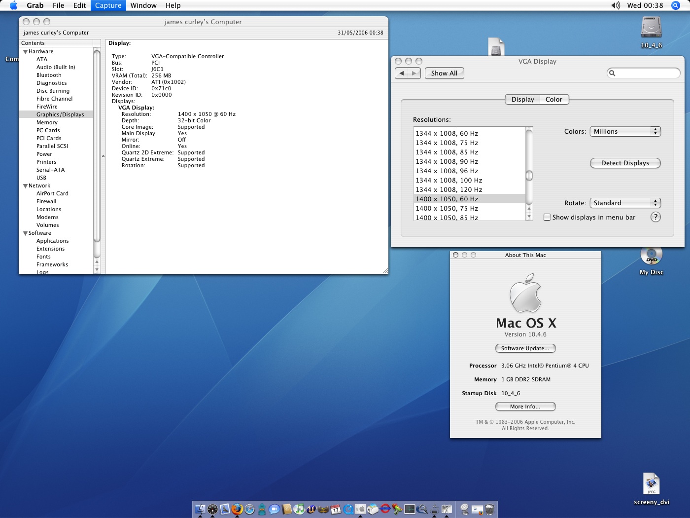

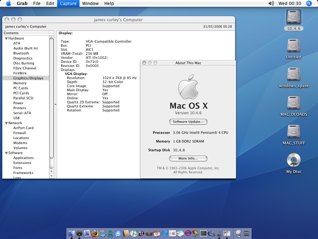

curlyboy Posted May 30, 2006 Share Posted May 30, 2006 Well i just plugged my HP pavillion mx70 standard run of the mill monitor into the DVI socket with supplied adapter and power option works absolutely perfect ,,, but not so good when in vga , also i noticed when plugged into vga the profiler / graphics show MX70 but when in DVI it shos just VGA and also when in vga socket when screen sleeps nothing but the mouse sleeps wierd huh the screen just stays there Link to comment https://www.insanelymac.com/forum/topic/17767-borisbadenov-ati-x1000-series-solution/page/25/#findComment-122153 Share on other sites More sharing options...
hanschien Posted May 31, 2006 Share Posted May 31, 2006 Same situation for me, but my monitor sleeps and resumes on DVI-VGA, but only sleeps on VGA. Link to comment https://www.insanelymac.com/forum/topic/17767-borisbadenov-ati-x1000-series-solution/page/25/#findComment-122167 Share on other sites More sharing options...
curlyboy Posted May 31, 2006 Share Posted May 31, 2006 Yeah exact same , but i dont mind bcos on the dvi with adapter it work perfect id say Link to comment https://www.insanelymac.com/forum/topic/17767-borisbadenov-ati-x1000-series-solution/page/25/#findComment-122170 Share on other sites More sharing options...
