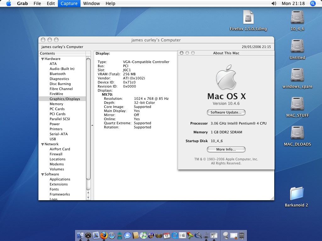

curlyboy Posted May 29, 2006 Share Posted May 29, 2006 Im the exact same as you aberracus mines works %110 its perfect Link to comment https://www.insanelymac.com/forum/topic/17767-borisbadenov-ati-x1000-series-solution/page/23/#findComment-121421 Share on other sites More sharing options...

curlyboy Posted May 29, 2006 Share Posted May 29, 2006 Yes u could be right there m8 ,,,, My Xt works absolutly perfect just like gma does Link to comment https://www.insanelymac.com/forum/topic/17767-borisbadenov-ati-x1000-series-solution/page/23/#findComment-121430 Share on other sites More sharing options...

curlyboy Posted May 29, 2006 Share Posted May 29, 2006 mines is a sapphire x1600 xt pcie (256 meg ) with ddr3 Link to comment https://www.insanelymac.com/forum/topic/17767-borisbadenov-ati-x1000-series-solution/page/23/#findComment-121452 Share on other sites More sharing options...
