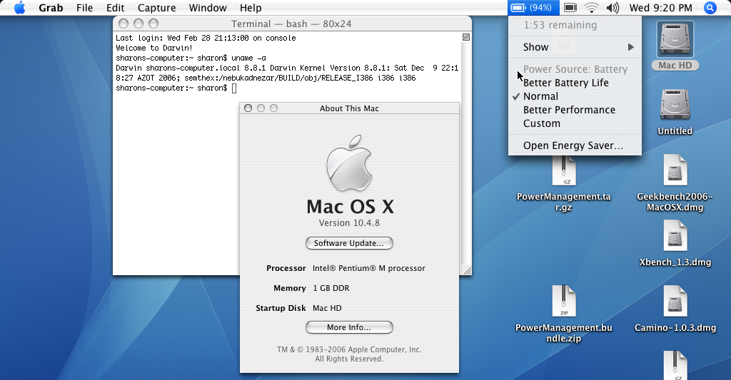

Worked for me but the instructions on the first thread are incomplete. Jas 10.4.8 SSE2 Dell Centrino Laptop.
Here is what I did to get mine working properly
1. Download the PowerManagement.tar.gz file below to your favorite location
2. Un-archive the files. This will leave you with a PowerManagement.bundle
3. Navigate to: /System/Library/SystemConfiguration
4. (Optional) Backup your old PowerManagement.bundle - copy file to another folder
5. Right click old powermanagement.bundle and select move to trash
6. Copy (drag-n-drop) the new bundle into the SystemConfiguration folder
7. Run " sudo diskutil repairPermissions " from the terminal
8. Reboot
I have found a bug. On my laptop when I have a single battery installed this application works fine. When I have two batteries installed it shows two battery icons with an AC plug logo when I am not plugged in. It thinks the one battery is charging the other and shows a timer displaying how long until the system is fully charged! Very strange but at least the percentage readout seems accurate.
