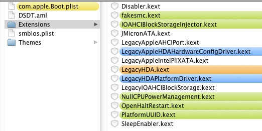

siq Posted January 10, 2010 Share Posted January 10, 2010 I got it!! Enjoying crystal clear sound out of the mighty green audio jack! Read here for further information. Ok, I should punish myself for beeing so dumb, but hey, nobody's perfect :-) Inside my Extra/Extensions folder I had a kext called AD1988b.fix.kext or something like that and this little file seemed to be responsible for the AppleHDA as well, causing it not to load the right way on startup. I deleted it, cleaned caches and BAM!, sound was working right from the start :-) So, for everyone who uses my setup (meaning a Gigabyte EP45-DS3 with ALC889a) should use exactly, what I provided in the initial post beneath this paragraph. A short list for everyone, what I did: Patched my DSDT.aml with the additional code shown beneath this paragraph with the help of tmongkol's guide. Used the 4out2insHDA LegacyHDA.kext from the ALC889a_LayoutID_885.zip for Alc889a/10.6.2 without the BuiltInHDA and including HDAEnabler.kext Did nothing to the AppleHDA.kext. Rebooted between every step. tmongkol, you're a genius! And thanks to everyone who contributed to this thread, you guys rock! Now, let's see, what Adobe CS4 says to its new environment ;-P ----------------------------------------------------------------------------------------------------------------------- Ok guys, I can feel it, I'm just a few steps away from my audio working but I definitely can'f figure out the last step. It would be nice if somebody could help me out here. My Hardware Setup: Gigabyte EP45-DS3 ALC889a Sound PowerColor HD4850 graphics 2 SATA drives (Seagate), each 1.5 Tb 2 SATA DVD-Drives OS X Setup: SL 10.6.2 vanilla install working flawlessly except audio Chameleon RC4 Problem: The Audio doesn't work. In my System Settings no audio input/output device is shown, but the System Profiler gives an me Intel Integrated Definition Audio with the Device ID set to 0x1458A002 (Dec: 3141352450) and a Layout ID set to 885. As the Layout ID is determined by the DSDT.aml and this is my desired outcome, I think I did everything right when patching it Here is the audio part of my DSDT.aml residing in my E/E-folder: Device (HDEF) { Name (_ADR, 0x001B0000) Method (_PRW, 0, NotSerialized) { Return (Package (0x02) { 0x0D, 0x05 }) } Method (_DSM, 4, NotSerialized) { Store (Package (0x08) { "codec-id", Buffer (0x04) { 0x85, 0x08, 0xEC, 0x10 }, "layout-id", Buffer (0x04) { 0x75, 0x03, 0x00, 0x00 }, "device-type", Buffer (0x10) { "Realtek ALC889A" }, "PinConfigurations", Buffer (0x18) { /* 0000 */ 0x10, 0x44, 0x11, 0x01, 0x20, 0x14, 0x01, 0x01, /* 0008 */ 0x40, 0x4C, 0x21, 0x02, 0x50, 0x34, 0x81, 0x01, /* 0010 */ 0x60, 0x9C, 0xA1, 0x02, 0xF0, 0x61, 0x4B, 0x01 } }, Local0) DTGP (Arg0, Arg1, Arg2, Arg3, RefOf (Local0)) Return (Local0) } } Next, I downloaded LegacyHDA.kext from this package: ALC889a_LayoutID_885.zip for Alc889a/10.6.2 without the BuiltInHDA and including HDAEnabler.kext, chose the 4out2inHDA-Legacy and put it in my Extra/Extensions folder on my Boot USB Thumb. My AppleHDA.kext is the original Kext from SL-DVD. (7.5 Mb in size) I'm getting a little bit desperate right now, because I have absolutely no clue what to do next or where to start from. Things I tried: Testing every LegacyHDA.kext from the above mentioned package. Outcome was the same with every file. Comparing LayoutIDs/CodecIDs in LegacyHDA.kext and DSDT.aml and they matched all. Trying out another Vanilla AppleHDA.kext for 10.6.2 from this forum that was 1.3 Mb in size. Didn't change anything except some sound-assertion errors on boot. (Which aren't responsible for my audio not working, as far as I know and read here) Did I miss something during the process? I'll provide everything from my setup that you guys need, just say it :-) greetz and thx in advance :-) Link to comment https://www.insanelymac.com/forum/topic/140941-alc889a-gigabyte-intel-now-having-a-working-front-mic/page/27/#findComment-1381697 Share on other sites More sharing options...
