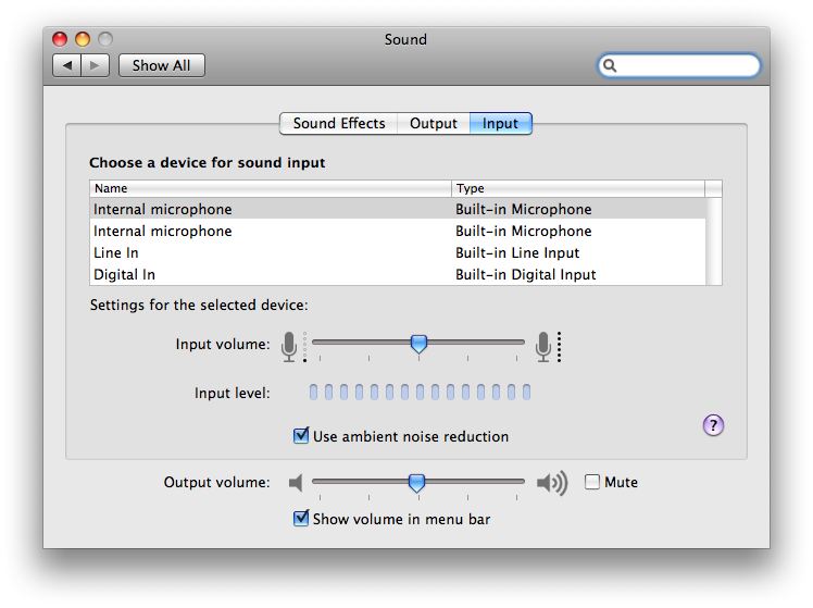

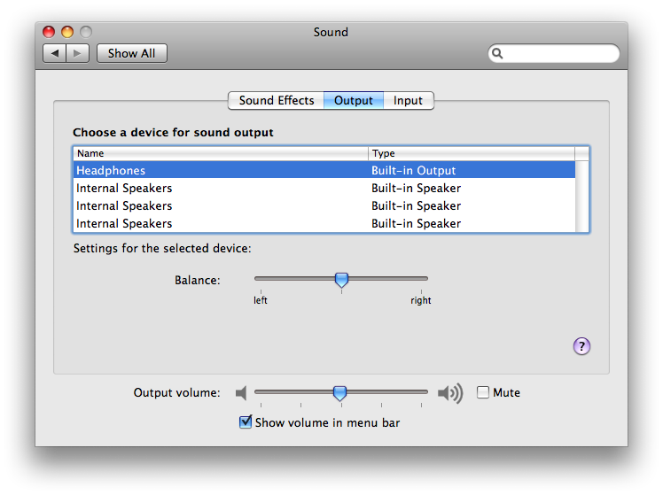

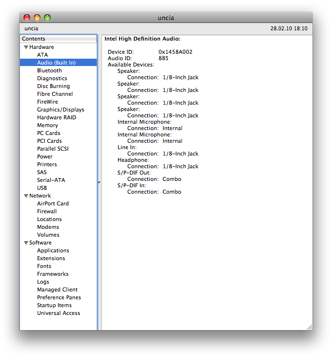

x.di Posted February 28, 2010 Share Posted February 28, 2010 I've made a better LegacyHDA.kext for 889a sound. No assertions, every port work but no "Digital Out" - AppleHda just can't handle so much ports. You will have working : Front HDA Mic Front HDA Headphone (swapped with Green Line Out) --- Back Mic Back Line In Back Digital In Back Line Out (4 ports) In DSDT you must enter this lines : Device (HDEF) { Name (_ADR, 0x001B0000) Method (_PRW, 0, NotSerialized) { Return (Package (0x02) { 0x0D, 0x03 }) } Method (_DSM, 4, NotSerialized) { Store (Package (0x06) { "built-in", Buffer (One) { 0x01 }, "layout-id", Buffer (0x04) { 0x75, 0x03, 0x00, 0x00 }, "PinConfigurations", Buffer (Zero) {} }, Local0) DTGP (Arg0, Arg1, Arg2, Arg3, RefOf (Local0)) Return (Local0) } } add LegacyHDA.kext in your /Extra/Extensions/ folder The advantages of my LegacyHDA.kext that you will have "Ambient noise reduction" for MICs and on ALL Line OUTs you will have CLEAR Sound with BASSES unlike other kexts that give you really bad sound without basses on lineouts... The trick was to change in "pinconfig" all LineOuts to "Speaker"... P.S. You can use with my LegacyHDA and VANILLA AppleHDA ALL types of surround sounds in Mac Os : 5.1 Surround 6.1 Surround 7.1 Surround 7.1 Rear Surround --- Quadraphonic Hexagonal Octagonal LegacyHDA.kext.zip Link to comment https://www.insanelymac.com/forum/topic/140941-alc889a-gigabyte-intel-now-having-a-working-front-mic/page/29/#findComment-1419950 Share on other sites More sharing options...

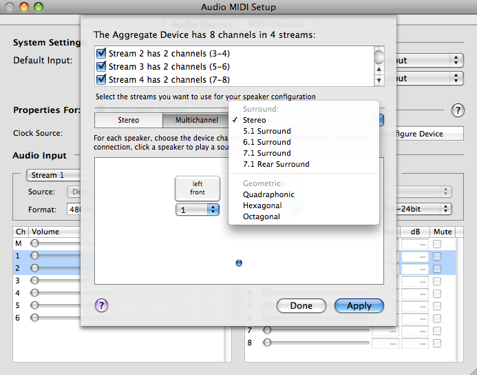

x.di Posted March 10, 2010 Share Posted March 10, 2010 thanks so much for all your work, i tried this out and it does indeed give me all outputs. a bit of help though if you would - I can only get two outputs per output in sound preferences, getting them to play all together requires aggregate device. But with this agg' device I can't seem to get iTunes to play through all speakers :s what am i doing wrong? it still only plays through the front two. it is iTunes problem VLC just works fine Link to comment https://www.insanelymac.com/forum/topic/140941-alc889a-gigabyte-intel-now-having-a-working-front-mic/page/29/#findComment-1426554 Share on other sites More sharing options...
