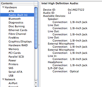

oetzi Posted November 23, 2009 Share Posted November 23, 2009 Hi Tmongkol. Really really really thanks a lot for your solutions. Here's the result... Audio issue (crack and pops in youtube) solved editing smbios setting MacPro 2,1 instead of 3,1 PCi Wifi now working, even if it's not positioned to the lower slot, but I've changed, and solved. Fake 3 Ghz issue solved editing smbios, changing SMaximalclock from 3000 to 2666 In system profiler my SATA Controller is still viewed ad Intel ESB2 AHCI Controller, instead of ICH9. I put the kext from the package you've attached in your answer into Extra/Extensions. Repair permissions (sudo chmod, chown, touch, etc...) but they doesn't seem to work. It may be related with a message I can read when I boot in verbose mode that says: SATA WARNING: identify device checksum not implemented I must say that it seems just a "make up" issue, All my HD seem to work well. It may be related to the DSDT I've compiled? When you patch a DSDT, is this procedure influenced by the system you are running into? Link to comment https://www.insanelymac.com/forum/topic/140941-alc889a-gigabyte-intel-now-having-a-working-front-mic/page/25/#findComment-1340224 Share on other sites More sharing options...

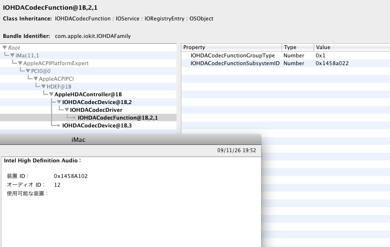

yoshiki_jp Posted November 26, 2009 Share Posted November 26, 2009 Hi! I tried to use Legacy ALC 889(not 889a) for Gigabyte P55 '3out2in HDA headphone'...failed I installed LegacyHDA.kext in /E/E. System Profiler & IORegistryExplorer: Subsystem ID are't the same Console message: Sound assertion ""( kRequestStateMatch == fCodecRequest->state )"" failed in "/SourceCache/AppleHDA/AppleHDA-179.1.4/AppleHDAController/AppleHDAController.cpp" at line 3621 goto handler Sound assertion "0 != executeCodecCommand ( fCodecList[addr], command, &fCodecVendorProductIDArray[addr] )" failed in "/SourceCache/AppleHDA/AppleHDA-179.1.4/AppleHDAController/AppleHDAController.cpp" at line 2967 goto Exit Sound assertion ""( kRequestStateMatch == fCodecRequest->state )"" failed in "/SourceCache/AppleHDA/AppleHDA-179.1.4/AppleHDAController/AppleHDAController.cpp" at line 3621 goto handler Sound assertion "0 != err" failed in "/SourceCache/AppleHDA/AppleHDA-179.1.4/IOHDAFamily/IOHDACodecDevice.cpp" at line 147 goto Exit Sound assertion "0 == codecListArray" failed in "/SourceCache/AppleHDA/AppleHDA-179.1.4/AppleHDA/AppleHDACodecGeneric.cpp" at line 126 goto Exit Sound assertion "0 == codecListArray" failed in "/SourceCache/AppleHDA/AppleHDA-179.1.4/AppleHDA/AppleHDACodecGeneric.cpp" at line 126 goto Exit ALC889 Dump@Ubantu: Codec: Realtek ALC889 Address: 2 Function Id: 0x1 Vendor Id: 0x10ec0889 Subsystem Id: 0x1458a022 Revision Id: 0x100004 c0codec_dump.txt.zip My machine: CPU: Intel core i7 860 MB: Gygabyte GA-P55A-UD4 GPU: ATI Radeon HD 4870 512MB Memory: 2GBx2 My DSDT:dsdt.zip Please help!!!! Thanks! Link to comment https://www.insanelymac.com/forum/topic/140941-alc889a-gigabyte-intel-now-having-a-working-front-mic/page/25/#findComment-1342886 Share on other sites More sharing options...
VCH888 Posted November 27, 2009 Author Share Posted November 27, 2009 Hi! I tried to use Legacy ALC 889(not 889a) for Gigabyte P55 '3out2in HDA headphone'...failed I installed LegacyHDA.kext in /E/E. System Profiler & IORegistryExplorer: Subsystem ID are't the same Console message: Sound assertion ""( kRequestStateMatch == fCodecRequest->state )"" failed in "/SourceCache/AppleHDA/AppleHDA-179.1.4/AppleHDAController/AppleHDAController.cpp" at line 3621 goto handler Sound assertion "0 != executeCodecCommand ( fCodecList[addr], command, &fCodecVendorProductIDArray[addr] )" failed in "/SourceCache/AppleHDA/AppleHDA-179.1.4/AppleHDAController/AppleHDAController.cpp" at line 2967 goto Exit Sound assertion ""( kRequestStateMatch == fCodecRequest->state )"" failed in "/SourceCache/AppleHDA/AppleHDA-179.1.4/AppleHDAController/AppleHDAController.cpp" at line 3621 goto handler Sound assertion "0 != err" failed in "/SourceCache/AppleHDA/AppleHDA-179.1.4/IOHDAFamily/IOHDACodecDevice.cpp" at line 147 goto Exit Sound assertion "0 == codecListArray" failed in "/SourceCache/AppleHDA/AppleHDA-179.1.4/AppleHDA/AppleHDACodecGeneric.cpp" at line 126 goto Exit Sound assertion "0 == codecListArray" failed in "/SourceCache/AppleHDA/AppleHDA-179.1.4/AppleHDA/AppleHDACodecGeneric.cpp" at line 126 goto Exit ALC889 Dump@Ubantu: Codec: Realtek ALC889 Address: 2 Function Id: 0x1 Vendor Id: 0x10ec0889 Subsystem Id: 0x1458a022 Revision Id: 0x100004 c0codec_dump.txt.zip My machine: CPU: Intel core i7 860 MB: Gygabyte GA-P55A-UD4 GPU: ATI Radeon HD 4870 512MB Memory: 2GBx2 My DSDT:dsdt.zip Please help!!!! Thanks! Thank you for reply and posting GA_ALC889 codec dump. It's similar to Intel's ALC889. I still have no clue. I will try to figure out. Can you use any old AppleHDA.kext (for Leopard 10.5.x) by running at 32bit? Link to comment https://www.insanelymac.com/forum/topic/140941-alc889a-gigabyte-intel-now-having-a-working-front-mic/page/25/#findComment-1344017 Share on other sites More sharing options...

t0406peru Posted November 30, 2009 Share Posted November 30, 2009 Please try the one called 885. I am not sure which LegacyHDA.kext you're using. Did you remove VoodooHDA.kext? If have it, remove it. tmongkol I spoke too soon. I got it to work this morning with this combination: HDAEnabler for Legacy 889, vanilla AppleHDA 1.5.7a24, LegacyHDA - 3out2in HDA headphone. Last night I posted in frustration... I just needed to clear my head and do it right. Sorry... Thanks for the instructions, they worked like a charm once I followed them correctly. Tom Link to comment https://www.insanelymac.com/forum/topic/140941-alc889a-gigabyte-intel-now-having-a-working-front-mic/page/25/#findComment-1346808 Share on other sites More sharing options...
