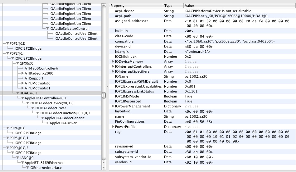

Boombeng Posted May 16, 2010 Share Posted May 16, 2010 Hi tmongkol I tried to add HDMI audio on an HD4850 but it fails with this sound assertion message : Sound assertion "0 == hdaGfxCandidate" failed in "/SourceCache/AppleHDA/AppleHDA-184.4.3/AppleHDAController/AppleHDAController.cpp" at line 980 goto Exit We can see method works somewhat in ioreg : Do you have any clue ? Thx in advance cheers Link to comment https://www.insanelymac.com/forum/topic/140941-alc889a-gigabyte-intel-now-having-a-working-front-mic/page/32/#findComment-1469254 Share on other sites More sharing options...
VCH888 Posted May 16, 2010 Author Share Posted May 16, 2010 does anyone have good idea? GeForce GT 220 HDMI Aduio is work, but GeForce 210 HDMI Audio is not work. DFI P55-T36 OnBoard Audio ALC885(codec-id 10ec0885) - GeForce GT 220 HDMI Audio(codec-id 10de000a) OK - GeForce 210 HDMI Audio(codec-id 10de000b) NG error message is below, output is unkown vendor & product id. AppleHDA.kext is patched 0a 00 de 10 by 0b 00 de 10. hexdump result diff Try to add PCIVendorDeviceID in CodecAddressMask. This is in AppleHDAController.kext. However, I think G210 HDMI audio may not be working on OS X. I will update info on my post. Hi tmongkol I tried to add HDMI audio on an HD4850 but it fails with this sound assertion message : Sound assertion "0 == hdaGfxCandidate" failed in "/SourceCache/AppleHDA/AppleHDA-184.4.3/AppleHDAController/AppleHDAController.cpp" at line 980 goto Exit We can see method works somewhat in ioreg : Do you have any clue ? Thx in advance cheers I have no idea about this error. I got framebuffers error and couldn't get HDMI audio working on 10.6.3. Waiting for 10.6.4. I have the same HDAU@0,1. Link to comment https://www.insanelymac.com/forum/topic/140941-alc889a-gigabyte-intel-now-having-a-working-front-mic/page/32/#findComment-1469369 Share on other sites More sharing options...
Boombeng Posted May 16, 2010 Share Posted May 16, 2010 ok thanks i gonna test with 10.6.4 beta, and it was the same fail with 10.6.2 applehda EDIT : disassembling AppleHDA-184.4.3 i found ATI hdmi ID (3d01aa0210) next to working nvidia one (3d0a00de10) under AppleHDAWidgetFactory::createAppleHDAWidget(DevIdStruct*) : +61 00000000000327a7 3d01aa0210 cmpl $0x1002aa01,%eax +66 00000000000327ac 0f84a2010000 jeq 0x00032954 +72 00000000000327b2 3d06421310 cmpl $0x10134206,%eax +77 00000000000327b7 0f8532030000 jneq 0x00032aef +83 00000000000327bd e99d000000 jmpq 0x0003285f +88 00000000000327c2 3d0a00de10 cmpl $0x10de000a,%eax Link to comment https://www.insanelymac.com/forum/topic/140941-alc889a-gigabyte-intel-now-having-a-working-front-mic/page/32/#findComment-1469379 Share on other sites More sharing options...
