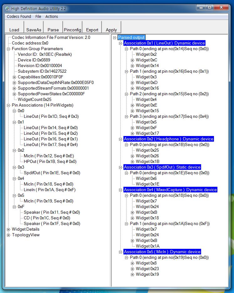

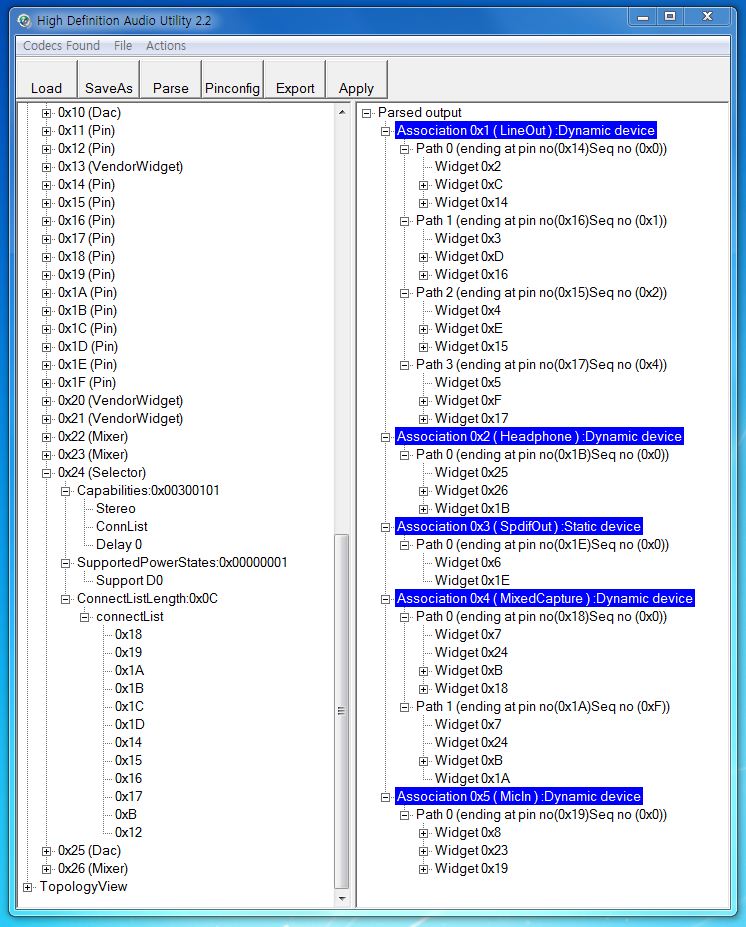

moonmage Posted October 16, 2009 Share Posted October 16, 2009 Hello tmongkol. I use HDAU Util. and codecs found. parse and Save file. and Attached screen shot. Very thanks to your concern & attendance. Best Regard. msi_x58_pro_e_alc889_HDAU.zip Link to comment https://www.insanelymac.com/forum/topic/140941-alc889a-gigabyte-intel-now-having-a-working-front-mic/page/22/#findComment-1300763 Share on other sites More sharing options...
VCH888 Posted October 17, 2009 Author Share Posted October 17, 2009 Hello tmongkol. I use HDAU Util. and codecs found. parse and Save file. and Attached screen shot. Very thanks to your concern & attendance. Best Regard. @moonmage removed I removed SPDIF In from PathMapRef. Link to comment https://www.insanelymac.com/forum/topic/140941-alc889a-gigabyte-intel-now-having-a-working-front-mic/page/22/#findComment-1301165 Share on other sites More sharing options...

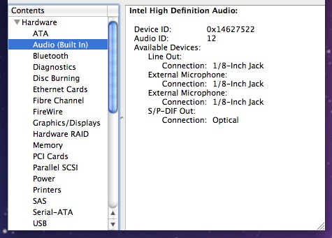

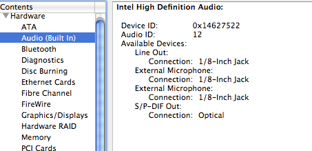

moonmage Posted October 18, 2009 Share Posted October 18, 2009 try for_testing_MSI_ALC889_4.zip Please post your results. I hope this one will work for you. I thought the problem was PathMapRef. @tmongkol It's Still not working sadly. ------------------ Intel High Definition Audio: Device ID: 0x14627522 Audio ID: 12 Available Devices: Line Out: Connection: 1/8-Inch Jack External Microphone: Connection: 1/8-Inch Jack External Microphone: Connection: 1/8-Inch Jack S/P-DIF Out: Connection: Optical ------------------- kernel netkas presents fakesmc, a kext which emulates smc deviceHDAEnabler: Copyright © 2008 by Kabyl kernel HDAEnabler: 05/05/2008 Added SP-Audio support by Taruga kernel HDAEnabler: 03/07/2009 Compiled for 32/64-bit by Taruga kernel FireWire runtime power conservation disabled. (2) kernel From path: "uuid", kernel Waiting for boot volume with UUID 197871D1-16B4-3458-B777-FF2017C67588 kernel com.apple.AppleFSCompressionTypeZlib load succeeded kernel Waiting on <dict ID="0"><key>IOProviderClass</key><string ID="1">IOResources</string><key>IOResourceMatch</key><string ID="2">boot-uuid-media</string></dict>AppleIntelCPUPowerManagementClient: ready kernel Got boot device = IOService:/AppleACPIPlatformExpert/PCI0@0/AppleACPIPCI/SATA@1F,2/AppleAHCI/CHN0@0/IOAHCIDevice@0/AppleAHCIDiskDriver/IOAHCIBlockStorageDevice/IOBlockStorageDriver/WDC WD740ADFD-00NLR5 Media/IOGUIDPartitionScheme/SN@2 kernel BSD root: disk1s2, major 14, minor 6 kernel FireWire (OHCI) VendorID 197b ID 2380 PCI now active, GUID 0010dc00019625cf; max speed s400. kernel USBMSC Identifier (non-unique): 920321111113 0x58f 0x6377 0x100 kernel AppleIntelCPUPowerManagement: Turbo Ratios 1112 kernel AppleIntelCPUPowerManagement: initialization complete com.apple.launchd[1] *** launchd[1] has started up. *** com.apple.launchd[1] *** Verbose boot, will log to /dev/console. *** bootlog[37] BOOT_TIME: 1255854585 0 blued[38] Apple Bluetooth daemon started com.apple.SecurityServer[23] Session 0x5fbff962 created com.apple.SecurityServer[23] Entering service mDNSResponder[26] mDNSResponder mDNSResponder-212.1 (Jul 24 2009 22:34:12) starting com.apple.usbmuxd[19] usbmuxd-176 built for iTunesNine on Jul 20 2009 at 13:06:53, running 32 bit kernel Waiting for DSMOS... kernel systemShutdown false configd[13] network configuration changed. configd[13] setting hostname to "owonjuui-Mac-Pro.local" kernel NTFS driver 3.0 [Flags: R/W]. kernel ** AppleSMBusPCI::start failed to get acpi path for provider kernel NTFS volume name 시스템 예약, version 3.1. kernel NTFS volume name .Win7, version 3.1. kernel HDAEnabler: Copyright © 2008 by Kabyl kernel HDAEnabler: 05/05/2008 Added SP-Audio support by Taruga kernel HDAEnabler: 03/07/2009 Compiled for 32/64-bit by Taruga kernel Previous Shutdown Cause: 3 kernel NVDANV50HAL loaded and registered. kernel Sound assertion "0 == pathMap_aDriverInstance" failed in "/SourceCache/AppleHDA/AppleHDA-174.1.1/AppleHDA/AppleHDADriver.cpp" at line 1459 goto Exit /System/Library/CoreServices/loginwindow.app/Contents/MacOS/loginwindow[27] Login Window Application Started com.apple.kextd[10] /System/Library/Extensions/IOSerialFamily.kext/Contents/PlugIns/InternalModemSupport.kext does not declare a kernel dependency; using com.apple.kernel.6.0. com.apple.kextd[10] /System/Library/Extensions/IOSerialFamily.kext/Contents/PlugIns/InternalModemSupport.kext does not declare a kernel dependency; using com.apple.kernel.6.0. kernel Sound assertion "0 != createAudioEngines ( fPathMap_aDriverInstance )" failed in "/SourceCache/AppleHDA/AppleHDA-174.1.1/AppleHDA/AppleHDADriver.cpp" at line 172 goto Exit kernel Sound assertion "0 == pathMap_aDriverInstance" failed in "/SourceCache/AppleHDA/AppleHDA-174.1.1/AppleHDA/AppleHDADriver.cpp" at line 1459 goto Exit kernel Sound assertion "0 != createAudioEngines ( fPathMap_aDriverInstance )" failed in "/SourceCache/AppleHDA/AppleHDA-174.1.1/AppleHDA/AppleHDADriver.cpp" at line 172 goto ExitDSMOS has arrived ---------------------------- HDAenabler is twice notice. Link to comment https://www.insanelymac.com/forum/topic/140941-alc889a-gigabyte-intel-now-having-a-working-front-mic/page/22/#findComment-1302325 Share on other sites More sharing options...
dgsga Posted October 18, 2009 Share Posted October 18, 2009 @tmongkol It's Still not working sadly. ------------------ Intel High Definition Audio: Device ID: 0x14627522 Audio ID: 12 Available Devices: Line Out: Connection: 1/8-Inch Jack External Microphone: Connection: 1/8-Inch Jack External Microphone: Connection: 1/8-Inch Jack S/P-DIF Out: Connection: Optical ------------------- kernel netkas presents fakesmc, a kext which emulates smc deviceHDAEnabler: Copyright � 2008 by Kabyl kernel HDAEnabler: 05/05/2008 Added SP-Audio support by Taruga kernel HDAEnabler: 03/07/2009 Compiled for 32/64-bit by Taruga kernel FireWire runtime power conservation disabled. (2) kernel From path: "uuid", kernel Waiting for boot volume with UUID 197871D1-16B4-3458-B777-FF2017C67588 kernel com.apple.AppleFSCompressionTypeZlib load succeeded kernel Waiting on <dict ID="0"><key>IOProviderClass</key><string ID="1">IOResources</string><key>IOResourceMatch</key><string ID="2">boot-uuid-media</string></dict>AppleIntelCPUPowerManagementClient: ready kernel Got boot device = IOService:/AppleACPIPlatformExpert/PCI0@0/AppleACPIPCI/SATA@1F,2/AppleAHCI/CHN0@0/IOAHCIDevice@0/AppleAHCIDiskDriver/IOAHCIBlockStorageDevice/IOBlockStorageDriver/WDC WD740ADFD-00NLR5 Media/IOGUIDPartitionScheme/SN@2 kernel BSD root: disk1s2, major 14, minor 6 kernel FireWire (OHCI) VendorID 197b ID 2380 PCI now active, GUID 0010dc00019625cf; max speed s400. kernel USBMSC Identifier (non-unique): 920321111113 0x58f 0x6377 0x100 kernel AppleIntelCPUPowerManagement: Turbo Ratios 1112 kernel AppleIntelCPUPowerManagement: initialization complete com.apple.launchd[1] *** launchd[1] has started up. *** com.apple.launchd[1] *** Verbose boot, will log to /dev/console. *** bootlog[37] BOOT_TIME: 1255854585 0 blued[38] Apple Bluetooth daemon started com.apple.SecurityServer[23] Session 0x5fbff962 created com.apple.SecurityServer[23] Entering service mDNSResponder[26] mDNSResponder mDNSResponder-212.1 (Jul 24 2009 22:34:12) starting com.apple.usbmuxd[19] usbmuxd-176 built for iTunesNine on Jul 20 2009 at 13:06:53, running 32 bit kernel Waiting for DSMOS... kernel systemShutdown false configd[13] network configuration changed. configd[13] setting hostname to "owonjuui-Mac-Pro.local" kernel NTFS driver 3.0 [Flags: R/W]. kernel ** AppleSMBusPCI::start failed to get acpi path for provider kernel NTFS volume name �‹œ�Š��…œ �˜ˆ�•�, version 3.1. kernel NTFS volume name .Win7, version 3.1. kernel HDAEnabler: Copyright � 2008 by Kabyl kernel HDAEnabler: 05/05/2008 Added SP-Audio support by Taruga kernel HDAEnabler: 03/07/2009 Compiled for 32/64-bit by Taruga kernel Previous Shutdown Cause: 3 kernel NVDANV50HAL loaded and registered. kernel Sound assertion "0 == pathMap_aDriverInstance" failed in "/SourceCache/AppleHDA/AppleHDA-174.1.1/AppleHDA/AppleHDADriver.cpp" at line 1459 goto Exit /System/Library/CoreServices/loginwindow.app/Contents/MacOS/loginwindow[27] Login Window Application Started com.apple.kextd[10] /System/Library/Extensions/IOSerialFamily.kext/Contents/PlugIns/InternalModemSupport.kext does not declare a kernel dependency; using com.apple.kernel.6.0. com.apple.kextd[10] /System/Library/Extensions/IOSerialFamily.kext/Contents/PlugIns/InternalModemSupport.kext does not declare a kernel dependency; using com.apple.kernel.6.0. kernel Sound assertion "0 != createAudioEngines ( fPathMap_aDriverInstance )" failed in "/SourceCache/AppleHDA/AppleHDA-174.1.1/AppleHDA/AppleHDADriver.cpp" at line 172 goto Exit kernel Sound assertion "0 == pathMap_aDriverInstance" failed in "/SourceCache/AppleHDA/AppleHDA-174.1.1/AppleHDA/AppleHDADriver.cpp" at line 1459 goto Exit kernel Sound assertion "0 != createAudioEngines ( fPathMap_aDriverInstance )" failed in "/SourceCache/AppleHDA/AppleHDA-174.1.1/AppleHDA/AppleHDADriver.cpp" at line 172 goto ExitDSMOS has arrived ---------------------------- HDAenabler is twice notice. @tmongkol I have exactly the same problem with my ALC889 in MSI X58 mobo. For some reason the PinConfiguration is not being injected/overridden, what appears in IORegistryExplorer under HDEF is always the pinconfigs exactly as they are in Windows Vista. What shows up in system profiler are only the inputs/outputs that AppleHDA can make sense of from this pinconfig. I've tried DSDT, EFI strings and HDAEnabler, all with the same result! If you can solve this one then you're a genius! If you need more information let me know. Link to comment https://www.insanelymac.com/forum/topic/140941-alc889a-gigabyte-intel-now-having-a-working-front-mic/page/22/#findComment-1302337 Share on other sites More sharing options...

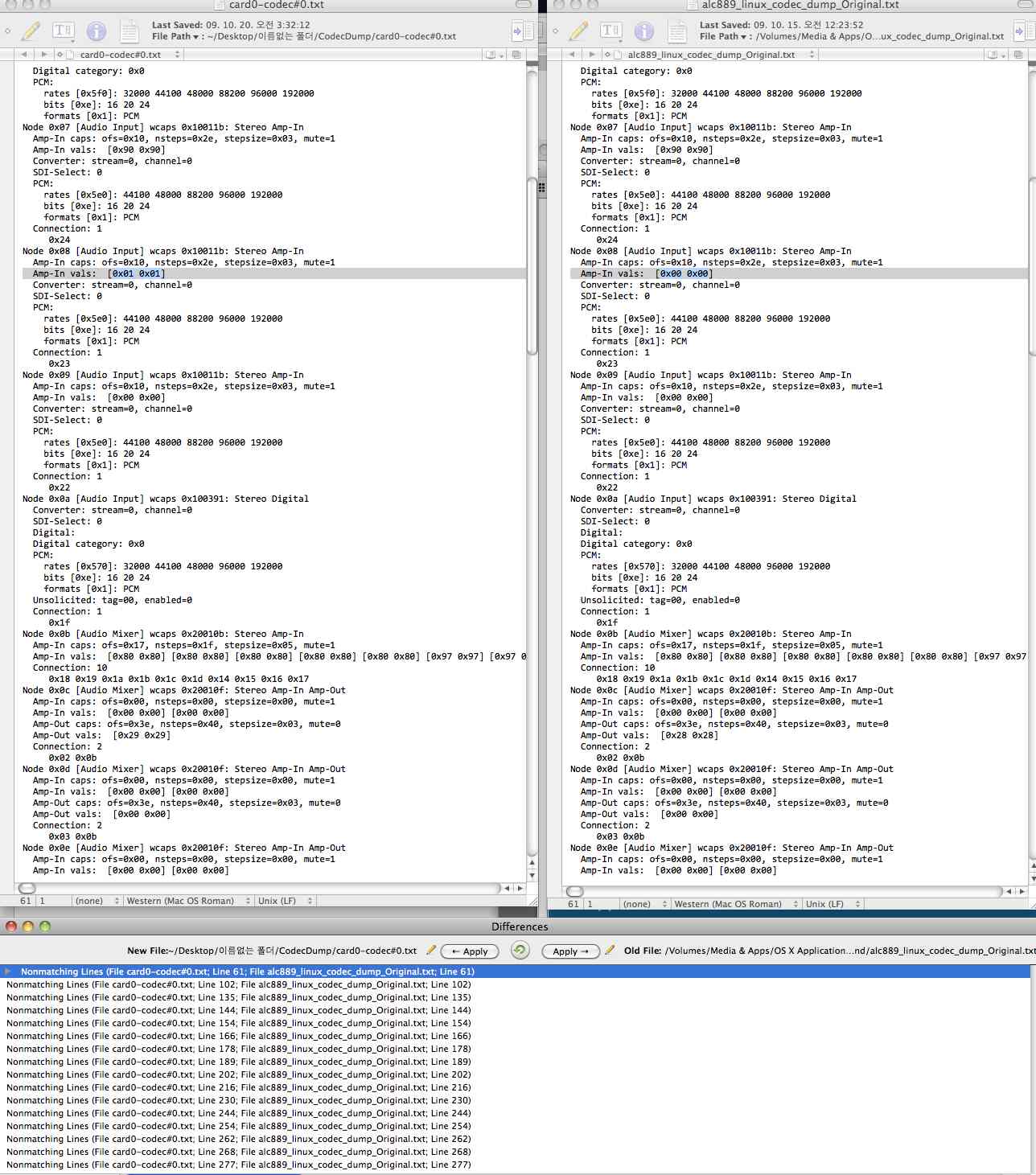

moonmage Posted October 19, 2009 Share Posted October 19, 2009 Hello again. : ) ubuntu 9.04 codec dump. It's so wierd. Past upload codec of node configration different. What mean is different node? card0_codec_0.txt.zip Link to comment https://www.insanelymac.com/forum/topic/140941-alc889a-gigabyte-intel-now-having-a-working-front-mic/page/22/#findComment-1303869 Share on other sites More sharing options...

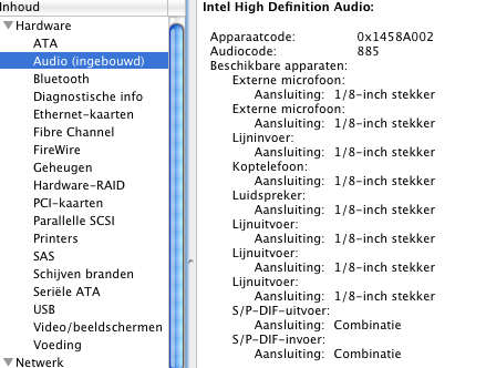

relikwie Posted October 20, 2009 Share Posted October 20, 2009 I lost it.. too much information and what not. it's not always a bless. Having the GA-EP35-DS3P rev2.1 with ALC889a I patched my DSDT and used the LegacyHDA (for my 889a) in E/E This is what I should be doing, right? If not, then O Thee Masters of sanity, correct me.. My DSDT: Device (HDEF) { Name (_ADR, 0x001B0000) Method (_DSM, 4, NotSerialized) { Store (Package (0x0A) { "built-in", Buffer (0x01) { 0x01 }, "codec-id", Buffer (0x04) { 0x85, 0x08, 0xEC, 0x10 }, "layout-id", Buffer (0x04) { 0x75, 0x03, 0x00, 0x00 }, "device-type", Buffer (0x10) { "Realtek ALC889A" }, "PinConfigurations", Buffer (0x28) { /* 0000 */ 0x10, 0x90, 0xA1, 0x01, 0x20, 0x90, 0xA1, 0x02, /* 0008 */ 0x80, 0x30, 0x81, 0x01, 0x90, 0x40, 0x21, 0x02, /* 0010 */ 0x30, 0x40, 0x11, 0x01, 0x40, 0x40, 0x01, 0x01, /* 0018 */ 0x50, 0x60, 0x01, 0x01, 0x60, 0x20, 0x01, 0x01, /* 0020 */ 0x70, 0x61, 0x4B, 0x01, 0xA0, 0x01, 0xCB, 0x01 } }, Local0) DTGP (Arg0, Arg1, Arg2, Arg3, RefOf (Local0)) Return (Local0) } } Profiler says: Yet I have no input/output devices.. Thanks many.. Link to comment https://www.insanelymac.com/forum/topic/140941-alc889a-gigabyte-intel-now-having-a-working-front-mic/page/22/#findComment-1305153 Share on other sites More sharing options...
VCH888 Posted October 21, 2009 Author Share Posted October 21, 2009 I lost it.. too much information and what not. it's not always a bless.Having the GA-EP35-DS3P rev2.1 with ALC889a I patched my DSDT and used the LegacyHDA (for my 889a) in E/E This is what I should be doing, right? If not, then O Thee Masters of sanity, correct me.. My DSDT: Profiler says: Yet I have no input/output devices.. Thanks many.. Which OS X are you using? I am not sure whether your sig. is up to date or not. If you're gonna use DSDT w/ HDEF, you need to remove HDAEnabler or Audio String, for example. Link to comment https://www.insanelymac.com/forum/topic/140941-alc889a-gigabyte-intel-now-having-a-working-front-mic/page/22/#findComment-1305763 Share on other sites More sharing options...
relikwie Posted October 21, 2009 Share Posted October 21, 2009 Which OS X are you using? I am not sure whether your sig. is up to date or not. If you're gonna use DSDT w/ HDEF, you need to remove HDAEnabler or Audio String, for example. Hi tmongkol, my sig is indeed outdated. I run 10.6.1, but hardware is still the same. Do not have hdaenabler, nor efi strings (guess you mean those strings in com.apple.boot.plist) thanks. btw, what revision is your board? do you have the latest BIOS version F6? maybe I could check your dsdt.aml and use the legcay kext you are using (if we share the same board). Link to comment https://www.insanelymac.com/forum/topic/140941-alc889a-gigabyte-intel-now-having-a-working-front-mic/page/22/#findComment-1305781 Share on other sites More sharing options...
