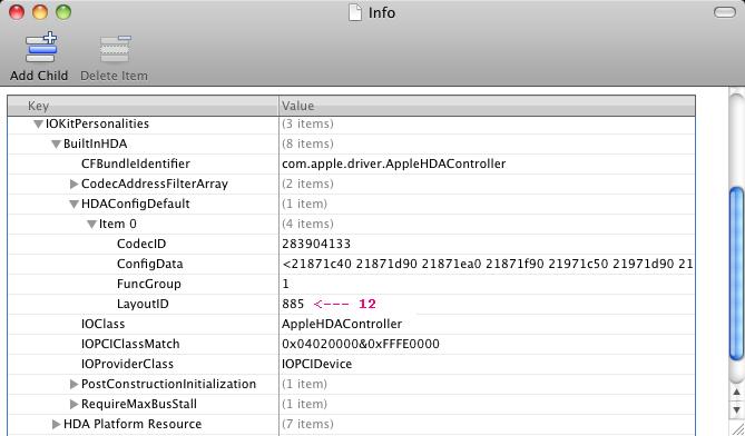

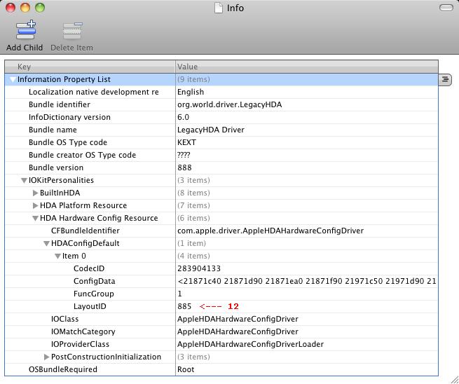

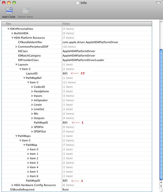

yowhatupg Posted October 2, 2009 Share Posted October 2, 2009 Can you change layout-id from 0x0C, 0x00, 0x00, 0x00 to 0x75, 0x03, 0x00, 0x00 in DSDT?I made layout-id = 885 for ALC889a. Hi again, I changed the layout-id to 885 as you suggested: Device (HDEF) { Name (_ADR, 0x001B0000) Method (_PRW, 0, NotSerialized) { Return (Package (0x02) { 0x0D, 0x05 }) } Method (_DSM, 4, NotSerialized) { Store (Package (0x0A) { "built-in", Buffer (One) { 0x01 }, "codec-id", Buffer (0x04) { 0x85, 0x08, 0xEC, 0x10 }, "layout-id", Buffer (0x04) { 0x75, 0x03, 0x00, 0x00 }, "device-type", Buffer (0x10) { "Realtek ALC889A" }, "PinConfigurations", Buffer (0x28) { /* 0000 */ 0x10, 0x90, 0xA1, 0x01, 0x20, 0x90, 0xA1, 0x02, /* 0008 */ 0x80, 0x30, 0x81, 0x01, 0x90, 0x40, 0x21, 0x02, /* 0010 */ 0x30, 0x40, 0x11, 0x01, 0x40, 0x40, 0x01, 0x01, /* 0018 */ 0x50, 0x60, 0x01, 0x01, 0x60, 0x20, 0x01, 0x01, /* 0020 */ 0x70, 0x61, 0x4B, 0x01, 0xA0, 0x01, 0xCB, 0x01 } }, Local0) DTGP (Arg0, Arg1, Arg2, Arg3, RefOf (Local0)) Return (Local0) } } But unfortunately nothing happened after I restarted (still no sound devices.) I checked the info.plist inside the LegacyKDA.kext and that is also set to 885, although some of the layout-ids inside CodecAddressFilterArray are set to 16392. Is it meant to be like that. Link to comment https://www.insanelymac.com/forum/topic/140941-alc889a-gigabyte-intel-now-having-a-working-front-mic/page/21/#findComment-1287451 Share on other sites More sharing options...
VCH888 Posted October 2, 2009 Author Share Posted October 2, 2009 Hi again, I changed the layout-id to 885 as you suggested: Device (HDEF) { Name (_ADR, 0x001B0000) Method (_PRW, 0, NotSerialized) { Return (Package (0x02) { 0x0D, 0x05 }) } [color="red"] Method (_DSM, 4, NotSerialized) { Store (Package (0x0A) { "built-in", Buffer (One) { 0x01 }, "codec-id", Buffer (0x04) { 0x85, 0x08, 0xEC, 0x10 }, "layout-id", Buffer (0x04) { 0x75, 0x03, 0x00, 0x00 }, "device-type", Buffer (0x10) { "Realtek ALC889A" }, "PinConfigurations", Buffer (0x28) { /* 0000 */ 0x10, 0x90, 0xA1, 0x01, 0x20, 0x90, 0xA1, 0x02, /* 0008 */ 0x80, 0x30, 0x81, 0x01, 0x90, 0x40, 0x21, 0x02, /* 0010 */ 0x30, 0x40, 0x11, 0x01, 0x40, 0x40, 0x01, 0x01, /* 0018 */ 0x50, 0x60, 0x01, 0x01, 0x60, 0x20, 0x01, 0x01, /* 0020 */ 0x70, 0x61, 0x4B, 0x01, 0xA0, 0x01, 0xCB, 0x01 } }, Local0) DTGP (Arg0, Arg1, Arg2, Arg3, RefOf (Local0)) Return (Local0) } [/color] } But unfortunately nothing happened after I restarted (still no sound devices.) I checked the info.plist inside the LegacyKDA.kext and that is also set to 885, although some of the layout-ids inside CodecAddressFilterArray are set to 16392. Is it meant to be like that. It's weird. It should be working. Do you have 10.5.x? Test your soundcard, please. You don't have to do anything about CodecAddressFilterArray. or You just remove Method...(red) in Device (HDEF) and use HDAEnabler.kext instead. For example, if you use HDAEnabler.kext from HDAEnabler_12, it will load layout-id of 12. It can be in /E/E. HDAEnabler_for_Snow.zip Link to comment https://www.insanelymac.com/forum/topic/140941-alc889a-gigabyte-intel-now-having-a-working-front-mic/page/21/#findComment-1287586 Share on other sites More sharing options...
yowhatupg Posted October 3, 2009 Share Posted October 3, 2009 Thanks again for all your help, I appreciate it very much. I removed the method from my dsdt.dsl and recompiled. Downloaded HDAEnabler and put #12 in /E/E. Still didn't work unfortunately. I then tried #885, rebuilt caches and restarted, but still no audio devices I'm afraid. On my Leopard disk I have 10.5.7, sound works on that one. In my Leopard /E/E I don't have any sound kexts, and in /S/L/E I have: AppleHDA.kext Apple02Audio.kext AppleAC97Audio.kext AppleAzaliaAudio.kext AppleFWAudio.kext AppleOnboardAudio.kext AppleUSBAudio.kext AudioDeviceTreeUpdater.kext AudioIPCDriver.kext IOAudioFamily.kext SM56KUSBAudioFamily.kext VirtualAudioDriver.kext Link to comment https://www.insanelymac.com/forum/topic/140941-alc889a-gigabyte-intel-now-having-a-working-front-mic/page/21/#findComment-1288136 Share on other sites More sharing options...

VCH888 Posted October 3, 2009 Author Share Posted October 3, 2009 Thanks again for all your help, I appreciate it very much. I removed the method from my dsdt.dsl and recompiled. Downloaded HDAEnabler and put #12 in /E/E. Still didn't work unfortunately. I then tried #885, rebuilt caches and restarted, but still no audio devices I'm afraid. On my Leopard disk I have 10.5.7, sound works on that one. In my Leopard /E/E I don't have any sound kexts, and in /S/L/E I have: AppleHDA.kext Apple02Audio.kext AppleAC97Audio.kext AppleAzaliaAudio.kext AppleFWAudio.kext AppleOnboardAudio.kext AppleUSBAudio.kext AudioDeviceTreeUpdater.kext AudioIPCDriver.kext IOAudioFamily.kext SM56KUSBAudioFamily.kext VirtualAudioDriver.kext Is it possible to reinstall 10.6 again? Also, could you post some pics of Sound-System Profiler and Sound-System Preferences of 10.5.7? Link to comment https://www.insanelymac.com/forum/topic/140941-alc889a-gigabyte-intel-now-having-a-working-front-mic/page/21/#findComment-1288459 Share on other sites More sharing options...

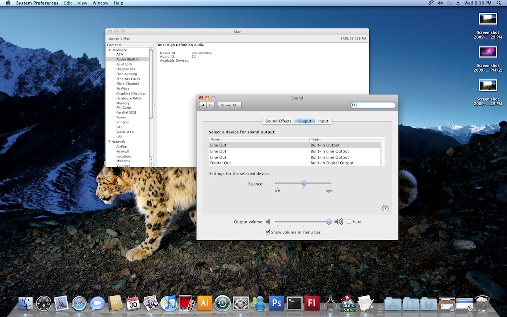

yowhatupg Posted October 4, 2009 Share Posted October 4, 2009 I'll have a go at reinstalling 10.6 later today. In the meantime, here's my 10.5.7 sound devices screenshots: Link to comment https://www.insanelymac.com/forum/topic/140941-alc889a-gigabyte-intel-now-having-a-working-front-mic/page/21/#findComment-1289039 Share on other sites More sharing options...
VCH888 Posted October 5, 2009 Author Share Posted October 5, 2009 I'll have a go at reinstalling 10.6 later today. In the meantime, here's my 10.5.7 sound devices screenshots: @ yowhatupg You have ATI graphic card, don't you. I've used DSDT.aml for running 10.5.8 on EP45-UD3R and I don't have a list of sound on ATI graphic card. I hope you successfully reinstall 10.6 and get sound on board working. Link to comment https://www.insanelymac.com/forum/topic/140941-alc889a-gigabyte-intel-now-having-a-working-front-mic/page/21/#findComment-1290045 Share on other sites More sharing options...
yowhatupg Posted October 6, 2009 Share Posted October 6, 2009 Yep, Radeon 4870 in there. I've reinstalled 10.6.0 now and my sound is working! Awesome! I have layout ID = 12 and LegacyHDA.kext with an Info.plist of the same layout id. Output switching even works, although not front mic. From what I hear that's pretty normal? Thanks again! Link to comment https://www.insanelymac.com/forum/topic/140941-alc889a-gigabyte-intel-now-having-a-working-front-mic/page/21/#findComment-1291303 Share on other sites More sharing options...
