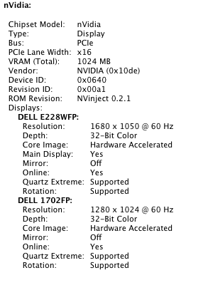

Anyway, my question is it seems I got it to work everything, my system profiler shows nVidia only in chipset model. Is there a way to show nVidia GeForce 9500GT or whatever that is supposed to show? :unsure:

It has dual DVI out, 1GB of DDR2 memory.
With NVInjectGo, I have used the below NVCAP successfully with resolution and dual DVI ports:

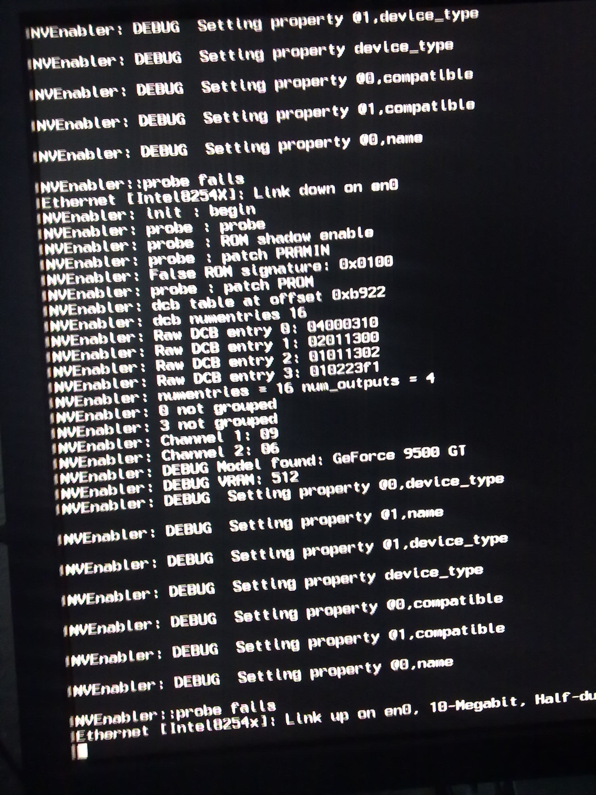

I do't get my 9500 gt to work with 10.6.2 ( Chocolate-kernel )retail with EmpireEFI. With your new files the system recognizes the card, but i starts flickering and stops booting. I took a picture of the boot screen...post-166493-1267616875_thumb.jpg
The last NVEnabler message is: "probe fails".
Btw, the chipset and vram size is recognized correct :blink:
Systemconfig does not detect the Monitor model...
Any hints?
Thank you in advance.

I'm almost ready to declare this some sort of limitation of OSX, but maybe somebody here knows what the issue is.
After *finally* getting mirror mode to work on my 9500GT/SL 10.6.3 Hackintosh using nvenabler, I noticed that one of the two screens had a 'screen tearing' effect, i.e. like playing a PC game with V-sync off. The odd thing is that its device-independent; whichever of the 2 displays is connected to the 2nd connector on the vidcard will have this tearing issue, while the monitor on the first is sync'd fine. This only occurs in mirror mode; in extended desktop both screens are sync'd fine.
It also seems to be connection independent: Either using DVI or VGA, the 2nd connector monitor will always have screen tearing in mirror mode.
Both screens are 1920x1080 native, both are set to 60hz and I have no problem mirroring them in Win7.
Oh, and this is apparently not just a hackintosh issue: the same thing happens on my Powermac G5 Quad with a 6600 in Leopard 10.5.8 with mirror mode and the same displays.
Anybody experience this issue and/or know of a fix? Thanks in advance.
I’m having an incredibly hard time getting my nVidia 9500 GT 1 gig to recognized by iAtkos 7. I noticed that when I was installing the OS from the boot disk, the system information tool was able to recognize the card properly (name, RAM etc…). It’s only after I install the OS that it is no longer recognized. Does this make sense?
I’ve tried EFI strings for the 8600 (this worked in another build I did with the same card), 9600, and custom. I’ve also tried a couple of different injectors.
If I try to add anything to the OS relating to video support, there is trouble booting and usually gives the IOkitwaitquiet or appleintelCPUpower error messages.
Why is it initially recognized and then later not recognized?

I have a nVidia 9500 GT 1GB graphics card, Gigabyte ES2L motherboard, running retail 10.5.8.
About this mac says:
nVidia GeForce 9500 GT:
Chipset Model: nVidia GeForce 9500 GT
Type: Display
Bus: PCIe
PCIe Lane Width: x16
VRAM (Total): 1024 MB
Vendor: NVIDIA (0x10de)
Device ID: 0x0640
Revision ID: 0x00a1
ROM Revision: nVidia GeForce 9500 GT OpenGL Engine [EFI]
Displays:
GTVL19W17HDF:
Resolution: 1920 x 1080 @ 50 Hz
Depth: 32-Bit Color
Core Image: Hardware Accelerated
Mirror: Off
Online: Yes
Quartz Extreme: Supported
Rotation: Supported
Interlaced: Yes
QuartzGL: Supported
Television: Yes
GTVL19W17HDF:
Resolution: 1024 x 768 @ 60 Hz
Depth: 32-Bit Color
Main Display: Yes
Mirror: Off
Online: Yes
Rotation: Supported
QuartzGL: Supported
Right, now I have two cables running form my machine to my 19" TV. A VGA and a DVI-HDMI one. The VGA works fine but only has these really low eresolutions. The DVI doesn't work. It works to start with, shows the apple logo, then goes black. I've figured its thje refresh rate because its the same in windows. However, mac will only let me have 50 or 60 Hz. It works fine at 30Hz.
Can someone please tell me how I can lower the refresh rate?
Thanks, Chris
