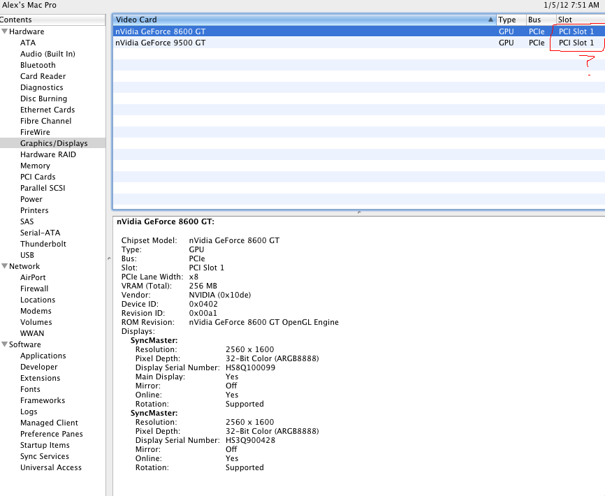

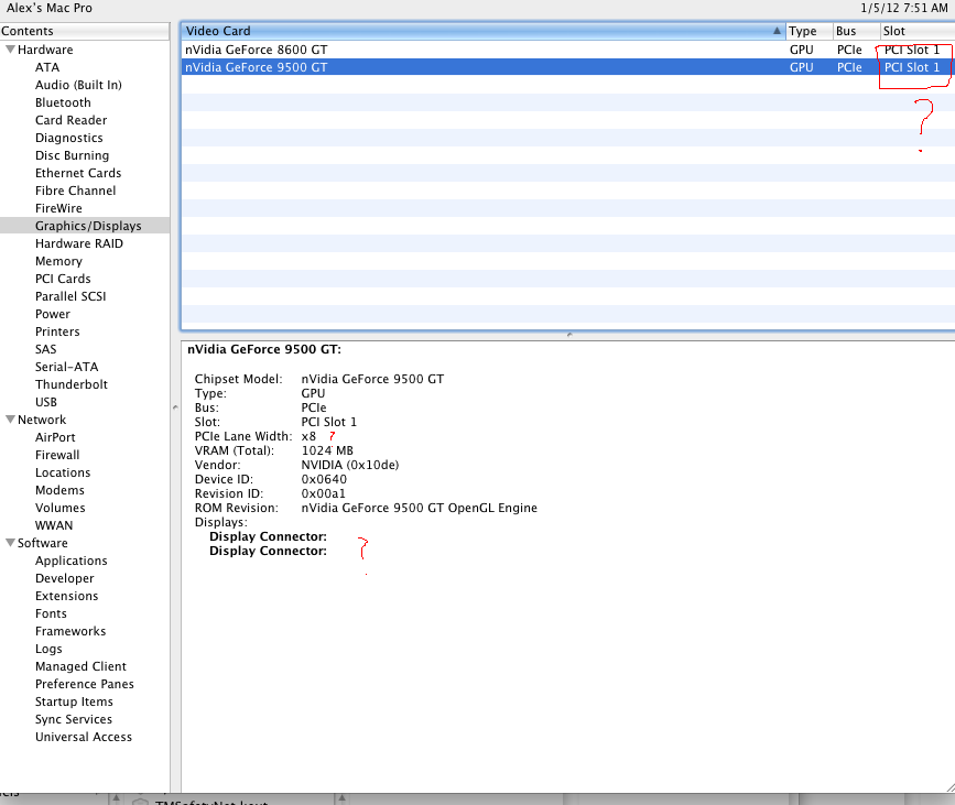

SoundForSoul Posted January 4, 2012 Share Posted January 4, 2012 I tried with Strings, but no results yet, back to DSDT method. Gigabyte x58a-ud3r rev. 2 with FF bios version, with Snow Leopard 10.6.8 I've been trying to install two graphic cards: a Gigabyte 8600 GT(256 mb) and a Gainward 9500 GT (1GB), and I got in the point where the I've put the 9500 GT in the 2nd PCI-X 16x slot, and the 8600 GT in the 4th PCI-X (8x) slot ( that was the easiest for me, as I have a moded G5 case, with the bios setting "PCI init dislpay set to PCI-X 8 ( 2 ), which is the slot that the 8600 Gt is mounted on . After selecting the partition that I want to boot from, the apple logo appears, with the white background, but without that spinning thingie, and, after few seconds, only the 2 monitors connected to the 8600 Gt are ligthing up. With the attached DSDT, both of the video card appear in the Graphic/Displays, the 8600 GT isperfectly working (at highest resolution ( 2560 x 1500 )), but the 9500 GT is not working (it is recognized, but has no outputs, even though I have two monitors plugged in its outputs). I have attached the dsdt. In the system – library – extensions – should I delete: " NVDANV40HAL.kext, NVDANVs0HAL.kext. , NVDARESMAN.kext and NVSMU.kext when using dsdt ? Are those injectors? I have edited the org.Chameleon.boot.plist in the \extra folder so that no strings or grahics enabler appears, i did that in the System configuration folder's boot.plist, too . Should I try to switch the position of the GFX Cards and put the 8600 GT in the second 16 pci-x instead of the 8x one or should I try to further edit the dsdt file, since both gfx cards appear to be in the 1st pci slot, in the Graphics/Display, section? Do you have any idea how to solve that ? I am willing to pay for somebody to help me, I have already lost 3 days of trying… If someone could recommend me a 4 output or at least 2 gfx that will work for sure with my setup, I could buy them. Thank you so much in advance! dsdt+png.rar Link to comment Share on other sites More sharing options...

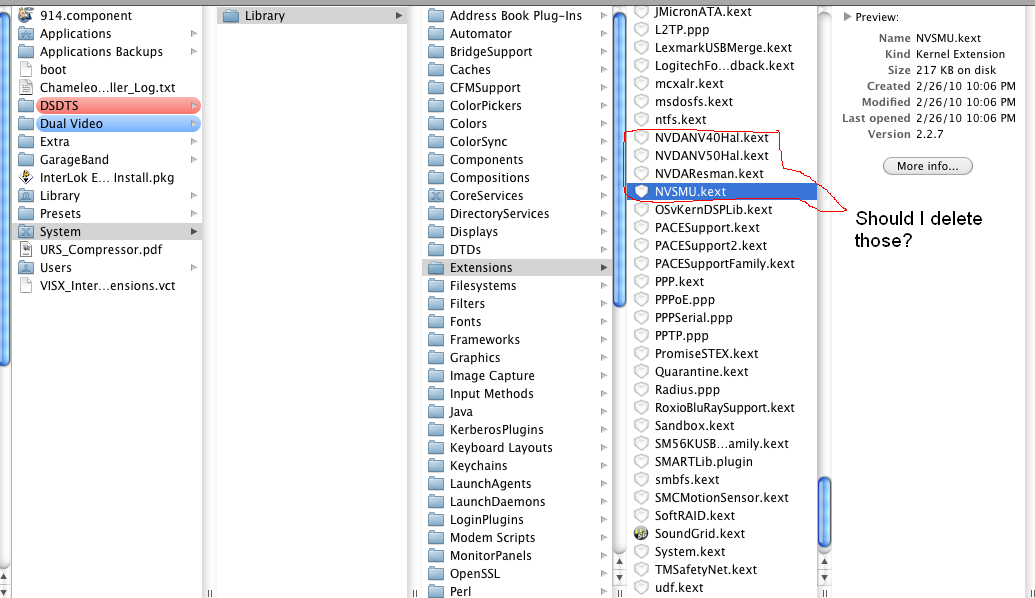

ollvin Posted January 5, 2012 Share Posted January 5, 2012 Hi everyone, I'm not sure this is the right place to post... Here is my problem : I've been working for 1 year and a half with kakewalk on a Gigabyte X58A UD3R config (see signature for details). With Os 10.6.6. I'm now having trouble with the Nvidia 9500GT card in newer version of 3d apps (Daz Studio...), and even display bugs in Word. Looks like all this is comming from the graphic card. I see on Nvidia's website that there is no official drivers for the card on mac so I don't even know how it's really working on this hackintosh. What can I do to fix theses graphic problems ? Is there any kext stuff or so that can be updated just for the card ? I'm a bit lost with hardware trouble solving on hackintosh. If someone can point me the way to go... Thanks Link to comment Share on other sites More sharing options...
Gringo Vermelho Posted January 5, 2012 Share Posted January 5, 2012 There is no 9500 GT for Mac, that's why you don't find anything. These drivers will work: http://www.nvidia.co...f03-driver.html The model identifier requirement can be overridden by editing distribution.dist inside the installer package. If you have edited NVDANV50Hal.kext before, you will have to edit it again. Link to comment Share on other sites More sharing options...
