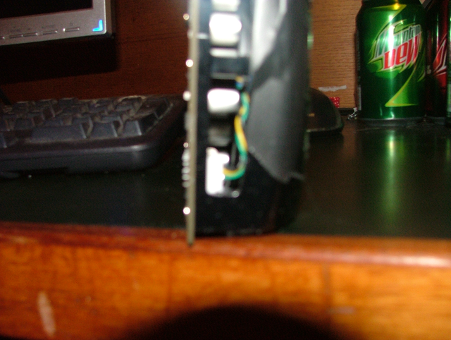

flibblesan Posted October 22, 2008 Share Posted October 22, 2008 The .zip seems to work a charm on my 9800GTX + 10.5.5 Fan kicks in on bootup, then slows down again, hoping it'll keep it high enough to keep cool though Hmm, so I wonder if there's a way to control the fan also now <.< Mayby by some console magic ? I was worried about my card as the fan didn't appear to be spinning up enough as I was playing games, so I've disconnected the blue wire to force the fan to run 100%. Link to comment https://www.insanelymac.com/forum/topic/131914-g949600gt-is-fully-supported-by-new-mbp-drivers/page/5/#findComment-940631 Share on other sites More sharing options...

macgirl Posted October 23, 2008 Share Posted October 23, 2008 I was worried about my card as the fan didn't appear to be spinning up enough as I was playing games, so I've disconnected the blue wire to force the fan to run 100%. What wire? Could you take a photo and post it please. Link to comment https://www.insanelymac.com/forum/topic/131914-g949600gt-is-fully-supported-by-new-mbp-drivers/page/5/#findComment-941334 Share on other sites More sharing options...

flibblesan Posted October 23, 2008 Share Posted October 23, 2008 What wire? Could you take a photo and post it please. Sorry for the quality of photo. If needed I'll try and do another one. You are looking at the rear of the card (DVI ports being the front) and you can make out the white plug for the fan. This has some coloured wires going into it. You need to remove the blue wire - this is the fan signal and controls the fan speed. Removing it causes the fan to spin 100% at all times Anyone having issues when resuming from sleep? Whenever I do, my monitor doesn't wake. It stays in standby mode, but the rest of the system wakes. I have my system in S3 mode and that "Load VGA BIOS on S3 resume" in my BIOS set to auto. Does anyone have any sugestions? Do you have your monitor plugged into the monitor socket on the left (as if you are looking at the back of the case) that is, the port closest to the motherboard. Link to comment https://www.insanelymac.com/forum/topic/131914-g949600gt-is-fully-supported-by-new-mbp-drivers/page/5/#findComment-941440 Share on other sites More sharing options...
