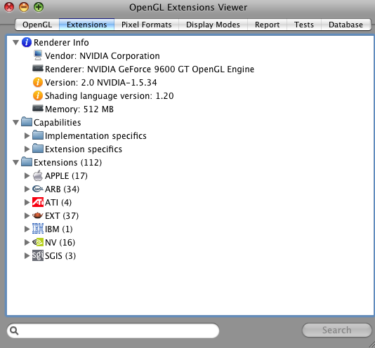

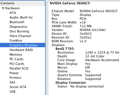

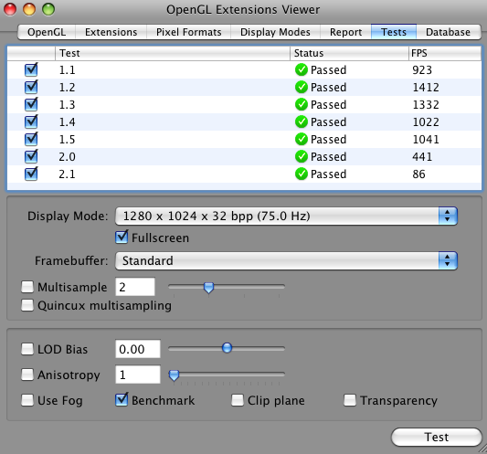

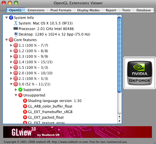

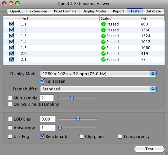

netkas Posted October 18, 2008 Share Posted October 18, 2008 plz make screenshots of this app (second tab and benchmark) http://www.realtech-vr.com/glview/download.html Link to comment https://www.insanelymac.com/forum/topic/131914-g949600gt-is-fully-supported-by-new-mbp-drivers/#findComment-935246 Share on other sites More sharing options...

generalmilk Posted October 18, 2008 Author Share Posted October 18, 2008 plz make screenshots of this app (second tab and benchmark) http://www.realtech-vr.com/glview/download.html sorry, my first thing after installed the driver is benchmark opengl, but I forgot to post the screenshot Link to comment https://www.insanelymac.com/forum/topic/131914-g949600gt-is-fully-supported-by-new-mbp-drivers/#findComment-935290 Share on other sites More sharing options...

cyclonefr Posted October 18, 2008 Share Posted October 18, 2008 can you post a screenshot of the second tab of opengl extensions ?the one that says 9600 GT opengl engine Link to comment https://www.insanelymac.com/forum/topic/131914-g949600gt-is-fully-supported-by-new-mbp-drivers/#findComment-935375 Share on other sites More sharing options...

cyclonefr Posted October 18, 2008 Share Posted October 18, 2008 nah this isn't a joke, i'm not surprised it works. GO try it yourself you 9600 users. I just wanna see a screenshot to see the 9600 GT specs (opengl 3 should be 30%) that's all i believe him. Link to comment https://www.insanelymac.com/forum/topic/131914-g949600gt-is-fully-supported-by-new-mbp-drivers/#findComment-935679 Share on other sites More sharing options...

generalmilk Posted October 19, 2008 Author Share Posted October 19, 2008 RaidenII So you got the right EFI string and leopard recognize your video card correctly? You can see if NVDANV50Hal.kext is loaded in about this mac-> more-> software->extentions Link to comment https://www.insanelymac.com/forum/topic/131914-g949600gt-is-fully-supported-by-new-mbp-drivers/#findComment-935928 Share on other sites More sharing options...
