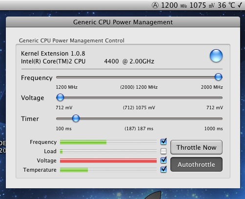

mitch_de Posted October 14, 2008 Share Posted October 14, 2008 Hi, superhai. With newest versions some wrong with vids (and pstates). I only seem to have 2 pstates (min MHZ and max MHZ, nothing between. VIDs : Only one?! (last version more) Control app shows at slider min/max same, much to less values (712mV). Setting is 1075mV , but that stays same, min MHZ and max MHZ - before it changes. GA-EP35-DS3 (ACPI-Bug - no PSTATES), C2D 4400, 960MHZ Bus (240), 2400 MHZ (OC from 2000) debug log: GenericCPUPowerManagement: [Debug] Starting probe... GenericCPUPowerManagement: [Debug] Got I/O Kit CPU 0 (0) named CPU0 GenericCPUPowerManagement: [Debug] Got I/O Kit CPU 1 (1) named CPU1 GenericCPUPowerManagement: [Debug] Enhanced Intel Speedstep is supported GenericCPUPowerManagement: [Debug] CPU type Intel® Core2 CPU 4400 @ 2.00GHz [6f2] GenericCPUPowerManagement: [Debug] CPU low 7125/10 mV step 125/10 mV mobile 0 GenericCPUPowerManagement: [Debug] CPU bus frequency is 200 MHz GenericCPUPowerManagement: [Debug] CPU max frequency 2000 MHz MSR ratio a GenericCPUPowerManagement: [Debug] CPU min frequency 1200 MHz MSR ratio 6 GenericCPUPowerManagement: [Debug] Thermal Junction Max is 100 C current temperature is 33 C GenericCPUPowerManagement: [Debug] Got ACPI CPU 0 named CPU0 GenericCPUPowerManagement: [Debug] ACPI Machine type 1 GBT GenericCPUPowerManagement: [Debug] Pass p-control from BIOS, writing 34 to port b2 GenericCPUPowerManagement: [Warning] No ACPI p-states in table GenericCPUPowerManagement: [Debug] Got ACPI CPU 1 named CPU1 GenericCPUPowerManagement: [Warning] No ACPI p-states in table GenericCPUPowerManagement: [Debug] Got ACPI CPU 2 named CPU2 GenericCPUPowerManagement: [Warning] No ACPI p-states in table GenericCPUPowerManagement: [Debug] Got ACPI CPU 3 named CPU3 GenericCPUPowerManagement: [Warning] No ACPI p-states in table GenericCPUPowerManagement: [Debug] I/O Kit CPU count (2) is different from ACPI CPU count (4) GenericCPUPowerManagement: [Debug] P-state 0 -> fid 10, vid 0 GenericCPUPowerManagement: [Debug] P-state 1 -> fid 9, vid 0 GenericCPUPowerManagement: [Debug] P-state 2 -> fid 8, vid 0 GenericCPUPowerManagement: [Debug] P-state 3 -> fid 6, vid 0 GenericCPUPowerManagement: [Debug] --- GenericCPUPowerManagement: Generic CPU Power Management Driver 1.0 © 2008 Superhai Development Co, based on works by mercurysquad GenericCPUPowerManagement: For internal use only. All Rights Reserved. Support and documentaion http://www.superhai.com/ GenericCPUPowerManagement: [Debug] --- GenericCPUPowerManagement: [Debug] EIST Enabled and Unlocked GenericCPUPowerManagement: [Debug] Clock rate: CPU 2000 MHz - Bus 800 MHz - Dec 1000 MHz GenericCPUPowerManagement: [Debug] Bus clock rate 100000000 - den 1 GenericCPUPowerManagement: [Debug] Bus/CPU rate 10 - den 2 GenericCPUPowerManagement: [Debug] Bus/dec rate 1 - den 0 GenericCPUPowerManagement: [Debug] Timebase frequency 1000000000 hz GenericCPUPowerManagement: [Debug] CPU min/max (1200 MHz - 2000 MHz) GenericCPUPowerManagement: [Debug] Bus min/max (800 MHz - 800 MHz) GenericCPUPowerManagement: [Debug] Auto timeout 250, high 600, low 400 GenericCPUPowerManagement: [Debug] We have loaded completely and ready for action bash-3.2# THANKS for adding temp Link to comment Share on other sites More sharing options...
Superhai Posted October 14, 2008 Author Share Posted October 14, 2008 Hi, superhai.With newest versions some wrong with vids (and pstates). I only seem to have 2 pstates (min MHZ and max MHZ, nothing between. VIDs : Only one?! (last version more) Control app shows at slider min/max same, much to less values (712mV). Setting is 1075mV , but that stays same, min MHZ and max MHZ - before it changes. I found the bug, will fix it soon, until further you can set the VID-override to true in Info.plist, or remove the other VID entries. I set default to 4 p-states, I dont think it will be any gain to have more than 4. Link to comment Share on other sites More sharing options...
