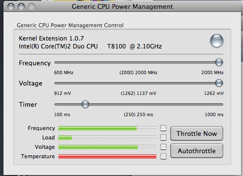

mrroboto Posted October 12, 2008 Share Posted October 12, 2008 I still have a max value of 2000MHz instead of 2100MHz. Look at the screenshot. ioreg -lxw0 -r -c GenericCPUPowerManagement | grep "CPU " "CPU Status" = {"Auto Throttle"=Yes,"Load"=0x6e,"Temperature"=0xffffffffffffffbc,"High jump"=0x258,"Voltage"=0x3b6,"Timer"=0xfa,"Low jump"=0x190,"Frequency"=0x320,"Kext Timer"=0x2cf,"Kext Online"=Yes,"Current state"=0x3,"Voltage ID"=0x13,"Frequency ID"=0x88} "CPU Init" = {"CTL max"=0x4b2c,"FSB frequency min"=0x190,"Signature"=0x10676,"FSB frequency max"=0x320,"CTL min"=0x8810,"Kext unlock"=Yes,"Kext version"=0x10007,"Brand string"="Intel® Core2 Duo CPU T8100 @ 2.10GHz","Voltage max"=0x4ee,"Frequency min"=0x258,"Frequency max"=0x7d0,"Voltage min"=0x390} ioreg -lw0 | grep PerformanceStateArray | | "PerformanceStateArray" = (<35080000b88800000a0000000a000000284b0000284b0000>,<34080000b88800000a0000000a000000224a0000224a0000>,<40060000c05d00000a0000000a0000001c0800001c080000>,<b0040000803e00000a0000000a0000001706000017060000>,<20030000b03600000a0000000a0000001388000013880000>) also the new app doesn't show anything on the tray bar. Link to comment Share on other sites More sharing options...

mrroboto Posted October 12, 2008 Share Posted October 12, 2008 And about the T8100 cpu I have a fix (also all other CPUs that have x.5 as max FSB if there are others) but I need to have some information confirmed first. But it should throttle to max ratio when using autothrottle even tough it doesnt say so. And I also added the shutdown/reboot fix into this kext. (from dfe) That's nice, thanx superhai for the work. i also noticed that the min value wih the prevoius version was 600MHz but not came back to 800MHz. i don't know wich is right. Link to comment Share on other sites More sharing options...
