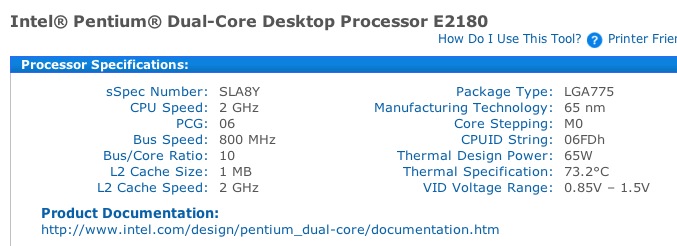

Goron Posted September 14, 2008 Share Posted September 14, 2008 Same "probs" as mentioned above, but besides of that working perfectly with: retail 10.5.4 E2180 on Asus P5K-E It shows up about 20 degrees more core temp than HardwareMonitor, so it figured out that my random crashes where due to thermal shutdowns *thumbup* Great tool !!!!! Link to comment Share on other sites More sharing options...
mitch_de Posted September 14, 2008 Share Posted September 14, 2008 Same "probs" as mentioned above, but besides of that working perfectly with: retail 10.5.4 E2180 on Asus P5K-E It shows up about 20 degrees more core temp than HardwareMonitor, so it figured out that my random crashes where due to thermal shutdowns *thumbup* Great tool !!!!! Core temp is (with newer cpus) not measured by "how much Celsius" call to the cpu. Its much more complicated and relative to individual TJMAX values. To get more real temps its really helpfull for SUPERHAI if you post here some information about your CPU. Some examles of these info is shown on the pages before. Most dont know how much TJMAX is and TJMAX depends also from the stepping (like L0,M1,... - means cpu die update version) of the cpu. yours, E2180 : http://processorfinder.intel.com/details.aspx?sSpec=SLA8Y TJMAX = 73,2 Celsius - SUPERHAI need this value I looked in the source of this beta ,kext. There are,until now not so many CPU types in (needed if ACPI didnt give CPU information). CPUTable cpu_tables[] = { { 0x6f6, false, false, 0x0933, 0x061b, 0xa, 100, 125, 7125 , "Core 2 Duo" }, { 0x6fd, true, false, 0x092b, 0x0613, 0xa, 100, 125, 7125 , "Core 2 Duo (Mobile)" }, { 0x10676, true, true, 0x0c22, 0x0611, 0xa, 105, 125, 7125 , "Core 2 Duo (Mobile)" }, // prelim { 0x10676, false, true, 0x0922, 0x0611, 0xa, 90, 125, 7125 , "Core 2 Duo" }, // prelim }; You can see yours, but is there called C2D Mobile, not Pentium Core Duo (yours is ID 6fd). TJMAX values of this small CPU list may not! be real, so temp may wrong. This happend if .kext cant get cpu information from ACPI. You can see which way is used (ACPI or those above/default values) by using the debug version. My E4400, ID 06f2 : GenericIntelCPUPowerManagement: Probing your system GenericIntelCPUPowerManagement: CPU is Intel GenericIntelCPUPowerManagement: Support for Enhanced Intel SpeedStep GenericIntelCPUPowerManagement: Thermal CPU adjustment factor available GenericIntelCPUPowerManagement: Thermal sensor available GenericIntelCPUPowerManagement: Found I/O Kit CPU's at address 6f28580 GenericIntelCPUPowerManagement: Found I/O Kit CPU at address 3781880 CPU number 0 with name CPU0 GenericIntelCPUPowerManagement: Found I/O Kit CPU at address 3781700 CPU number 1 with name CPU1 GenericIntelCPUPowerManagement: Intel Core 2 Duo (Mobile)/Quad (Mobile)/Extreme/Pentium Dual-Core/Xeon (6 0Fh) (65nm) GenericIntelCPUPowerManagement: CPU signature is 6f2 GenericIntelCPUPowerManagement: Thermal Junction Max is 100 C current temperature is 38 C Wrong, i must add my TJMAX 61,4 C in the source (ACPI CPI Info isnt working well enough with my GA-35 board) GenericIntelCPUPowerManagement: We have our device tree at 367f7c0 You will get TJMAX here (post it with all other information you can get) Be careful TJMAX may vary even same CPU type, same GHZ but other (newer/older) stepping. http://processorfinder.intel.com/details.aspx Link to comment Share on other sites More sharing options...
