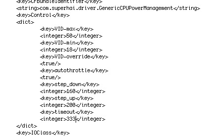

mitch_de Posted October 24, 2008 Share Posted October 24, 2008 There is settings under Control in Info.plist to change the throttle level control. It is step_up and step_down step_up 600 step_down 400 step_up is load in promille for when to jump to a faster state, step_down is to slower. They can have values from 151 to 849 and step_down must be lower than step_up. If you want it to throttle up at 30% load you set step_up to 300, and you can set step_down to like 200 or whatever suits you. You should not change the source, it is not necessary. I plan to have to profiles, connected with my ACPIBattery kext, one for battery and one for AC, but that is coming later. And I think 250 ms (not mS :-) ) is good timeout value. THANKS - very good that you now have made entries in the .plist. So both- desktop users which want only avoid highest MH on low cpu load (step_up to 151-200) and mobile users which want also avoid midrange MHZ on lower cpu load (step_up to 500-700). I also think 250 mS is good. Link to comment https://www.insanelymac.com/forum/topic/123774-new-version-11-of-genericcpupowermanagement/page/10/#findComment-942792 Share on other sites More sharing options...

Superhai Posted October 24, 2008 Author Share Posted October 24, 2008 THANKS - very good that you now have made entries in the .plist.So both- desktop users which want only avoid highest MH on low cpu load (step_up to 151-200) and mobile users which want also avoid midrange MHZ on lower cpu load (step_up to 500-700). I also think 250 mS is good. They have always been there, I just havent documented them. Yes I agree, I initially set the numbers for laptop uses, but I see many desktop users also like it. Link to comment https://www.insanelymac.com/forum/topic/123774-new-version-11-of-genericcpupowermanagement/page/10/#findComment-942812 Share on other sites More sharing options...
mitch_de Posted October 24, 2008 Share Posted October 24, 2008 They have always been there, I just havent documented them. Yes I agree, I initially set the numbers for laptop uses, but I see many desktop users also like it. i LOVE such eastereggs I changed it, and now ist for me very good (i rised the timer to 333 mS, fast enough, because much lower cpu load trotthes) With this combination my desktop system is very snappy - even more than if i only set time to very fast (150 mS) but default(higher) up/down. Thanks , all working now great !!! Link to comment https://www.insanelymac.com/forum/topic/123774-new-version-11-of-genericcpupowermanagement/page/10/#findComment-942826 Share on other sites More sharing options...
