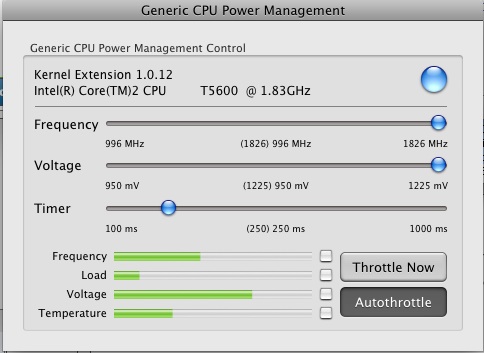

Xess666 Posted October 22, 2008 Share Posted October 22, 2008 This is my result on Asus A8JP Intel C2D T5600 @ 1.86Ghz GenericCPUPowerManagement: [Warning] No ACPI p-states in table GenericCPUPowerManagement: [Warning] No ACPI p-states in table GenericCPUPowerManagement: Generic CPU Power Management Driver 1.0 © 2008 Superhai Development Co, based on works by mercurysquad GenericCPUPowerManagement: For internal use only. All Rights Reserved. Support and documentaion http://www.superhai.com/ and on application Link to comment Share on other sites More sharing options...
mitch_de Posted October 22, 2008 Share Posted October 22, 2008 Could be your bios is throttling ... OK. no problem - dual throttling - cool Without joke - i dont think so - the bios may change VIDs but not clocks down. Thats only possible by speedstep - or if cpu temp is much, much to high (i have very low temps). Also with first versions of that .kext (or the early other .kext i forgot name of dev) , it stays as fixed clock if autothrottle was disabled. Can someon else test if clock stays fixed (as you set it by Throttle Now) if autothrottle is disabled ? Link to comment Share on other sites More sharing options...
titooo1 Posted October 22, 2008 Share Posted October 22, 2008 This is my result on Asus A8JP Intel C2D T5600 @ 1.86Ghz GenericCPUPowerManagement: [Warning] No ACPI p-states in table GenericCPUPowerManagement: [Warning] No ACPI p-states in table GenericCPUPowerManagement: Generic CPU Power Management Driver 1.0 © 2008 Superhai Development Co, based on works by mercurysquad GenericCPUPowerManagement: For internal use only. All Rights Reserved. Support and documentaion http://www.superhai.com/ and on application I got exactly same results on Asus F3JC Intel C2D T5500 at 1.66Ghz... I think it work, at least xbench give me lower results if I slow down the frequency, but I don't know why I get No ACPI p-states in table... Link to comment Share on other sites More sharing options...

mitch_de Posted October 22, 2008 Share Posted October 22, 2008 I got exactly same results on Asus F3JC Intel C2D T5500 at 1.66Ghz... I think it work, at least xbench give me lower results if I slow down the frequency, but I don't know why I get No ACPI p-states in table... This is because a lot of BIOS have some bugs in their ACPI Part of the bios. Also Linux has that problem, but have workarounds in the kernel for that. You cant do anything - perhaps later BIOS updates have it fixed (or other bugs new ) Use the overwrite_VID function (to YES) in the .plist. Link to comment Share on other sites More sharing options...

Superhai Posted October 22, 2008 Author Share Posted October 22, 2008 Intel Pentium M 1.73Ghz Ok, I have added support for that cpu. But it will need custom kernel, or it will be panicing on rtc_clock_stepping(). GenericCPUPowerManagement: [Warning] No ACPI p-states in table No need to worry much, the kext should be able to make proper values. Link to comment Share on other sites More sharing options...
