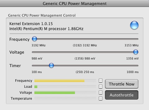

TmR Posted October 26, 2008 Share Posted October 26, 2008 Hi here is the Info of my Pentium M 750. "CPU Status" = {"Auto Throttle"=Yes,"Load"=0x190,"Temperature"=0x0,"High jump"=0x12c,"Voltage"=0x3dc,"Timer"=0xfa,"Low jump"=0x96,"Frequency"=0xc78,"Kext Timer"=0x246,"Kext Online"=Yes,"Current state"=0x3,"Voltage ID"=0x12,"Frequency ID"=0x6} "CPU Init" = {"CTL max"=0xe29,"FSB frequency min"=0x850,"Signature"=0x6d8,"FSB frequency max"=0x850,"CTL min"=0x612,"Kext unlock"=No,"Kext version"=0x1000f,"Brand string"="Intel® Pentium® M processor 1.86GHz","Voltage max"=0x54c,"Frequency min"=0xc78,"Frequency max"=0xc51,"Voltage min"=0x3dc} Showing wrong Frequency Link to comment https://www.insanelymac.com/forum/topic/123774-new-version-11-of-genericcpupowermanagement/page/11/#findComment-944379 Share on other sites More sharing options...

Superhai Posted October 26, 2008 Author Share Posted October 26, 2008 Hi here is the Info of my Pentium M 750. Showing wrong Frequency What is your fsb frequency? 133? And what is showing in system profiler? And no AMD users who wants to be beta tester? Link to comment https://www.insanelymac.com/forum/topic/123774-new-version-11-of-genericcpupowermanagement/page/11/#findComment-944987 Share on other sites More sharing options...

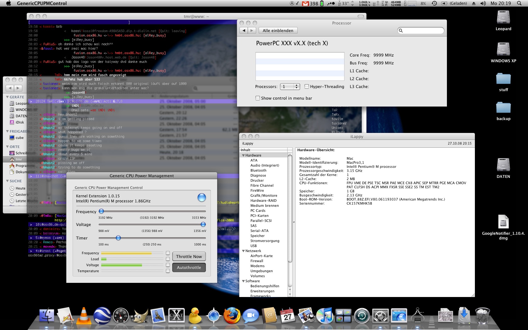

TmR Posted October 27, 2008 Share Posted October 27, 2008 What is your fsb frequency? 133? And what is showing in system profiler? Yes my fsb frequency is 133. Uh System-profiler showing 3.15Ghz.My ram recognised wrong too in System-Profiler 667 but it's 533. I've added a CPU-Z dump. cpuz.txt Link to comment https://www.insanelymac.com/forum/topic/123774-new-version-11-of-genericcpupowermanagement/page/11/#findComment-945979 Share on other sites More sharing options...
Superhai Posted October 27, 2008 Author Share Posted October 27, 2008 Yes my fsb frequency is 133. Uh System-profiler showing 3.15Ghz.My ram recognised wrong too in System-Profiler 667 but it's 533. The kext depends on correct fsb frequency, on your system the fsb seem to be 4 times higher than what it is supposed to be. Link to comment https://www.insanelymac.com/forum/topic/123774-new-version-11-of-genericcpupowermanagement/page/11/#findComment-946012 Share on other sites More sharing options...
