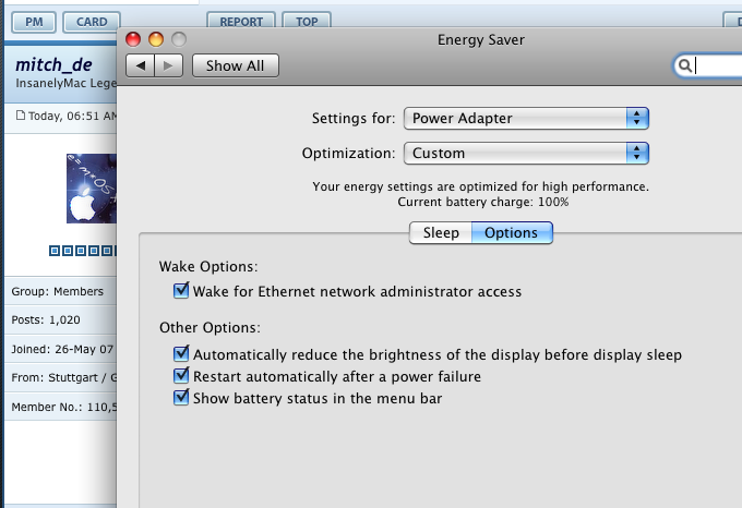

PGHammer Posted May 30, 2009 Share Posted May 30, 2009 This option depends on AppleLPC.kext. It must be loaded. I have origin powermanagement.bundle from 10.5.7. It works with AppleACPIBatteryManager.kext.(Dell Inspiron). My GA board is 965P (ICH8) while you have EP-35 (ICH9?). As I know ICH9 have no support by original IOUSBFamily or supported with mistakes. It is better to use my version. Strangeness begets strangeness. It's a case of GNBN at this point. BN: Your two new kexts (IOPCIFamily and IOUSBFamily)m still don't fix the rather ugly interrupt problem (ASUS P5N-EM HDMI, nForce 7100/630i chipset), as the onboard USB ports still don't show in System Profiles, and dmesg (for those ports) gives me the following (in Terminal): USBF: 79.698 AppleUSBOHCI[0x2ddd000]::UIMInitialize unable to get filterInterruptEventSource USBF: 79.702 AppleUSBOHCI: unable to initialize UIM USBF: 84.711 AppleUSBOHCI[0x2dfc800]::UIMInitialize unable to get filterInterruptEventSource USBF: 84.715 AppleUSBOHCI: unable to initialize UIM GN: However, a Belkin PCI high-speed USB 2.0 card (four ports for external devices, and one for internal devices), works out of the box; I've moved the USB devices that aren't working (basically everything except, oddly enough, a Microsoft USB WheelMouse Optical, which despite NOT showing in System Profiler, works just fine, even with a PS/2 mouse also connected). I have a USB 2.0 wireless-G adapter that I use in Windows and Linux (SMC); however, I have no idea if there is a Leopard driver for it to test with. I wish I knew what was causing the error messages for the built-in USB ports, though. Link to comment https://www.insanelymac.com/forum/topic/117029-usb-20-for-leopard-1057/page/14/#findComment-1166118 Share on other sites More sharing options...
