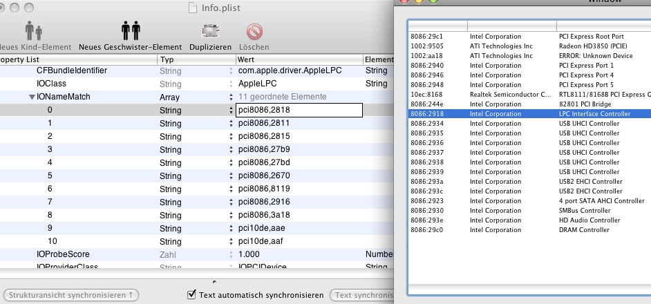

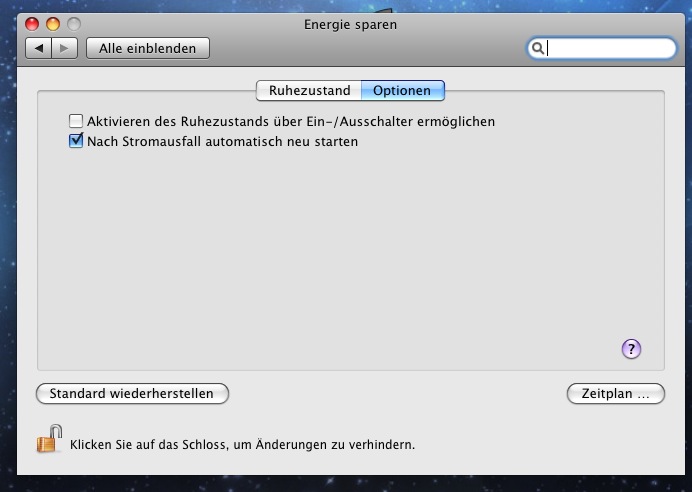

mitch_de Posted May 29, 2009 Share Posted May 29, 2009 Thanks Slice, for the updated IOPCI.kext. I remember that that not only can solve USB problems also has fixed/opzimized Interrupt handling for hackintoshs. My problem is a bit different. I dont have (EP-35-DS3) USB Problems. But i cant sleep, it reboots insted. I solved this by an HINT somewhere in the forum to enable an Option "Automatic Restart On Power Loss" in the energy saver prefpane. But that option is gone with 10.5.7, only shown that option with the power button. I also remember, in that hint thread, that some others didnt have that option to enable that. Now i also (upgraded to 10.5.7) dont have that option anymore. I know you have an similar GA Board. Do you have that option ? Can it be some changed support files (system/library/Systemconfiguration/powermanagement.bundle) of the powermanagement part of OS X 10.5.7 ? I can see that "Automatic Restart On Power Loss" in the .plist there, so perhaps this .bundle handles that. Thanks Link to comment https://www.insanelymac.com/forum/topic/117029-usb-20-for-leopard-1057/page/13/#findComment-1165517 Share on other sites More sharing options...
Slice Posted May 29, 2009 Author Share Posted May 29, 2009 My problem is a bit different. I dont have (EP-35-DS3) USB Problems.But i cant sleep, it reboots insted. I solved this by an HINT somewhere in the forum to enable an Option "Automatic Restart On Power Loss" in the energy saver prefpane. But that option is gone with 10.5.7, only shown that option with the power button. I also remember, in that hint thread, that some others didnt have that option to enable that. Now i also (upgraded to 10.5.7) dont have that option anymore. I know you have an similar GA Board. Do you have that option ? Can it be some changed support files (system/library/Systemconfiguration/powermanagement.bundle) of the powermanagement part of OS X 10.5.7 ? I can see that "Automatic Restart On Power Loss" in the .plist there, so perhaps this .bundle handles that. Thanks This option depends on AppleLPC.kext. It must be loaded. I have origin powermanagement.bundle from 10.5.7. It works with AppleACPIBatteryManager.kext.(Dell Inspiron). My GA board is 965P (ICH8) while you have EP-35 (ICH9?). As I know ICH9 have no support by original IOUSBFamily or supported with mistakes. It is better to use my version. Link to comment https://www.insanelymac.com/forum/topic/117029-usb-20-for-leopard-1057/page/13/#findComment-1165556 Share on other sites More sharing options...
nicescr123 Posted May 29, 2009 Share Posted May 29, 2009 Roport: The state that appear as PCI and Value 0x0 of Errata in ioreg is fixed by your new KEXT. My problem... Shutdown and reboot when sleep is no solution. There may be those problems in different factors. Anyway, It is good that factors to disturb sleep decrease. On the other hand, I try zhell's DSDT method and Master Chief's EFI strings method. UHCI's state fixed in ioreg. EHCI Device is lost and USB Mouse is lost after replugging.... and I get this error. localhost kernel[0]: USBF: 0.605 EHCI controller unable to take control from BIOS localhost kernel[0]: USBF: 0.605 AppleUSBEHCI[0xad81800]: unable to obtain ownership: 0xe00002be localhost kernel[0]: USBF: 0.605 AppleUSBEHCI[0xad81800]::UIMInitialize - Error occurred (0xe00002be) localhost kernel[0]: USBF: 0.607 AppleUSBEHCI: unable to initialize UIM localhost kernel[0]: USBF: 0.620 AppleUSBEHCI[0xae48000]: unable to obtain ownership: 0xe00002be localhost kernel[0]: USBF: 0.623 AppleUSBEHCI[0xae48000]::UIMInitialize - Error occurred (0xe00002be) localhost kernel[0]: USBF: 0.629 AppleUSBEHCI: unable to initialize UIM Slice's KEXT is necessary for my USB problem. Thanks all & Sorry for my BAD English. If you use Chameleon, add <key>USBBusFix<key><string>Yes<string> to the com.apple.Boot.plist Link to comment https://www.insanelymac.com/forum/topic/117029-usb-20-for-leopard-1057/page/13/#findComment-1165558 Share on other sites More sharing options...
mitch_de Posted May 30, 2009 Share Posted May 30, 2009 This option depends on AppleLPC.kext. It must be loaded. I have origin powermanagement.bundle from 10.5.7. It works with AppleACPIBatteryManager.kext.(Dell Inspiron). My GA board is 965P (ICH8) while you have EP-35 (ICH9?). As I know ICH9 have no support by original IOUSBFamily or supported with mistakes. It is better to use my version. Thanks ! Now i remember that i had added some dev-id of my ICH9 into the AppleLPC.kext in the past. So that explains why some can see that energy saver pref and some not (non ICH9R, non ICH10,..). I can see (kextstat) that the LPC isnt loaded. I will try to add ICH9 again into that .kext and report back. Link to comment https://www.insanelymac.com/forum/topic/117029-usb-20-for-leopard-1057/page/13/#findComment-1165869 Share on other sites More sharing options...
rx782p Posted May 30, 2009 Share Posted May 30, 2009 Only EHCI was fixed by USBBusFIX=Yes when using vanilla IOUSBFamiry.kext. Link to comment https://www.insanelymac.com/forum/topic/117029-usb-20-for-leopard-1057/page/13/#findComment-1165956 Share on other sites More sharing options...
mitch_de Posted May 30, 2009 Share Posted May 30, 2009 This option depends on AppleLPC.kext. It must be loaded. I have origin powermanagement.bundle from 10.5.7. It works with AppleACPIBatteryManager.kext.(Dell Inspiron). My GA board is 965P (ICH8) while you have EP-35 (ICH9?). As I know ICH9 have no support by original IOUSBFamily or supported with mistakes. It is better to use my version. I added that INTEL LPC dev ID (2918, for ICH9 LPC - that ID wasnt in yet > no loading that kext) to the others in that kext. The shown screenshoot shows that adding (not ready edited for 2918!!). I hope i will be back next boot EDIT: I am back Yep : now sleep works again , AppleLPC.kext now loaded (i must once boot with -x) ! I can now set that option in the energie saver (wasnt shown before). Link to comment https://www.insanelymac.com/forum/topic/117029-usb-20-for-leopard-1057/page/13/#findComment-1166012 Share on other sites More sharing options...
