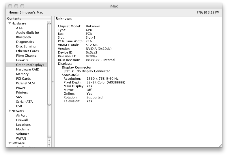

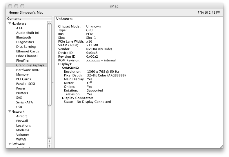

iJonlive Posted July 10, 2010 Share Posted July 10, 2010 Removing old EFI strings?, Please help! Okay, so I have a snow leopard install, and I had a nVidia 8800GT, and it worked great. I used EFI studio to install the EFI strings for it, and it worked well. I've now upgraded to a nVidia GTS 250. I've tried installing EFI strings for it countless times, but in system profiler it still shows the 8800GT. Is there any solution to this? I would really rather not have to reinstall unless that's the only way. Thanks for reading. Link to comment https://www.insanelymac.com/forum/topic/113489-geforce-200-series-support/page/24/#findComment-1508140 Share on other sites More sharing options...
