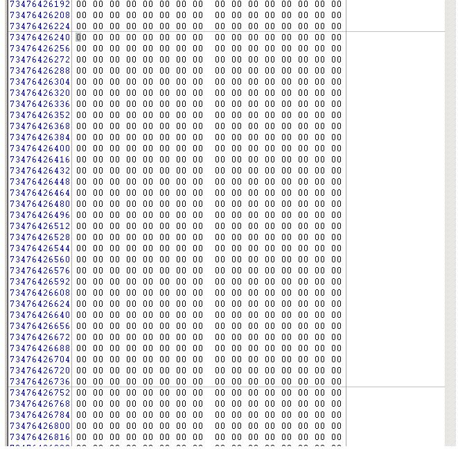

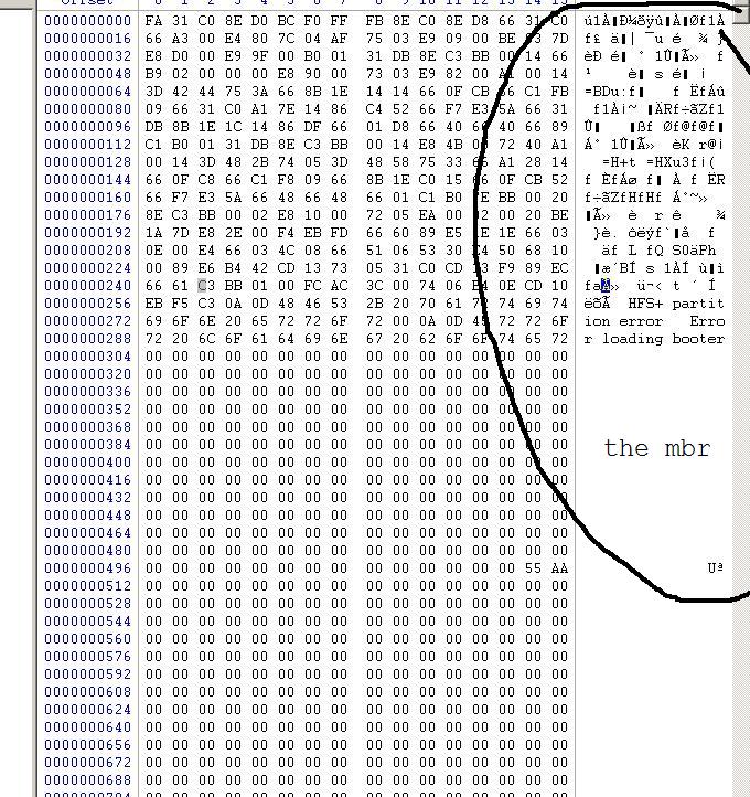

j.vimal Posted May 25, 2006 Share Posted May 25, 2006 cool, number 25. umm...what's the actual reason i created the partition as a logical first? The thing is: When Mac is installed on a Primary Partition, it does NOT write a bootsector!! So, when you run Chain0, which does nothing but scans your partition table and boots the partition with the signature AF, it hangs and says: Chain Booting error, since there is nothing to execute! Lol! But, when it is installed onto a logical partition, it writes an MBR. And this MBR is preserved when you convert it into Primary using Acronis. Thats the solution Now chain0 peacefully works. Cheers Thanks for the nice guide Link to comment https://www.insanelymac.com/forum/topic/11339-howto-xp-osx-1044-1048-native-dual-boot/page/11/#findComment-119395 Share on other sites More sharing options...
