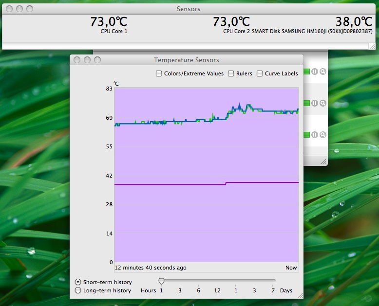

Hello,
I've read this thread from A to Z. I was having system freezes and hard shutdowns immediately when I first turn on the computer.
This thread helped me get Coolbook reading my temperature, thanx to the kexts posted here: http://forum.insanelymac.com/index.php?act...st&id=29068
The problem is that on cold boot, I immediately get 100 degrees temp in coolbook, and the system shuts down ultimately if I don't restart it. restarting it gets me 72C temps, with or without coolbook.
The plugging-unplugging did not work for me.
I downloaded istat but it didnt give me at all the temp, and fans, readings no matter what I did.
I think the only solution left for me is to try the AppleIntelCPUPowerManagement, because I don't see any other solution I have except removing the hack, as it is dangerously warming my system. The 72C I get are from an idle system, if I open Safari or anything else, I reach 80C easily.
Any help is appreciated, and if any files, are needed from my part I will gladly supply them, but bear with me, as I'm new to all this.

I've been reading and reading and readin. and I'll start to post my kextstat:
   18   10 0x2e02e000 0x4000	 0x3000	 com.apple.iokit.IOACPIFamily (1.2.0) <12>
  19	4 0x2e07d000 0x3d000	0x3c000	com.apple.driver.AppleACPIPlatform (1.2.1) <18 17 12 7 5 4>
  27	0 0x33f37000 0x4000	 0x3000	 com.apple.driver.AppleACPIButtons (1.2.1) <21 19 18 7 6 5 4 2>
  32	0 0x34132000 0x5000	 0x4000	 com.apple.driver.AppleACPIEC (1.2.1) <31 19 18 12>
  33	0 0x341e0000 0x2000	 0x1000	 org.tgwbd.driver.ACPIPS2Nub (1.0.0d1) <19 18 12>
  39	0 0x3452d000 0x3000	 0x2000	 com.apple.driver.AppleACPIPCI (1.2.1) <19 18 17 12>
  75	0 0x343c9000 0xc000	 0xb000	 com.apple.driver.ACPI_SMC_PlatformPlugin (3.1.6d0) <74 73 18 17 12 7 6 5 4>
  92	0 0x34921000 0x5000	 0x4000	 com.OSx86Project.kext.ACPICPUThrottle (1.0.2) <12 5 4 2>
Now here's the story. the forst 24h after install of iATKOS the system was running fine. 49 degrees celcius and that's very ok for me. Then the laptop was turned off for several hours and when I cold boot it then the temperature keeps climbing. and climbing up to 70 degrees celcius idle, but when I start something consuming like java the temperature climbs even more.
Now the questions. What can I do. As I've read the 10 pages of this post, there are several things I could start to, but don't know where to start and don't want to break my system. So please link directly to the posts, with instructions... And I'll get back.
Just one more thing, the fans don't cool my system after a reboot when hot, They just turn on before the darwin and got idle(slow) after that.

Coolbook gave me temps of 70C average, I didnt think it cooled my Toshiba, it just gave me the temperatures. As far as i remember, the one thing it did is that I didnt have the high temperatures on cold boot, other than that nothing important.
I've ow tried with iatkos and jas, latest versions... All HOT... Tried with both speedstep kernels and vanilla and XNU, The last 2 didn't work at all. I've tried to add thermal fix on both installations and tried without... Still running HOT... So right now I'm putting my dreams of running Leo an my lappy on the shelf... Just installed ubuntu and modded it to the max so it almost looks like a real Leo desktop... Hope that all you guys can solve these issues someday and yes I'll be back and I'll be participationg in this forum more...
Now I'm subscribing to this thred and hope that it someday comes up with a fix.
