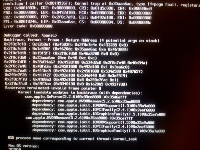

eddie11c Posted April 24, 2008 Share Posted April 24, 2008 ah ok well that one less thing to worry about... iv tried alsorts. iv removed everything from the pc's slots only leaving in the monitor cable, iv disabled ethernet. tried via sata, which my xp partiton is on, tried a IDE hdd on it own. nothing. Maybe just maybe it dont wonna run on my system... Might have to retire as its pissing me off... lol Do me a favor post your chipest/processor/video card. Then boot with this bootflag(F8) debug=0x00000102 io=0x00200004 It will post alot of information about each kext that is loaded. Usually the last one you see when it gets stuck is the cause. Just post the last couple of lines when it freezes. Link to comment Share on other sites More sharing options...
niffer022 Posted April 24, 2008 Share Posted April 24, 2008 Do me a favor post your chipest/processor/video card. Then boot with this bootflag(F8) debug=0x00000102 io=0x00200004It will post alot of information about each kext that is loaded. Usually the last one you see when it gets stuck is the cause. Just post the last couple of lines when it freezes.Iv attached a file saved from cpuz that should tell you pretty much what u need to know about my cpu and chipset. my gfx card is a Galaxy 8600gt 256mb. ill report back in 2 mins is this what you needed to see. sorry if its poor quality taken of my phone..cpuz.htm Link to comment Share on other sites More sharing options...
eddie11c Posted April 24, 2008 Share Posted April 24, 2008 Do this. Boot into single user mode with -s from Darwin. /sbin/fsck -fy /sbin/mount -uw / ./options choose remove video choose Nvidia type exit and see what happens. Link to comment Share on other sites More sharing options...
