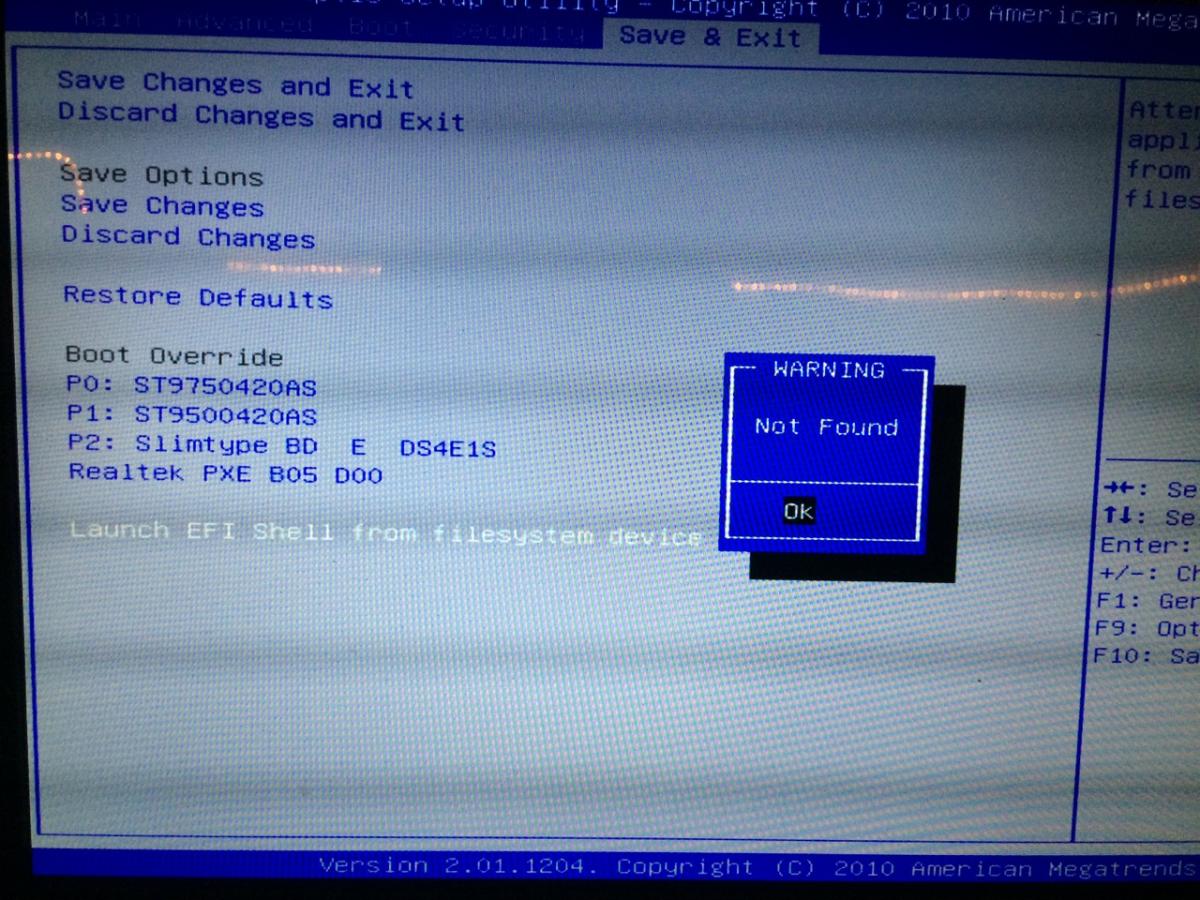

I have an Asus Laptop G74Sx that I thought the Bios/Motherboard was UEFI but Clover will only boot with legacy install boot0af, will not boot for UEFI booting only option.   The bios has enable/disable UEFI boot as a setting but i'm guessing that does not mean its a UEFI bios? How can I troubleshoot to see why it will not boot UEFI?  Right now I have dual boot legacy/UEFI since I am swapping out my SSD Drive between two devices for testing purposes.
Is there a UEFI option when you use your system's boot selection key (<ESC> key for ASUS machines)?
Are you able to boot and install Windows in UEFI mode?
If yes, you can try using EasyUEFI to set CloverX64.efi as first priority in your system's UEFI boot menu (guide here).
Windows HD removed for now.   When I hit ESC I do not see UEFI but if I place a flash drive with a windows UEFI installer and hit ESC I see Kingston regular and EFI both!!

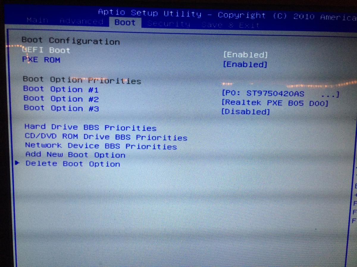

Maybe I did something to Bios when I used the Aptio tools to enable hidden menus specifically CPU CFG lock/unlock.
See Attached Bios screenshots.  I'll give EasyUEFI a try on a USB flash drive.

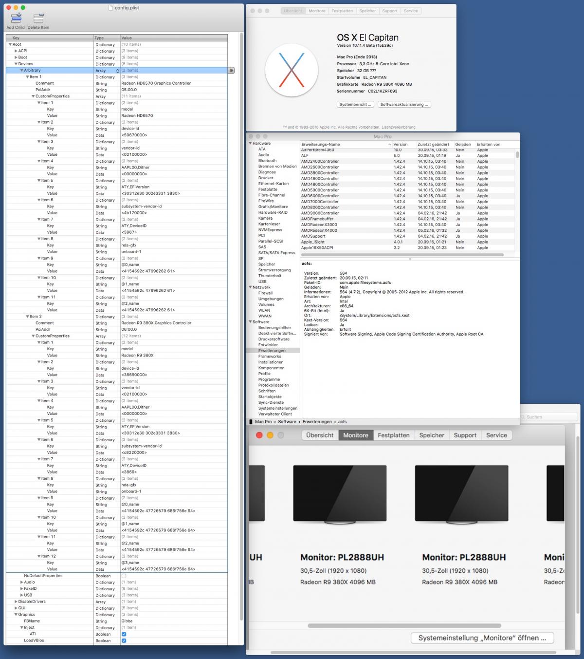

Finaly i did it! These are my Settings for 2 different RADEON GFX-Cards with different FrameBuffers via "Arbitrary"-Key under "Devices":
Radeon HD6570 runs with FB "Gibba" while R9 380X runs with FB "Greyhound". Full QE and Accelleration.
Connected are actually 3 Monitors: 4k Iilyama DP and Samsung 48" TV HDMI via R9 380X and same 4k Iilyama HDMI via HD6570
HD6570 in PCI-Slot#1 (primary Boot-GFX), Radeon R9 380X in PCI-Slot#3
Thanx for the hint to "Arbitrary" Key...  ;-)
