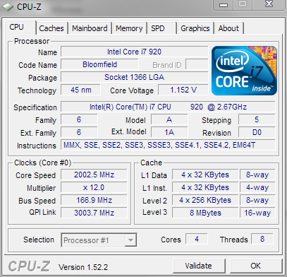

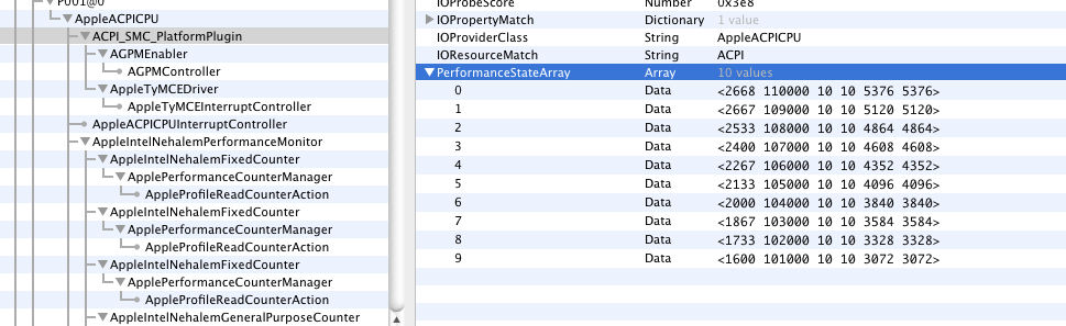

I have an i7 oc'ed to 3.5 GHz. Model identifier is set to MacPro 4,1.
I get this in the ACPI_SMC_Plugin

MSR tools running under 32bit 10.6 tells me the CPU runs at 3.5GHz. What is surprising is that idle temps are 44c ~ 45c. Granted I have a TRUE-120, but shouldn't they be higher ? I get temps of 43c ~ 44c under Windows, so not much of a difference. And my Windows idle is at 2000 MHz ( 12x mult )
So what's going on ? Does OSX idle at 3.5 GHz so efficiently that the temps are comparable to 2.0 GHz ? And do I have to replace the P-State array and create new C-states for the 3.5 GHz overclock ?

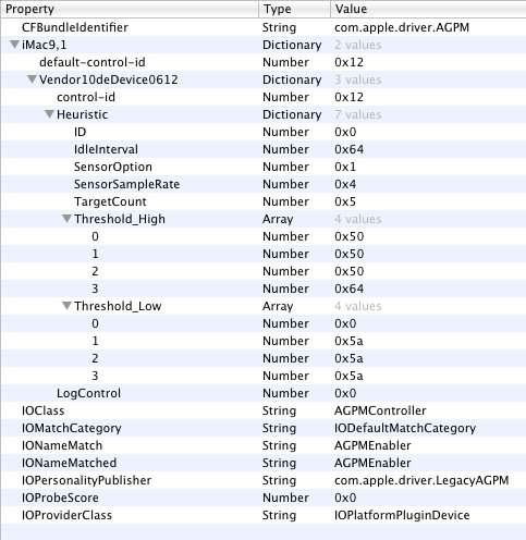

The reason I got this error was because my model identifier is set to P5K PRO and thus there's nothing in AppleGraphicsPowerMangement.kext to match with. Enter a quick and dirty LegacyAGPM.kext (see attachments). Now my NVIDIA 9600GT (10de:0622) is recognized, and thus no more error.
That's pretty cool, thanks!
I deleted the two other Nvidia IDs in the kext, and changed yours to 0612 to match my 9800GTX+ and it loads.
This ought to be more compatible than having my 9800GTX+ identified as an IGP (I use iMac9,1 for model identifier).
Do you know what the "control-id" corresponds to? GPU class/family?
And the thresholds, are they degrees centigrade or a percentage of something?
Well you have rev D0 on CPU, that is known as cooler then C0/C1.
Anyway I don't know how much trust you can have on MSRTools on temps...
There is a better tool for reading temps and fans Mark-i be aware that thread is in rusian and for snow only :P
If your sensor chip is Winbond W83667HG(check with Lavalys Everest) it should work with it.
IGP is the Internal Graphics Processor and is controlled by iGPUThrottle. This setting can be found under ControlArray (Item 21 for iMac9,1) and is set to True. Making it a little too dangerous for my taste. At least for now without really knowing what it does. We need additional info/data.
You can find the following items under ControlArray in ACPI_SMC_PlatformPlugin:
10 = CPU_PLIMIT
11 = GPU_PLIMIT
12 = MEM_PLIMIT
13 = CPU_STATE
14 = GPU_STATE
15 = IDLE_LIMIT
16 = GPU_RANGE_CONTROL_INTERNAL
17 = GPU_RANGE_CONTROL_EXTERNAL
18 = GPU_RANGE_CONTROL_PCI
Take a look at ValidConfigs under GPU_RANGE_CONTROL_PCI which is set to 18/0x12 (MacPro4,1). That is also why is doesn't really work for you with iMac9,1 set as model identifier.
Load percentage (0x64 is 100).
