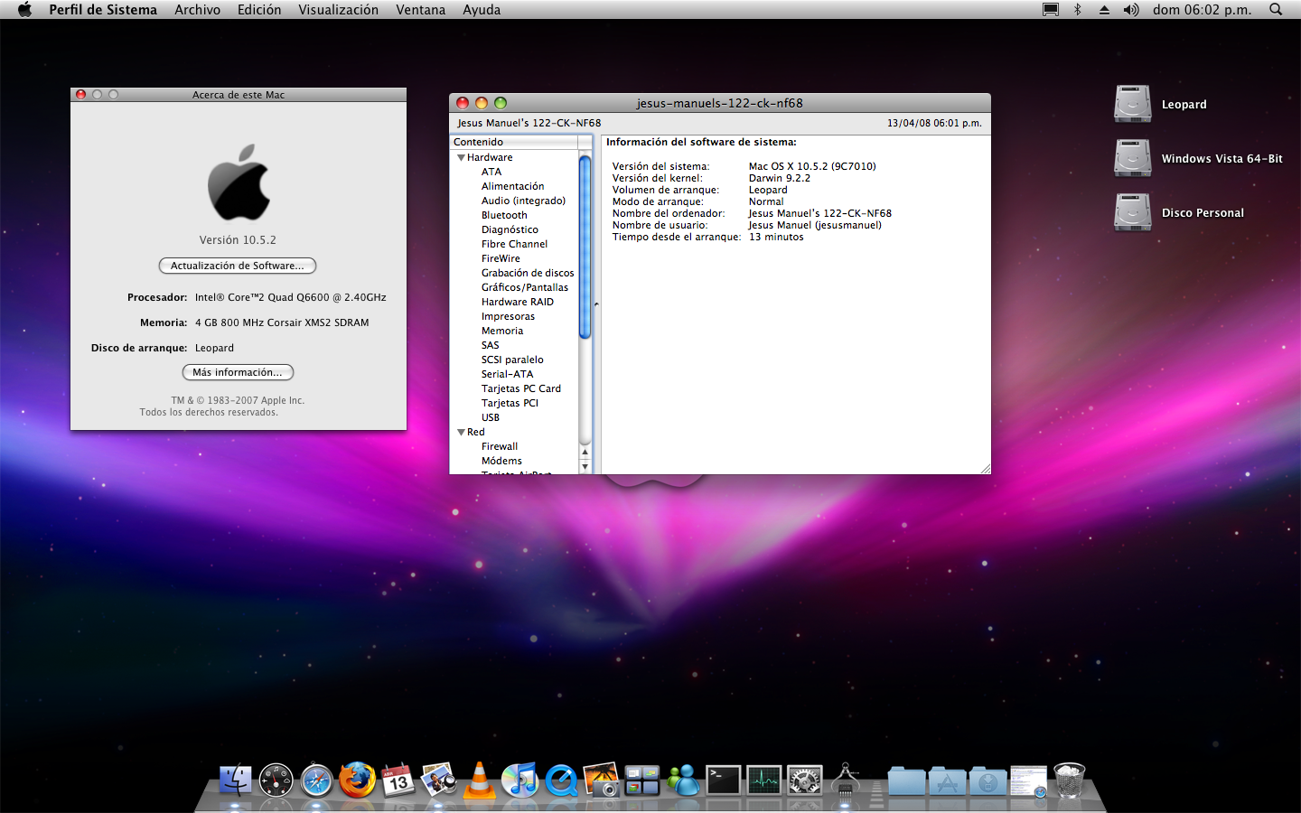

Ironjer Posted April 14, 2008 Share Posted April 14, 2008 Hey kaly thanks man!! Working on my EVGA 680i and Q6600 Installed on HD 80GB SATA2!!! Summary Kernel Activity: KabylKernel (Doesn't Works Reboot) nForceKernel (Works 4 Cores, No USB) SleepKernel (Works 4 Cores, No USB) VanillaKernel (Doesn't Works Reboot) MdbinKernel (Works with cpus=1 flag, USB Working too, this is the more stable for me) SpeedStepKernel (Works 4 Cores, No USB) Link to comment Share on other sites More sharing options...
