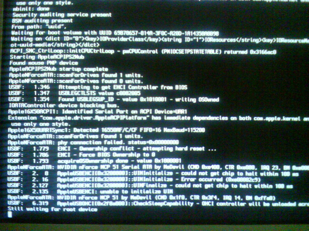

sysguru Posted March 10, 2008 Share Posted March 10, 2008 hi... again i disappointed with this dvd... new type of error's coming ... first i got "EHCI Root simulation" error... i fixed with changing ide(dvd ) drive to primary slave... then i tried boot dvd.... i got new error.... OHCI_controller _ bala bala.. chek out screen shot for more... my sys config AMD 3200+ Asus a8n vm Graphics Chip set MB 1 gb RAM 120 gb Sata Sony DVD rw PS/2 keb/mouse install info 120 GB sata installed in second sata slot / dvd drive ide connect in primary salve plz.. help me to install mac os... i have plan to buy new HDD drive for mac.... i am bit confused IDE or SATA which one suits for my pC so help me... in right way.... thanks in advance thanks Link to comment Share on other sites More sharing options...
