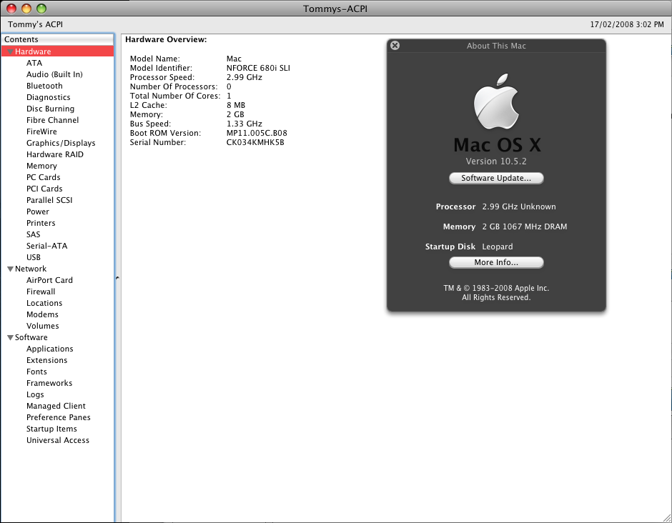

muitommy Posted February 17, 2008 Share Posted February 17, 2008 your ver. is quite good, i can show my mobo's model correctly, whereas netkas' give me macrpro ... btw, are there any hope for nforce mobo to fix that unknown??? Link to comment https://www.insanelymac.com/forum/topic/88087-fully-working-1052-applesmbios-and-source-finally-available/#findComment-628233 Share on other sites More sharing options...

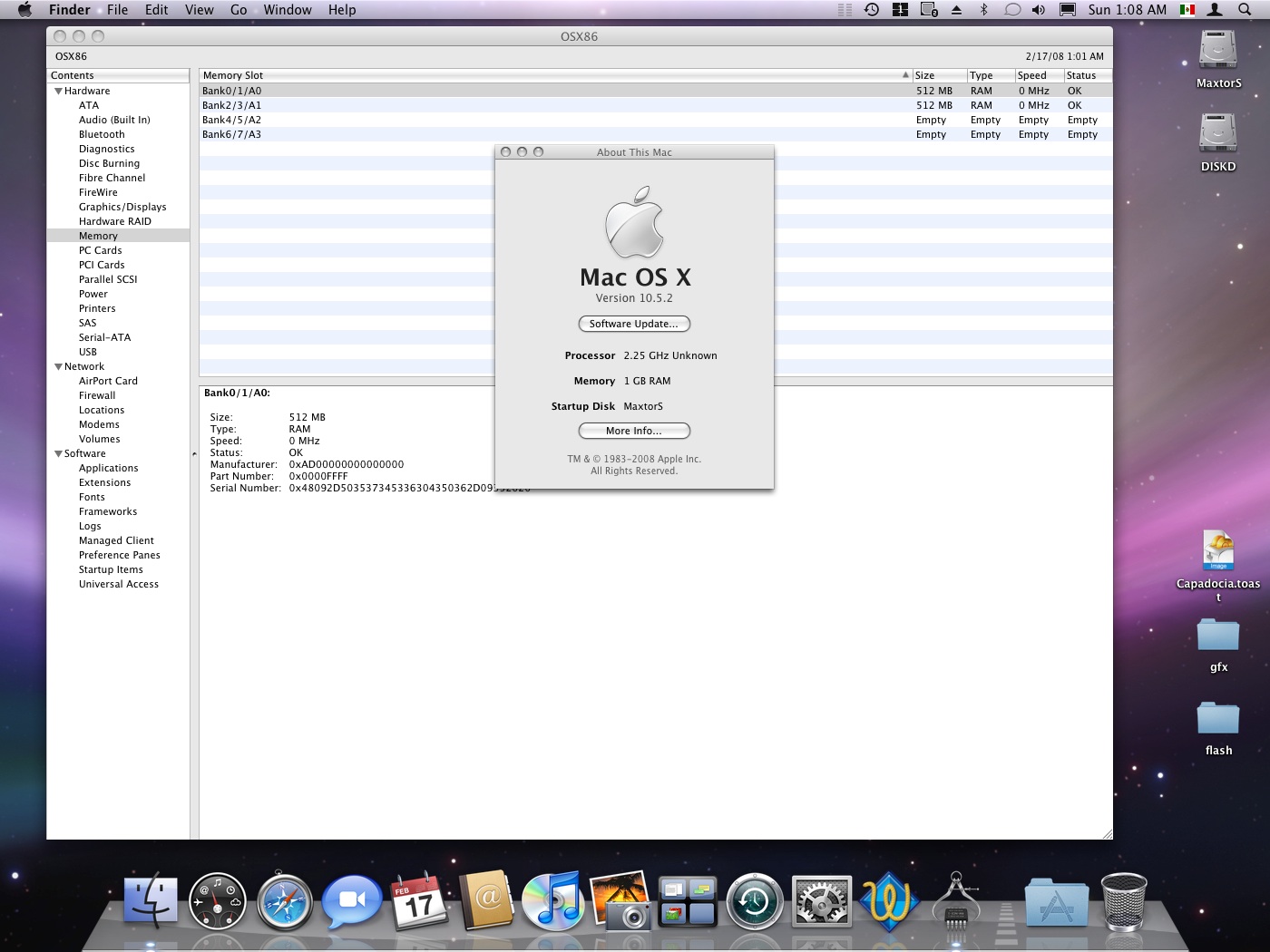

macgirl Posted February 17, 2008 Share Posted February 17, 2008 mac.nub With you AppleSMBIOS I get error reading the memory speed, see: Link to comment https://www.insanelymac.com/forum/topic/88087-fully-working-1052-applesmbios-and-source-finally-available/#findComment-628248 Share on other sites More sharing options...

mac.nub Posted February 17, 2008 Author Share Posted February 17, 2008 mac.nub With you AppleSMBIOS I get error reading the memory speed Unfortunately AppleSMBIOS can not detect all memory speeds correctly, this has always been a problem for me with my PC and I am going to release various versions of AppleSMBIOS with memory speeds hardcoded, either that or look into some kind of detection routine. I see your memory values and mine are the same, is it just a fixed value that you entered? Manufacturer, Part Number and Serial Number have all been hardcoded from real Apple RAM, as this is needed for it to function correctly. 16/02/08 09:35:40 p.m. DVD Player[293] CFPropertyListCreateFromXMLData(): Old-style plist parser: missing semicolon in dictionary. 16/02/08 09:35:41 p.m. [0x0-0x19019].com.apple.DVDPlayer[293] error: Error getting a reference to /options. 16/02/08 09:35:41 p.m. com.apple.launchd[170] ([0x0-0x19019].com.apple.DVDPlayer[293]) Exited with exit code: 1 This is not new, this problem exists with current netka's and vanilla AppleSMBIOS.kext. But with 1.0.11 (ToH's I think) it works fine. Would you take a look at this if you have some spare time? Will fix that ASAP - Edit: Just tried it on my laptop and it works fine, must be something that only occurs on some systems. Will add fix anyway. netkas' has always made loginwindow crash on my Celeron box when trying to open About This Mac. Think you could whip up an SMBIOS that keeps loginwindow alive while ATM is open? I'm not quite sure what you're asking there, drop me an email via my site and i'll look into it for you. Works well on mine. Unlike your previous Applesmbios, memory is recognize as DDR and not DDR2. Thanks! I may be wrong but it seems to be a Dell specific issue because it does that on my Dell laptop too. I'll make a release with DDR2 hardcoded for Dells. U made memory info wrong way.see. first my dump has hex values, second , same in strings | "dimm-manufacturer" = <4d616e75666163747572657230004d616e7566616374757265723100> | "dimm-serial-number" = <5365724e756d30005365724e756d3100> | "dimm-part-number" = <506172744e756d3000506172744e756d3100> | "dimm-manufacturer" = <"Manufacturer0","Manufacturer1"> | "dimm-serial-number" = <"SerNum0","SerNum1"> | "dimm-part-number" = <"PartNum0","PartNum1"> see ? i guess u set values as char * ohaivalue = "0xdeadface"; 1) I didn't do it that way. 2) It is shown exactly the way it is on a real Mac (as shown in IOReg Device Tree dump), so there's nothing wrong with it at all. I'll get on with fixing all the above issues ASAP - probably while I wait for Windows to re-install on my PC this afternoon. Edit: Actually, i'll do it now. Cheers, ~mac.nub Link to comment https://www.insanelymac.com/forum/topic/88087-fully-working-1052-applesmbios-and-source-finally-available/#findComment-628603 Share on other sites More sharing options...
