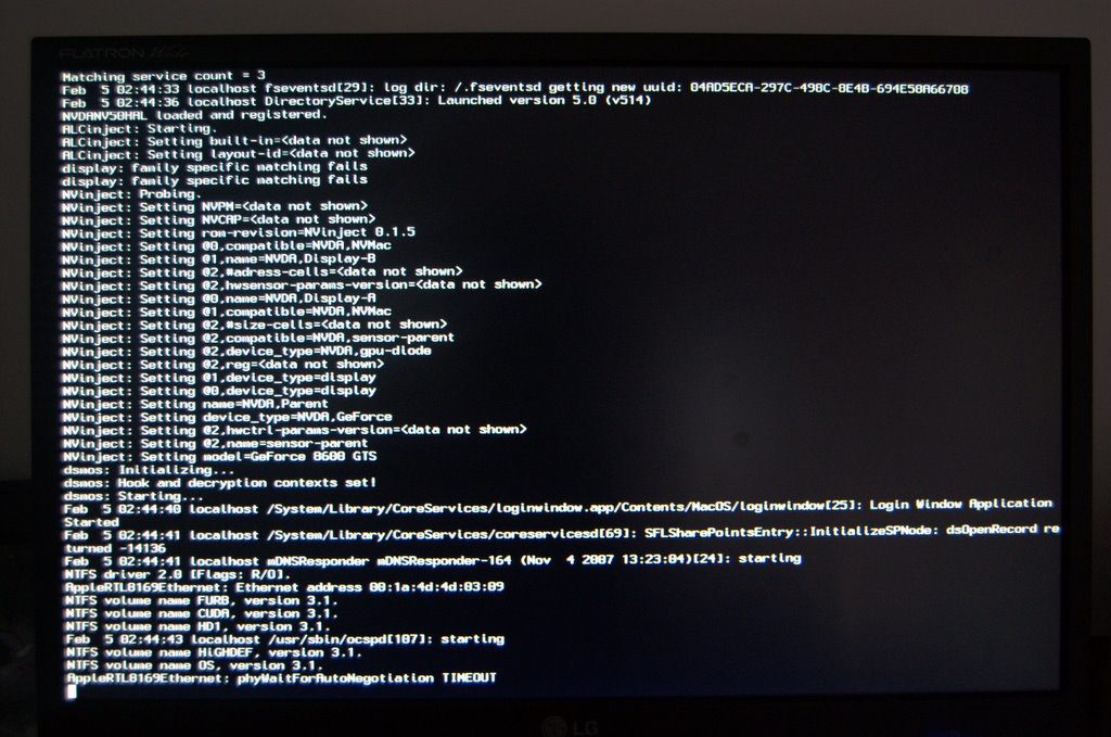

LilGator Posted February 5, 2008 Share Posted February 5, 2008 Having a problem loading Leopard for the first time after install. I have a DS3L, E2160, 2GB, GeForce 8600GTS and two 7200.10 500GB's (among others, but these are unformatted and intended for OSX86). I have disabled all CPU thermal management in BIOS (2 places that I saw), SATA to native, and unplugged my ethernet cable. I'm actually using an IDE drive, but it is the same as the recommended on in the original post, just not the SATA version (LH-20A1H). I would assume if this was a problem, it wouldn't have loaded the DVD and installed to begin with. I did a fresh install and formatted the partition as GUID, and also selected GUID under customize. I have also tried the opposite, with MBR formatting and MBR selected under customize before install. In both cases booting the partition was no problem, but it would always freeze while loading (spinner on load screen stops indefinitely). Here are the results where it hangs with -V. (I left it like this overnight, it didn't do a thing- so it's not a lack of patience ) Under Customize I selected both options for Vanilla Kernel, the sound option for DS3, and NVInject for desktop GeForce, as well as GUID or MBR according to how I formatted. Any ideas? Only thing I haven't tried is AHCI, as my drives I intend to install to won't be visible. Also, should I try a different video card driver, or none? Link to comment https://www.insanelymac.com/forum/topic/83689-how-to-install-on-gigabyteasuscompatible-boards/page/8/#findComment-609816 Share on other sites More sharing options...
LilGator Posted February 5, 2008 Share Posted February 5, 2008 After checking a few things out, I realized my IDE DVD drive is slave to another IDE HD. I took the HD off the cable, and made the IDE DVD drive the master. I also switched the two 500GB 7200.10's to the first 2 SATA ports and changed to AHCI. I also had forgetton to disable CPU Enhanced Halt in addition to the other two, that is disabled now. Third try, I'll let you know what happens... EDIT: Same deal as screenshot above. Trying no video driver now... EDIT2: Success with no video driver installed. Trying NVInject V.31. LAN so far does not work, it shows as cable unplugged (with it physically plugged in of course). Link to comment https://www.insanelymac.com/forum/topic/83689-how-to-install-on-gigabyteasuscompatible-boards/page/8/#findComment-609922 Share on other sites More sharing options...
dci693 Posted February 5, 2008 Share Posted February 5, 2008 EDIT2: Success with no video driver installed. Trying NVInject V.31. LAN so far does not work, it shows as cable unplugged (with it physically plugged in of course).Try enabling the Onboard LAN Boot ROM to see if that does anything for your LAN connection. Once I enabled that BIOS feature, my LAN connection started working in OSX. Link to comment https://www.insanelymac.com/forum/topic/83689-how-to-install-on-gigabyteasuscompatible-boards/page/8/#findComment-610126 Share on other sites More sharing options...

LilGator Posted February 6, 2008 Share Posted February 6, 2008 Try enabling the Onboard LAN Boot ROM to see if that does anything for your LAN connection. Once I enabled that BIOS feature, my LAN connection started working in OSX. Worked like a charm, thanks! NVInject worked perfectly as well for my 8600GTS. Link to comment https://www.insanelymac.com/forum/topic/83689-how-to-install-on-gigabyteasuscompatible-boards/page/8/#findComment-610476 Share on other sites More sharing options...

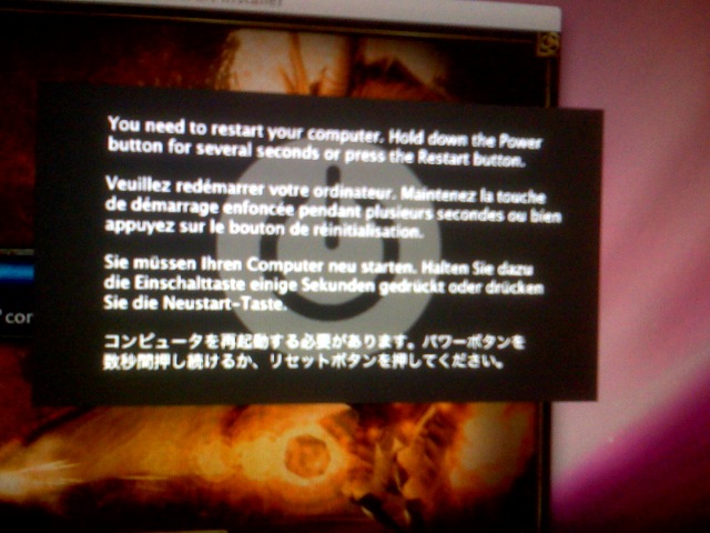

theRG Posted February 6, 2008 Share Posted February 6, 2008 Followed the guide and got it running fairly well so far. One issue I got was a notice to reboot (see screen). I was installing WoW off of a dvd at the time so maybe it had something to do with that. Anyways followed the MBR dual boot instructions (though I haven't setup EasyBCD in Vista yet). I used this install: http://scottdangel.com/blog/?p=19 for my EVGA 8800GT 256mb and have dual monitors working flawlessly. Leopard also recognizes my 4 gigs of ram correctly. Thanks mtotho for this post and advice. Gigabyte GA-P35-DS3L Q6600 Quad Core Processor 2.4ghz GSkill 2 x 2GB 300gig sata (Leopard) 250gig sata (Vista) 500gig sata EVGA 8800GT 256mb Link to comment https://www.insanelymac.com/forum/topic/83689-how-to-install-on-gigabyteasuscompatible-boards/page/8/#findComment-610783 Share on other sites More sharing options...
