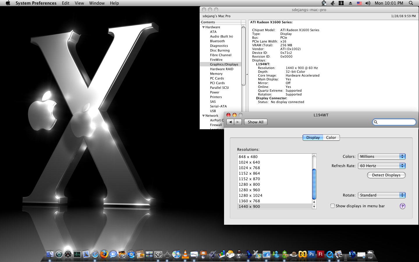

sdejang Posted January 31, 2008 Share Posted January 31, 2008 Thank you Link to comment https://www.insanelymac.com/forum/topic/83689-how-to-install-on-gigabyteasuscompatible-boards/page/4/#findComment-602347 Share on other sites More sharing options...
