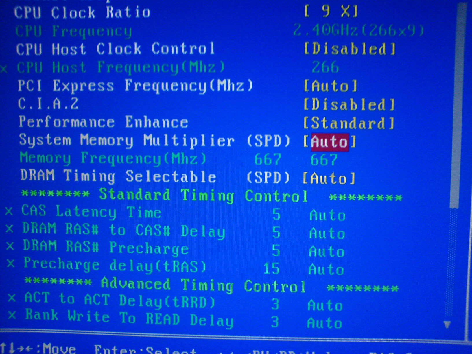

Bob The King Posted February 6, 2008 Share Posted February 6, 2008 I was always under the impression that your bios reported your memory (unless oc'd) as stock setting, in this case 800MHz and not 667Mhz. I've uploaded a ss. Could the memory i've been sent been mislabelled or is ther a setting i'm missing? Link to comment https://www.insanelymac.com/forum/topic/83689-how-to-install-on-gigabyteasuscompatible-boards/page/9/#findComment-611024 Share on other sites More sharing options...
dci693 Posted February 6, 2008 Share Posted February 6, 2008 I was always under the impression that your bios reported your memory (unless oc'd) as stock setting, in this case 800MHz and not 667Mhz. I've uploaded a ss. Could the memory i've been sent been mislabelled or is ther a setting i'm missing?Yes, your BIOS will report your memory's stock setting unless O/C'd, but if your memory is capable of multiple speeds and timings then it will default to the speed that corresponds to the voltage being applied by your motherboard. IOW, if you feed it 1.8v, it will run at 667, if you apply (just throwing this number out there) 2.1v, it will run at 800. I'm going to say it again: look at your docs and the OCZ support site/forums. They will tell you the proper settings. Plus, you can't be the only person out there running this memory. Do some Googling and see what other people have done. Link to comment https://www.insanelymac.com/forum/topic/83689-how-to-install-on-gigabyteasuscompatible-boards/page/9/#findComment-611043 Share on other sites More sharing options...

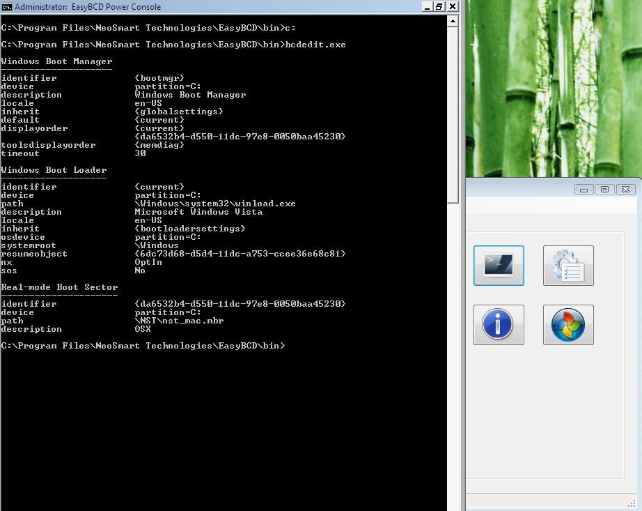

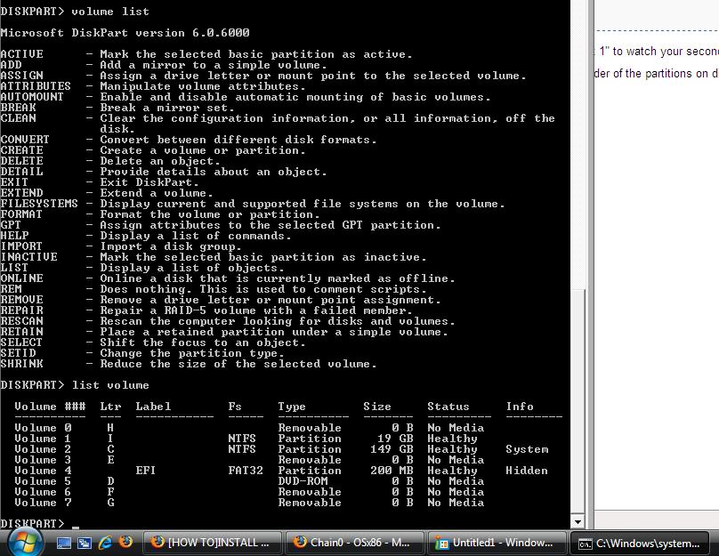

mohkahn Posted February 7, 2008 Share Posted February 7, 2008 MAN... i AM ALMOST there, please some help. I have finally given up on XP.. Too much trouble to do a Tri boot. so please help me with DUAL BOOT.VISTA / OSX. OS: 1) VISTA (installed) Can boot in vista successfully everytime. OS: 2) OSX (KALYWAY 10.5.1) (installed) Gives error (chain booting error) VISTA: Installed on : 160GB SATA: (disk 0, partition 0 or 1, can't remember) No partitions.. OSX: Installed on : 160GB SATA: (disk 1, partition 2 ) (though while installing I did not make any partitions, just installed it on current partion as shown in diskutility) i could not do it as MBR.. somehow only had option for guid. so I made sure that i also choose guid from the Kalaway DVD disk before installing. PROBLEM: CHAIN booting error. WHAT I ALREADY TRIED: 1)Have installed easy bcd and made a new entry named OSX, name of my install is also OSX. 2)Have copied chain0 from a wiki website (i think the dvd has the same chain0, since they are both in almost 1kb each) 3)Now want to edit boot.ini by inserting this (C:\chain0="Mac OS X86") entry into the bootini file, but wait A minute...... there is not boot.ini in vista.. 4)So I try bcdedit.exe in the run command of vista and from within vista it just won't open.. but 5)if I use a utility name EasyBCD power.. I get to this stage... please take a look at the snapshop QUESTIONS; 1)So there is Windows boot manager, boot loader.. and both of them have this "partition=c:" so which one do I choose / use. 2) and do I put exact these wording? C:\chain0="Mac OS X86" or do i put OSX only, since i am using this name. and are these necessary (" ") or just (c:\chain0n=OSX) will be enough 3) if not, please tell me what wording i put. 4) if i am totally in a wrong area and I should boot by using vista dvd and then find command prompt then how do I find bootedit or boot.ini (doubt it will have boot.ini) and how do i edit it. please help I am very near dual booting these 2 systems without any further boot problems, if you can help.. I have spent 10 days and at least done 10 reinstalls of all 3 systems... so your kind input is much appreciated.. JUST some more back ground info..""http://wiki.osx86project.org/wiki/index.php/Chain0"" from this place I found diskpart command.. choose RUN from VISTA and type DISKPART and the utitility as shown in the photo below shows up. I tried to see my OSX partition, but i was not successful. the only clue that it is installed is at volume 4.. efi.. fat 32.. 200mb.. this seems to be the apple volume and it is shown as hidden..I am not sure, if above information is usefull, but just posting it for your reference.. Link to comment https://www.insanelymac.com/forum/topic/83689-how-to-install-on-gigabyteasuscompatible-boards/page/9/#findComment-612396 Share on other sites More sharing options...
