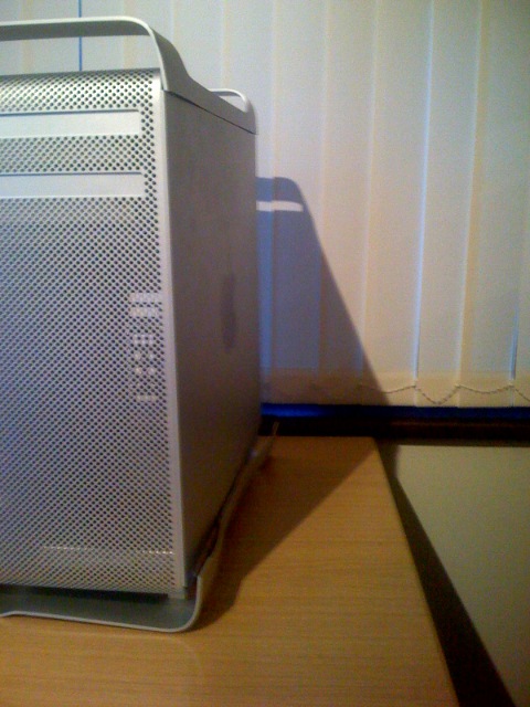

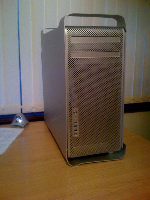

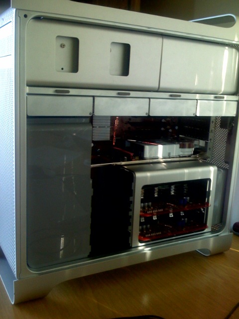

Yes, there is :)
Here is mine
Soz for off-topic guys, thought this might help Fabriciom
@ Nagal: Great going there, luv what you're doing. I have ordered a MacPro, with all alu-bits, some auxilliaries from Ebay (wefixmacs)
So, after my Hackintosh is complete, I will tackle the MacPro, might go the same route as you ;)
