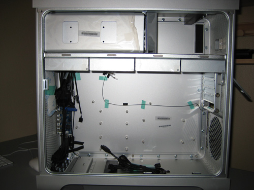

Sorry septicdeathm just wanted to say that you choose the wrong topic, this one is called : "building a macpro, yes a macpro not a hackintosh". Could be confusing for other users. :unsure:

I think that you have not read the full thread from the beginning. Nagal is talking about building a REAL macpro, check the pictures at the start of the thread. Some commentators wrongly talked about building a hackintosh and this is not not he good thread here.
