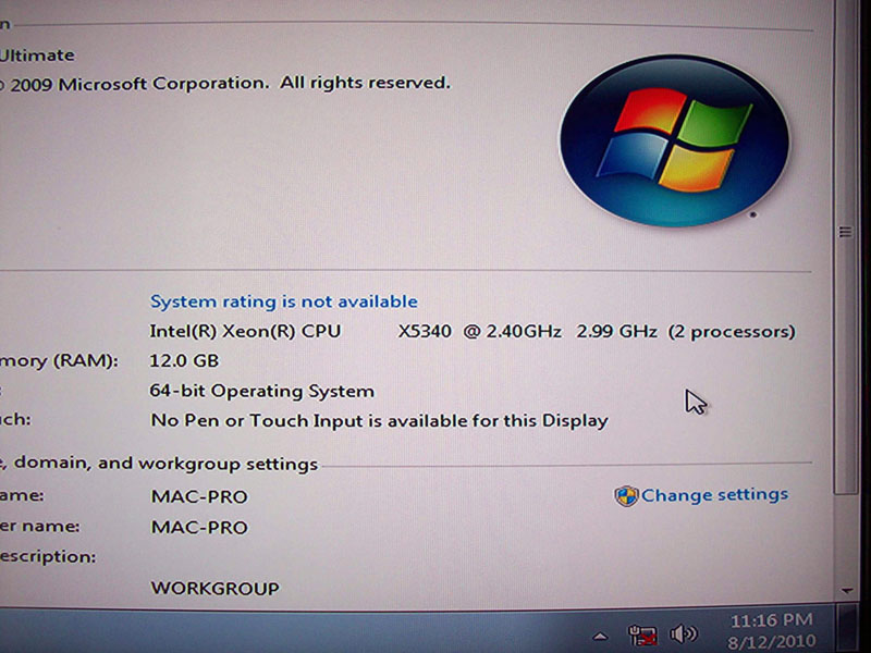

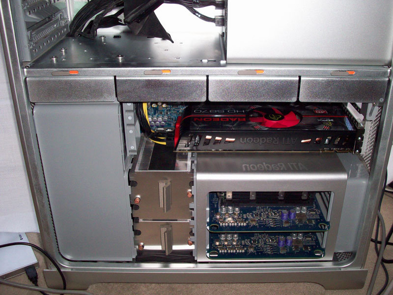

Hello everyone!
This one is a very interesting thread, I started reading it about when it was created but only recently (last week) I decided to venture on a project like building a MacPro.
This is my experience so far:

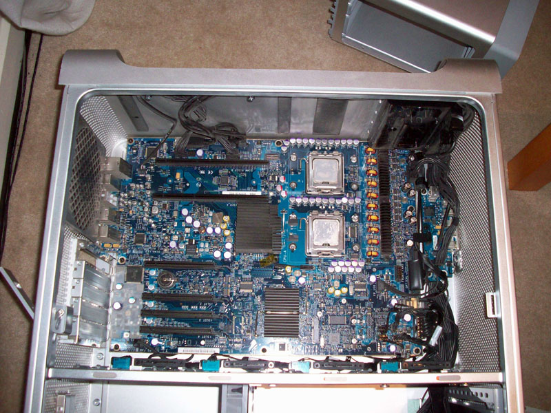

-I bought a used 2006 MacPro (1,1) on eBay for $700

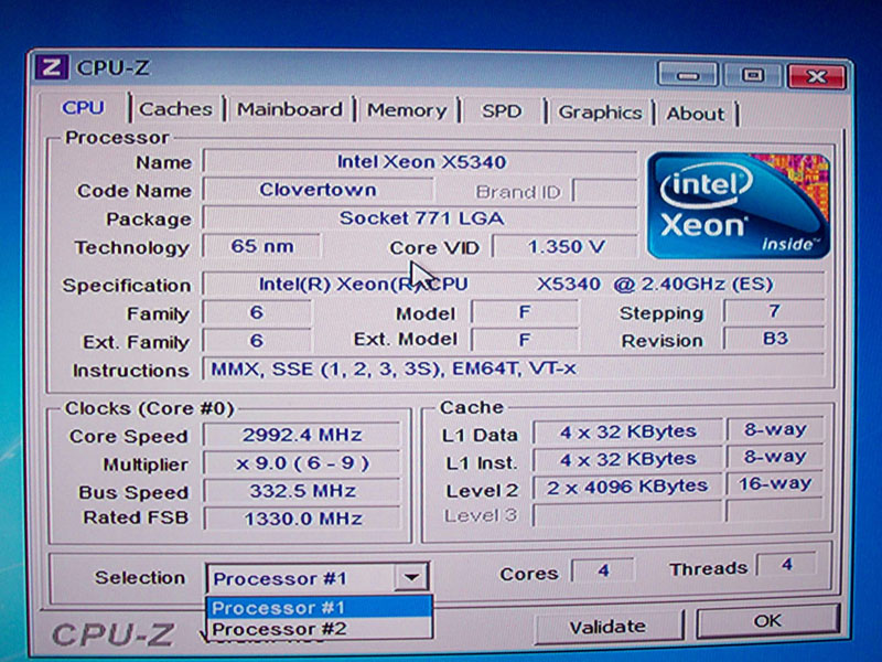

-Tossed in a matched pair of Intel 'QUQI' 5340 ES (2.4ghz, 1066 fsb) for $300
-Got some memory from OWC (I think it was around $300 including shipping for 8gigs)

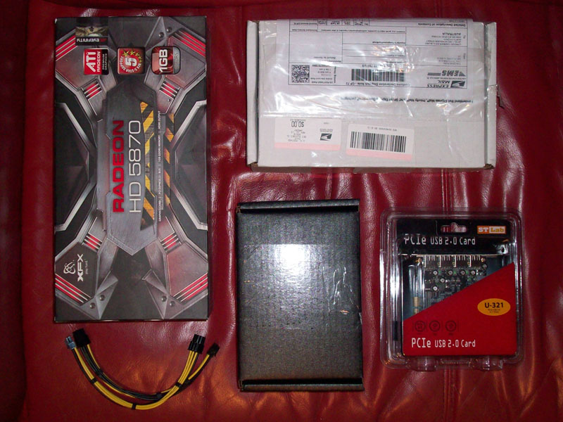

-Bought and then flashed a XFX Radeon HD 5870 card (around $379) with Uakari ROM
-Purchased a USB 2.0 PCIe card that gives me 4 external USB ports and 1 internal ($35)
-Ordered two 6-pin cables for $20 (Logic Board mini 6-pin to VGA card 6-pin)
TOTAL: just a little over the $1,700 mark.
I immediately removed the Dual Core 2.0Ghz Cpus, installed my Quad Core QUQIs (sounds like 'cookies' :-) ) with the BSEL mod, kept the 4x1GB module so to have a total of 12GB and ventured the flashing odyssey. After 2 days I finally found the right ROM that worked for me.

1) As said in many threads, the 5870 (even the Apple one) won't show the booting sequence on a 2006 model if you connect the monitor through DVI. I use a DVI-VGA cable and it works just fine, except for the fact that the initial resolution is lower and the Apple logo is gigantic! A pure cosmetic issue I really don't care about.
2) The QUQIs appear to still work at 1066. I read that this is a common problem and thought myself that these Engineering Samples wouldn't overclock. I decided not to rush re-opening, disassembling and re-doing the mod and wait until I installed Windows. The latter says my CPUs are definitely working at 3,0 Ghz. I've done it this very morning so I'll have to investigate it more, but I think I can say it's just OS X showing the wrong value. Resetting the PRAM (Command+Option+P+R) didn't help. Tonight I'll try Cpu-z or similar and see what is says.
So, so far so good. I'm very happy with my savings!

The case, with nothing inside except for the logic board and the old CPUs
My "shopping cart", with all the things I wanted to put in the Mac Pro
My assembled system. The optical drives are the only things left to be installed
Windows says the truth: CPUs clock is 3.0Ghz, not 2.4! BSEL mod works!
Speedstep works too, even without bootcamp drivers installed: I've seen the multiplier changing dynamically depending on the load.
