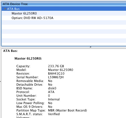

naquaada Posted November 25, 2008 Share Posted November 25, 2008 Is there any way to support SATA-300 ? My low harddisk speed is the worst problem on my system. Booting from IDE is faster than from SATA, and as I had an older Maxtor ATA-133 IDE HD I had amazing results. BTW: I have 10.5.3 on an Opteron 185 now - I'm usually in insanleymac.com ;-) Firewire 800 also was a bit faster than SATA, with the same harddisk. Link to comment https://www.insanelymac.com/forum/topic/77071-nforce-sata-controller/page/27/#findComment-977252 Share on other sites More sharing options...
