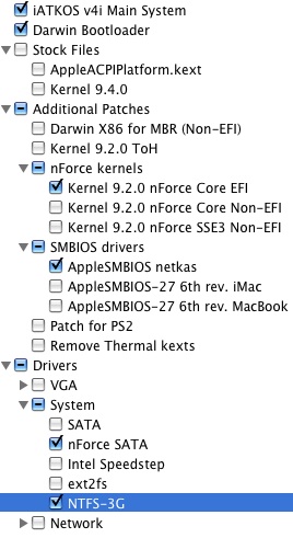

fentom Posted September 9, 2008 Share Posted September 9, 2008 OK, try it from the beginning! BIOS settings: Reset the BIOS, then set HPET-ON ACPI-ON The 2nd ethernet controller-OFF FLOPPY-OFF Computer: DVD-IDE Master HDD-IDE Slave/Sata No other drives OSX Installer: iAtkos v4i Bootflags for installation: nforce_core -v Partition Format: Mac OS Extended Journaled-MBR/GPT Installation select: Hi ASUS Striker Extreme, NForce 680i (MCP55) SATAII Western 500Gb NVIDIA 8800 GTS 640Mb Error booting from iAtkos 4.0 SAM MULTIMEDIA ERROR READ WRITE ... Same DVD in laptop Compaq INSTALL w/o problems (I just stopped in select partition to install) I will try this steps and I will contact again Thanks Link to comment https://www.insanelymac.com/forum/topic/77071-nforce-sata-controller/page/26/#findComment-884588 Share on other sites More sharing options...

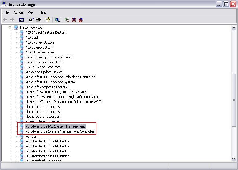

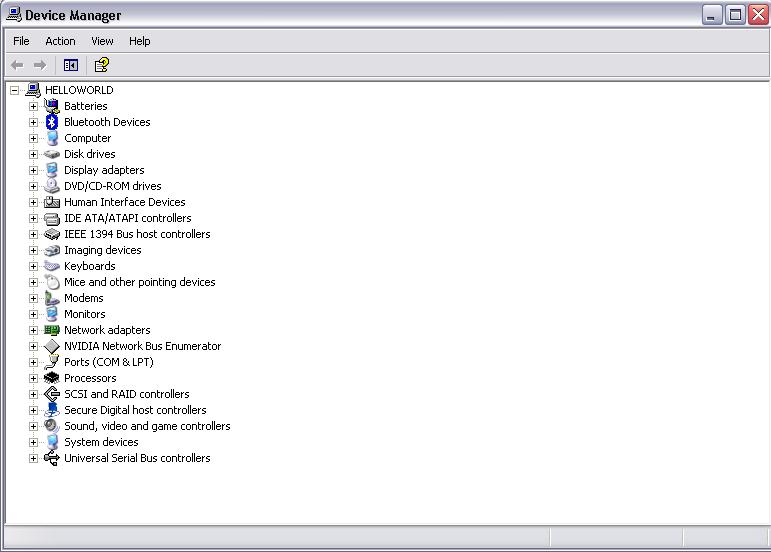

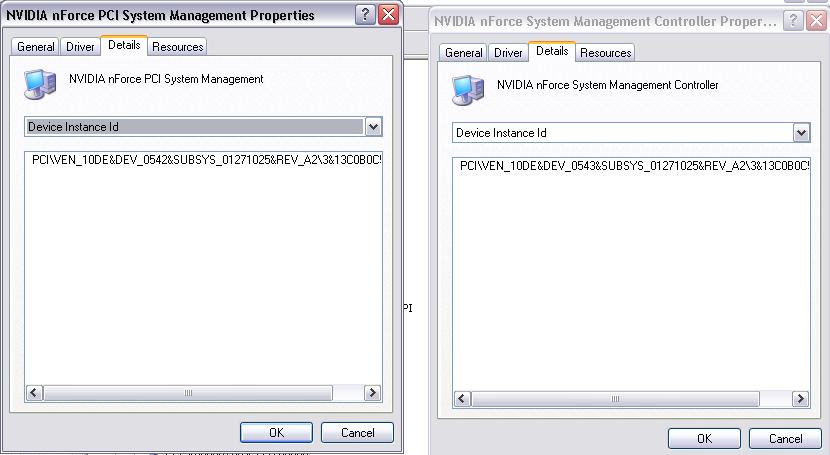

digilevi Posted September 12, 2008 Share Posted September 12, 2008 hi MeDevil i just want to ask if im getting the right device id's of my nforce sata controller. can you pls look at the attached screenshots? btw, my system is acer 4520G, MCP67 chipset with a SATA 160GB drive. if you can give me the id's i would very glad. thanks in advance MeDevil. Link to comment https://www.insanelymac.com/forum/topic/77071-nforce-sata-controller/page/26/#findComment-887636 Share on other sites More sharing options...
