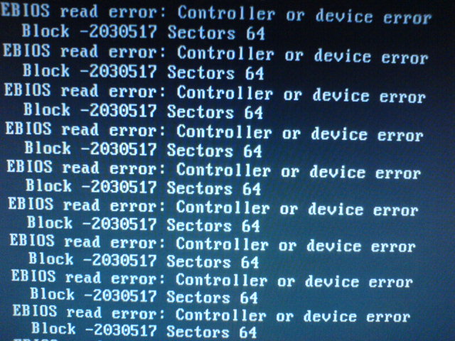

_:_M-F-D-K_:_ Posted December 21, 2007 Share Posted December 21, 2007 no matter what i do this is what i get when tryin to boot from DVD... what could that be....? P4 Prescott 3.80Ghz Asus P4GPL-X 1GB of ddr nVidia 7300GT 120GB Maxtor Link to comment Share on other sites More sharing options...
