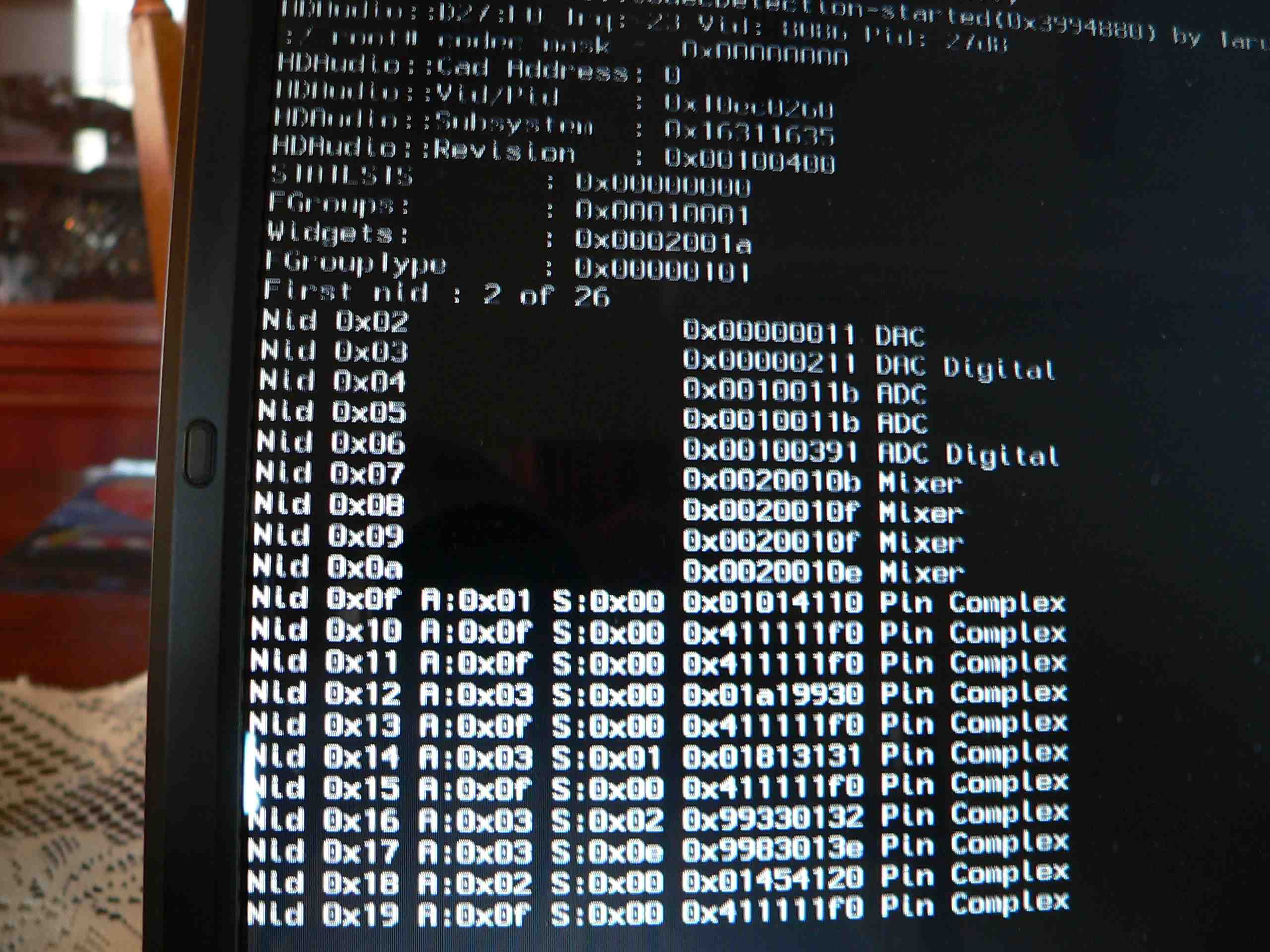

alc260 in an nec 7020p laptop..
Codec: Realtek ALC260
Address: 0
Vendor Id: 0x10ec0260
Subsystem Id: 0x16311635
Revision Id: 0x100400
HDAudio[0x3f1fc00]::CodecDetection-started(0x394dd80) by Taruga
HDAudio::D27:F0 Irq: 23 Vid: 8086 Pid: 27d8
HDAudio::Cad Address: 0
HDAudio::Vid/Pid : 0x10ec0260 0x00000000 0x00000000
HDAudio::Subsystem : 0x16311635
HDAudio::Revision : 0x00100400
HDAudio[0x3f1fc00]::CodecDetection-ended(0x1)

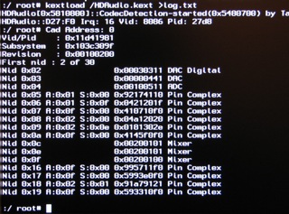

the v5 looks ok in -s
but after the copy to log command it doesnt appear to be complete
so i took a pic...

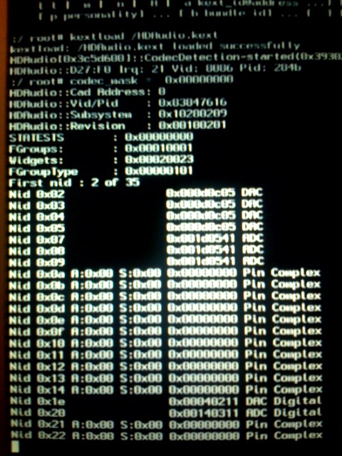

Umm... there is more, and its NOT just all 0's when I do it... but thats what the system log says, I'm going to take a picture of it.
Edit: here is a pic
sorry, its an iphone pic :)

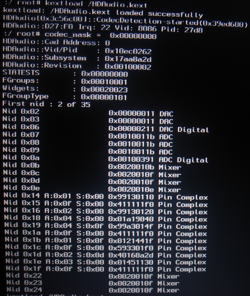

Taruga,
My audio controller is a Realtek ALC262, on-board for a Lenovo 3000 Y410 laptop.
Here's my codec dump from Knoppix:
Codec: Realtek ALC262
Address: 0
Vendor Id: 0x10ec0262
Subsystem Id: 0x17aa3837
Revision Id: 0x100002

Here's the output from HDAudio v5:
Jan 17 07:20:17 localhost kernel[0]: HDAudio[0x3f5e200]::CodecDetection-started(0x3cc1280) by Taruga
Jan 17 07:20:17 localhost kernel[0]: HDAudio::D27:F0 Irq: 22 Vid: 8086 Pid: 284b
Jan 17 07:20:17 localhost kernel[0]: codec_mask =  0x00000000
Jan 17 07:20:17 localhost kernel[0]: HDAudio::Cad Address: 0
Jan 17 07:20:17 localhost kernel[0]: HDAudio::Vid/Pid	: 0x10ec0262
Jan 17 07:20:17 localhost kernel[0]: HDAudio::Subsystem  : 0x17aa3837
Jan 17 07:20:17 localhost kernel[0]: HDAudio::Revision   : 0x00100002
Jan 17 07:20:17 localhost kernel[0]: STATESTS	   : 0x00000000
Jan 17 07:20:17 localhost kernel[0]: FGroups:	   : 0x00010001
Jan 17 07:20:17 localhost kernel[0]: Widgets:	   : 0x00020023
Jan 17 07:20:17 localhost kernel[0]: FGroupType	 : 0x00000101
Jan 17 07:20:17 localhost kernel[0]: First nid : 2 of 35
Jan 17 07:20:17 localhost kernel[0]: Nid 0x02			   0x00000011 DAC
Jan 17 07:20:17 localhost kernel[0]: Nid 0x03			   0x00000011 DAC
Jan 17 07:20:17 localhost kernel[0]: Nid 0x06			   0x00000211 DAC Digital
Jan 17 07:20:17 localhost kernel[0]: Nid 0x07			   0x0010011b ADC
Jan 17 07:20:17 localhost kernel[0]: Nid 0x08			   0x0010011b ADC
Jan 17 07:20:17 localhost kernel[0]: Nid 0x09			   0x0010011b ADC
Jan 17 07:20:17 localhost kernel[0]: Nid 0x0a			   0x00100391 ADC Digital
Jan 17 07:20:17 localhost kernel[0]: Nid 0x0b			   0x0020010b Mixer
Jan 17 07:20:17 localhost kernel[0]: Nid 0x0c			   0x0020010f Mixer
Jan 17 07:20:17 localhost kernel[0]: Nid 0x0d			   0x0020010f Mixer
Jan 17 07:20:17 localhost kernel[0]: Nid 0x0e			   0x0020010e Mixer
Jan 17 07:20:17 localhost kernel[0]: Nid 0x14 A:0x01 S:0x00 0x99130110 Pin Complex
Jan 17 07:20:17 localhost kernel[0]: Nid 0x15 A:0x0f S:0x00 0x411111f0 Pin Complex
Jan 17 07:20:17 localhost kernel[0]: Nid 0x16 A:0x02 S:0x00 0x99130120 Pin Complex
Jan 17 07:20:17 localhost kernel[0]: Nid 0x18 A:0x04 S:0x00 0x01a19840 Pin Complex
Jan 17 07:20:17 localhost kernel[0]: Nid 0x19 A:0x04 S:0x0f 0x99a3094f Pin Complex
Jan 17 07:20:17 localhost kernel[0]: Nid 0x1a A:0x0f S:0x00 0x411111f0 Pin Complex
Jan 17 07:20:17 localhost kernel[0]: Nid 0x1b A:0x01 S:0x0f 0x0121441f Pin Complex
Jan 17 07:20:17 localhost kernel[0]: Nid 0x1c A:0x0f S:0x00 0x593301f0 Pin Complex
Jan 17 07:20:17 localhost kernel[0]: Nid 0x1d A:0x02 S:0x0d 0x40168a2d Pin Complex
Jan 17 07:20:17 localhost kernel[0]: Nid 0x1e A:0x03 S:0x00 0x01451130 Pin Complex
Jan 17 07:20:17 localhost kernel[0]: Nid 0x1f A:0x0f S:0x00 0x411111f0 Pin Complex
Jan 17 07:20:17 localhost kernel[0]: Nid 0x22			   0x0020010f Mixer
Jan 17 07:20:17 localhost kernel[0]: Nid 0x23			   0x0020010f Mixer
Jan 17 07:20:17 localhost kernel[0]: Nid 0x24			   0x0020010f Mixer
If understand what you're looking for, the Address and Subsystem appear to match.
Thanks for your work.

Sigmatel 9228 , Dell M1330
I get no output from v3,
and I get from v5 , this
Jan 23 21:38:18 15 kernel[0]: HDAudio[0x4a9fc00]::CodecDetection-started(0x41a5d80) by Taruga
Jan 23 21:38:18 15 kernel[0]: HDAudio::D27:F0 Irq: 21 Vid: 8086 Pid: 284b
Jan 23 21:38:18 15 kernel[0]: codec_mask = 0x00000000
Jan 23 21:38:18 15 kernel[0]: HDAudio::Cad Address: 0
Jan 23 21:38:18 15 kernel[0]: HDAudio::Vid/Pid : 0x83847616
Jan 23 21:38:18 15 kernel[0]: HDAudio::Subsystem : 0x1028020a
Jan 23 21:38:18 15 kernel[0]: HDAudio::Revision : 0x00100201
Jan 23 21:38:18 15 kernel[0]: STATESTS : 0x00000000
Jan 23 21:38:18 15 kernel[0]: FGroups: : 0x00010001
Jan 23 21:38:18 15 kernel[0]: Widgets: : 0x00020023
Jan 23 21:38:18 15 kernel[0]: FGroupType : 0x00000101
Jan 23 21:38:18 15 kernel[0]: First nid : 2 of 35
Jan 23 21:38:18 15 kernel[0]: Nid 0x02 0x000d0c05 DAC
Jan 23 21:38:18 15 kernel[0]: Nid 0x03 0x000d0c05 DAC
Jan 23 21:38:19 15 kernel[0]: Nid 0x04 0x000d0c05 DAC
Jan 23 21:38:19 15 kernel[0]: Nid 0x05 0x000d0c05 DAC
Jan 23 21:38:19 15 kernel[0]: Nid 0x07 0x001d0541 ADC
Jan 23 21:38:19 15 kernel[0]: Nid 0x08 0x001d0541 ADC
Jan 23 21:38:19 15 kernel[0]: Nid 0x09 0x001d0541 ADC
Jan 23 21:38:20 15 kernel[0]: Nid 0x0a A:0x00 S:0x00 0x00000000 Pin Complex
Jan 23 21:38:20 15 kernel[0]: Nid 0x0b A:0x00 S:0x00 0x00000000 Pin Complex
Jan 23 21:38:20 15 kernel[0]: Nid 0x0c A:0x00 S:0x00 0x00000000 Pin Complex
Jan 23 21:38:21 15 kernel[0]: Nid 0x0d A:0x00 S:0x00 0x00000000 Pin Complex
Jan 23 21:38:21 15 kernel[0]: Nid 0x0e A:0x00 S:0x00 0x00000000 Pin Complex
Jan 23 21:38:21 15 kernel[0]: Nid 0x0f A:0x00 S:0x00 0x00000000 Pin Complex
Jan 23 21:38:22 15 kernel[0]: Nid 0x10 A:0x00 S:0x00 0x00000000 Pin Complex
Jan 23 21:38:22 15 kernel[0]: Nid 0x11 A:0x00 S:0x00 0x00000000 Pin Complex
Jan 23 21:38:22 15 kernel[0]: Nid 0x12 A:0x00 S:0x00 0x00000000 Pin Complex
Jan 23 21:38:23 15 kernel[0]: Nid 0x13 A:0x00 S:0x00 0x00000000 Pin Complex
Jan 23 21:38:23 15 kernel[0]: Nid 0x14 A:0x00 S:0x00 0x00000000 Pin Complex
Jan 23 21:38:24 15 kernel[0]: Nid 0x1e 0x00040211 DAC Digital
Jan 23 21:38:24 15 kernel[0]: Nid 0x20 0x00140311 ADC Digital
Jan 23 21:38:24 15 kernel[0]: Nid 0x21 A:0x00 S:0x00 0x00000000 Pin Complex
Jan 23 21:38:24 15 kernel[0]: Nid 0x22 A:0x00 S:0x00 0x00000000 Pin Complex
and I attached codec file from Fedora 8 Live CD.
codec0_dell_3stack.txt

Here's one more without any clue how to capture the kextload output in single user mode. Tried IO redirection - didn't work.
So here is my screenshot from v6 loading on a AD1981HD system.
I follow Taruga's instructions at post #1 except I do mount the file system. After loading the kext I run
dmesg > HDAudioOutput
then exit. When OS X starts up I edit the file HDAudioOutput so that it just has the info that Taruga is asking for.
Jon
