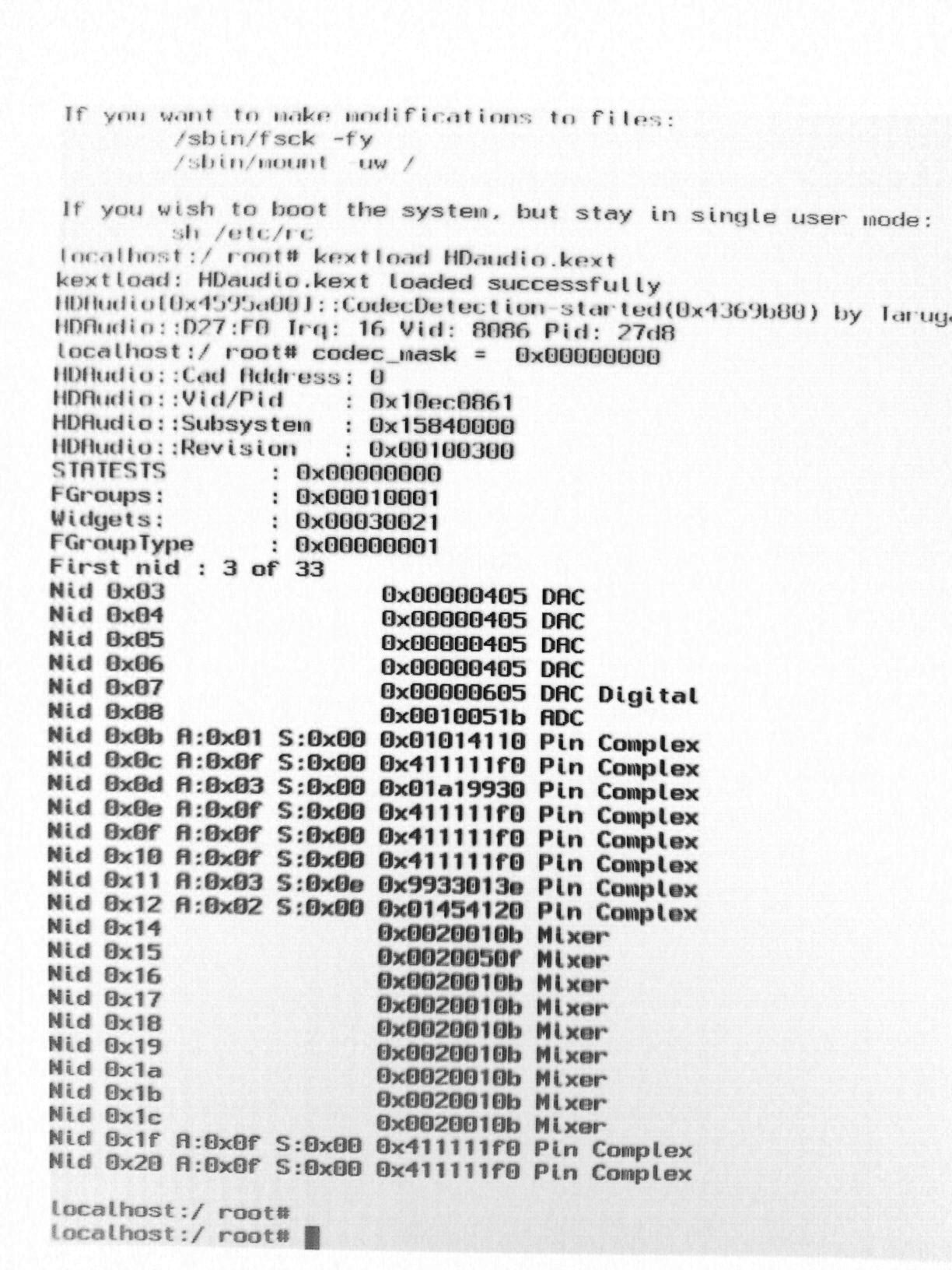

* 05/01/2008 New version to test and send output
Hi guys, I need some testers for a component of my next patcher. (This test is very important for the release of the new patcher)
What should you do:
  • Download the attached kext, unzip it.
  • Copy it to root ( / )
  • Set permissions
    chown -R root:wheel /HDAudio.kext
    chmod -R 755 /HDAudio.kext
  • Boot with -s (no need to mount file system)
  • kextload /HDAudio.kext
It should read the codec info and report something like this on v3:

No go here too ;)
Used HDAudio v5 on Realtek ALC888 (Gigabyte P31 mobo: ICH7)
Output:
kextload: /HDAudio.kext/ loaded successfully
HDAudio[0x3b01200]::CodecDetection-started(0x38c0080) by Taruga
HDAudio::D27:F0 Irq: 16 Vid: 8086 Pid: 27d8
:/ root# codec_mask = 0x00000000
HDAudio::Cad Address:	0x00000000
HDAudio::Vid/Pid:		0x00000000
HDAudio::Subsystem:		0x00000000
HDAudio::Revision:		0x00000000
STATESTS:	0x00000000
FGroups:		0x00000000
Widgets:		0x00000000
FGroupType:	0x00000000
First nid: 0 of 0
Then i had to press Ctrl+C and type "kextunload /HDAudio.kext" then "exit" to complete the boot sequence normally.

Hi Taruga
Thanks for your great work
Sorry that I am not used to line commands
After booting -s and loading HDaudio.kest (v5), I did not know how to get loading details as text file
So, I took a picture of the screen (attached) and rebooted
Also attached linux dump of my ALC861
Best regards

Jan 13 10:37:31 localhost kernel[0]: Nid 0x0a			   0x00100391 ADC Digital
Jan 13 10:37:31 localhost kernel[0]: Nid 0x0b			   0x0020010b Mixer
Jan 13 10:37:31 localhost kernel[0]: Nid 0x0c			   0x0020010f Mixer
Jan 13 10:37:31 localhost kernel[0]: Nid 0x0d			   0x0020010f Mixer
Jan 13 10:37:31 localhost kernel[0]: Nid 0x0e			   0x0020010f Mixer
Jan 13 10:37:31 localhost kernel[0]: Nid 0x0f			   0x0020010f Mixer
Jan 13 10:37:31 localhost kernel[0]: Nid 0x14 A:0x01 S:0x0f 0x0121101f Pin Complex
Jan 13 10:37:31 localhost kernel[0]: Nid 0x15 A:0x0f S:0x00 0x411111f0 Pin Complex
Jan 13 10:37:31 localhost kernel[0]: Nid 0x16 A:0x0f S:0x00 0x411111f0 Pin Complex
Jan 13 10:37:31 localhost kernel[0]: Nid 0x17 A:0x0f S:0x00 0x411111f0 Pin Complex
Jan 13 10:37:31 localhost kernel[0]: Nid 0x18 A:0x03 S:0x00 0x01a19830 Pin Complex
Jan 13 10:37:31 localhost kernel[0]: Nid 0x19 A:0x0f S:0x00 0x411111f0 Pin Complex
Jan 13 10:37:31 localhost kernel[0]: Nid 0x1a A:0x0f S:0x00 0x411111f0 Pin Complex
Jan 13 10:37:31 localhost kernel[0]: Nid 0x1b A:0x01 S:0x00 0x99130110 Pin Complex
Jan 13 10:37:31 localhost kernel[0]: Nid 0x1c A:0x0f S:0x00 0x593301f0 Pin Complex
Jan 13 10:37:31 localhost kernel[0]: Nid 0x1d A:0x0f S:0x00 0x598301f0 Pin Complex
Jan 13 10:37:31 localhost kernel[0]: Nid 0x1e A:0x02 S:0x00 0x01451120 Pin Complex
Jan 13 10:37:31 localhost kernel[0]: Nid 0x1f A:0x0f S:0x00 0x411111f0 Pin Complex
Jan 13 10:37:31 localhost kernel[0]: Nid 0x22			   0x0020010f Mixer
Jan 13 10:37:31 localhost kernel[0]: Nid 0x23			   0x0020010f Mixer
Jan 13 10:37:31 localhost kernel[0]: Nid 0x25			   0x00000011 DAC
Jan 13 10:37:31 localhost kernel[0]: Nid 0x26			   0x0020010f Mixer
Dell D620: Sigmatel - STAC9200
Jan 13 20:30:54 localhost kernel[0]: HDAudio[0x2877c00]::CodecDetection-started(0x2642d00) by Taruga
Jan 13 20:30:54 localhost kernel[0]: HDAudio::D27:F0 Irq: 21 Vid: 8086 Pid: 27d8
Jan 13 20:30:54 localhost kernel[0]: codec_mask =  0x00000000
Jan 13 20:30:54 localhost kernel[0]: HDAudio::Cad Address: 0
Jan 13 20:30:54 localhost kernel[0]: HDAudio::Vid/Pid    : 0x83847690
Jan 13 20:30:54 localhost kernel[0]: HDAudio::Subsystem  : 0x102801c2
Jan 13 20:30:54 localhost kernel[0]: HDAudio::Revision   : 0x00102201
Jan 13 20:30:54 localhost kernel[0]: STATESTS       : 0x00000000
Jan 13 20:30:54 localhost kernel[0]: FGroups:       : 0x00010001
Jan 13 20:30:54 localhost kernel[0]: Widgets:       : 0x00020013
Jan 13 20:30:54 localhost kernel[0]: FGroupType     : 0x00000101
Jan 13 20:30:54 localhost kernel[0]: First nid : 2 of 19
Jan 13 20:30:54 localhost kernel[0]: Nid 0x02               0x000d0401 DAC
Jan 13 20:30:54 localhost kernel[0]: Nid 0x03               0x001d0541 ADC
Jan 13 20:30:54 localhost kernel[0]: Nid 0x04               0x00140311 ADC Digital
Jan 13 20:30:54 localhost kernel[0]: Nid 0x05               0x00040211 DAC Digital
Jan 13 20:30:54 localhost kernel[0]: Nid 0x08 A:0x00 S:0x00 0x00000000 Pin Complex
Jan 13 20:30:54 localhost kernel[0]: Nid 0x09 A:0x00 S:0x00 0x00000000 Pin Complex
Jan 13 20:30:54 localhost kernel[0]: Nid 0x0d A:0x00 S:0x00 0x00000000 Pin Complex
Jan 13 20:30:54 localhost kernel[0]: Nid 0x0e A:0x00 S:0x00 0x00000000 Pin Complex
Jan 13 20:30:54 localhost kernel[0]: Nid 0x0f A:0x00 S:0x00 0x00000000 Pin Complex
Jan 13 20:30:54 localhost kernel[0]: Nid 0x10 A:0x00 S:0x00 0x00000000 Pin Complex
Jan 13 20:30:54 localhost kernel[0]: Nid 0x11 A:0x00 S:0x00 0x00000000 Pin Complex
Jan 13 20:30:54 localhost kernel[0]: Nid 0x12 A:0x00 S:0x00 0x00000000 Pin Complex
Jan 13 20:30:54 localhost kernel[0]: Nid 0x13               0x00200100 Mixer
Linux Codec Dump

Taruga: Hopes this helps with the driver. Thanks for the scene/community support.
--ONoff
My sound Card is AD1981HD on HP nx8420. With V5 HDAudio,I got the following messeger:
HDAudio[0x50ccc00]:: CodecDectection-started(0x4d6d280) by Taruga
HDAudio : : D27:F0 Irq:16 Vid:8086 Pid:27d8
:/ root# codec-mask=0x00000000
HDAudio::Cad Address:0
HDAudio::Vid/Pid:0x11d41981
HDAudio::Subsystem:0x103c30a3
HDAudio::Revision:0x00100200
STATESTS:0x00000000
FGroups:0x00010001
Widgets:0x0002001e
FGroupType:0x00000001
First nid:2 of 30
Nid 0x02 0x00030311 DAC Digital
Nid 0x03 0x00000441 DAC
Nid 0x04 0x00100511 ADC
Nid 0x05 A:0x01 S:0x00 0x92174110 Pin Complex
Nid 0x06 A:0x01 S:0x0f 0x0421201f Pin Complex
Nid 0x07 A:0x0f S:0x00 0x410710f0 Pin Complex
Nid 0x08 A:0x02 S:0x00 0x04a12020 Pin Complex
Nid 0x09 A:0x02 S:0x0e 0x0181302e Pin Complex
Nid 0x0a A:0x0f S:0x00 0x4145f0f0 Pin Complex
Nid 0x0c 0x00200101 Mixer
Nid 0x0e 0x00200101 Mixer
Nid 0x0f 0x00200100 Mixer
Nid 0x16 A:0x0f S:0x00 0x995711f0 Pin Complex
Nid 0x17 A:0x0f S:0x00 0x5993e0f0 Pin Complex
Nid 0x18 A:0x02 S:0x01 0x91a79121 Pin Complex
Nid 0x19 A:0x0f S:0x00 0x593310f0 Pin Complex
Guest
