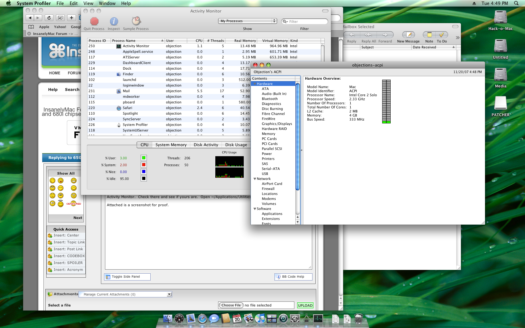

Objection Posted November 20, 2007 Share Posted November 20, 2007 I saw a thread though I'm going to bed so I'm not going to pull it up that said even though SYSTEM PROFILER lists you as a solo its actually using both cores. Use a processor monitor (activity viewer or some other) and see if processes hit your other cores under load. Link to comment https://www.insanelymac.com/forum/topic/69705-650-and-680i-chipset-thread/page/8/#findComment-512228 Share on other sites More sharing options...

Objection Posted November 21, 2007 Share Posted November 21, 2007 I'm able to use both of my cores too, although it shows me as a solo in system profiler. Both cores are active in Activity Monitor. Check there and see if yours are. Open ~/Applications/Utilities/Activity Monitor Attached is a screenshot for proof. Link to comment https://www.insanelymac.com/forum/topic/69705-650-and-680i-chipset-thread/page/8/#findComment-513530 Share on other sites More sharing options...

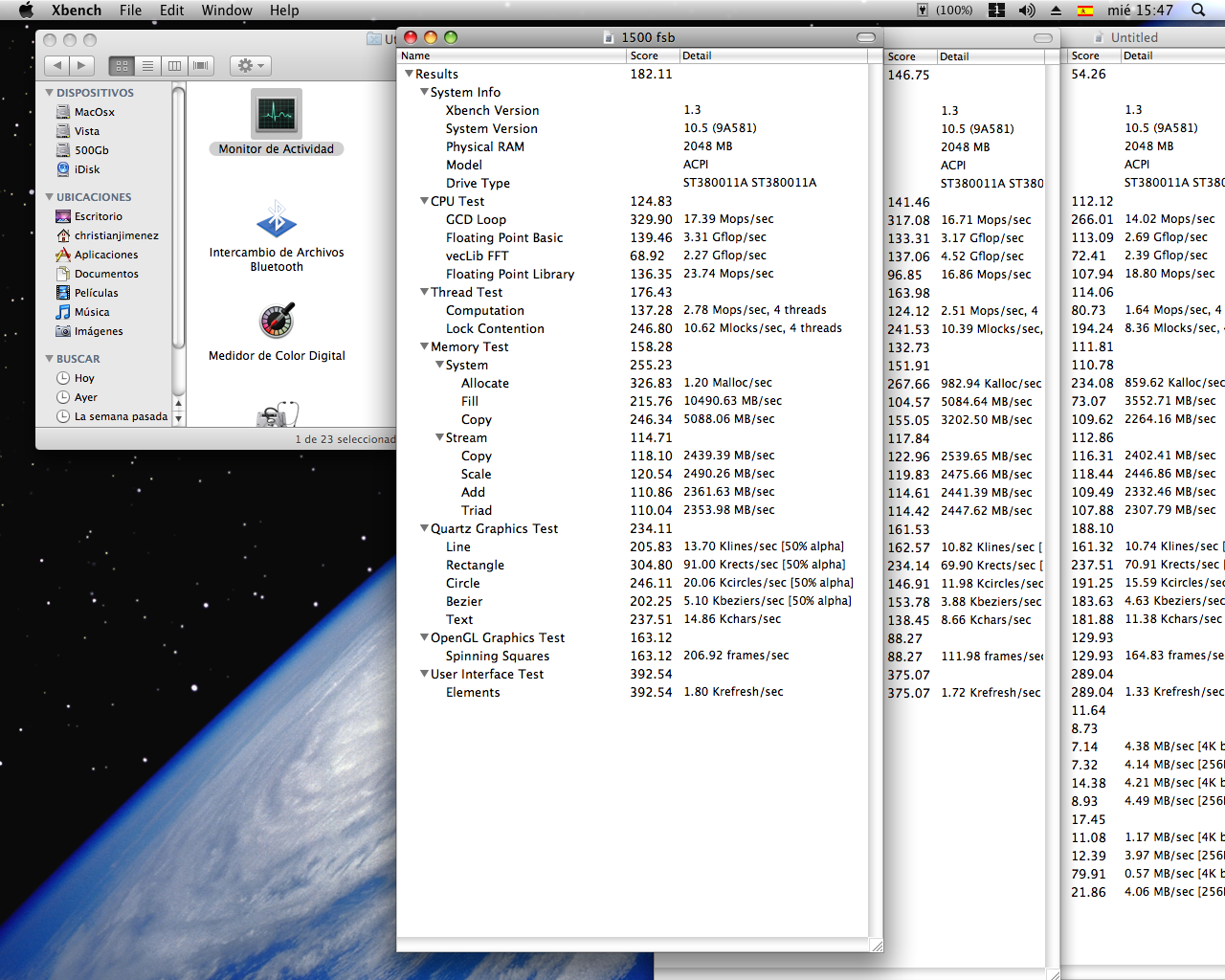

claud3 Posted November 21, 2007 Share Posted November 21, 2007 can somebody post their xbench scores for the 680i? and has anybody been able to install leopard on a sata drive using the 680i? Link to comment https://www.insanelymac.com/forum/topic/69705-650-and-680i-chipset-thread/page/8/#findComment-513642 Share on other sites More sharing options...
chrijj Posted November 21, 2007 Share Posted November 21, 2007 i did post my scores early on this thread you just need to read the other post. here are some more results without disk tests Link to comment https://www.insanelymac.com/forum/topic/69705-650-and-680i-chipset-thread/page/8/#findComment-513754 Share on other sites More sharing options...
.NetRolller 3D Posted November 21, 2007 Share Posted November 21, 2007 "Solo" is due to an AppleSMBIOS bug. It's missing the CPUIDs for "average" (non-laptop, non-Mac) Core 2 Duo/Quad/Extreme CPUs, so it defaults back to Core Solo. (My Celeron 440 also ends up being "Core Solo", although it should be more accurately "Core 2 Solo".) This doesn't necessarily mean that you are using only 1 core! Also, trying to use cpus=2 or cpus=4 on a single-core CPU or a CPU with one core disabled in the BIOS, or using cpus=4 with a dual-core will cause problems (restart on boot, etc.) So, here are the valid settings for different core types (highest performance in bold): Single-core: 1 core in BIOS+cpus=1 Dual-core: 1 core in BIOS+cpus=1, 2 cores in BIOS+cpus=1, 2 cores in BIOS+cpus=2 Quad-core: 1 core in BIOS+cpus=1, 2 cores in BIOS+cpus=1, 2 cores in BIOS+cpus=2, 4 cores in BIOS+cpus=1, 4 cores in BIOS+cpus=2, 4 cores in BIOS+cpus=3 (not sure about this one), 4 cores in BIOS+cpus=4. (Someone should really try if quad-core works as well...) Anything else will result in a crash! Also, cpu=0 is not a valid option, as the name is "cpus", not "cpu", and 0 is an invalid value AFAIK. @itsalok4u: Maybe EFI is the problem We are all doing it *without* EFI (which is designed for Intel chipsets, just for the record). Also, what are you getting with both cores enabled in BIOS and cpus=2 option? Restart after kext loading? Link to comment https://www.insanelymac.com/forum/topic/69705-650-and-680i-chipset-thread/page/8/#findComment-513876 Share on other sites More sharing options...
