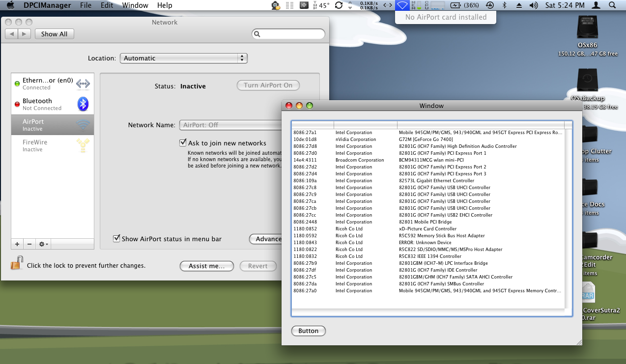

krrr Posted September 27, 2008 Share Posted September 27, 2008 guys when do you patch your bios? I got Dell 1490 just today (from hongkong ) and i replaced it with intel card , i booted and no error at all. Please see attachment too. no Airport right now help! Link to comment Share on other sites More sharing options...
