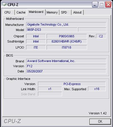

Dougie085 Posted December 25, 2007 Share Posted December 25, 2007 It's revision 2.0 I believe... might be 3.3 I really don't know how do I tell by looking at the motherboard? It doesn't seem to say there. Maybe CPU-Z will tell me I'll look at that. The DSL modem is ADSL2+ its a Zhone? I'm not sure about the administration tool I can't seem to find the right IP to access the dsl modem. I uploaded an image of my CPU-Z mainboard section. It says revision C2. I did the edit to the plist like mentioned in the first post. Link to comment https://www.insanelymac.com/forum/topic/68076-gigabyte-ga-965p-ds3-leopard-how-to-updated-110/page/15/#findComment-551898 Share on other sites More sharing options...

A.I.Ghost Posted December 26, 2007 Share Posted December 26, 2007 It's revision 2.0 I believe... Again, if you would have used search through the topic, you'd find out, that revision is printed on the board itself (in the lower-left corner - assuming, that the edges closest to the CPU are TOP/LEFT). anibalin For reboot fix, go see this post Both does not mean both kernels =) Only first one is kernel, second file is needed for proper reboot (and sometimes sleep) functioning. Link to comment https://www.insanelymac.com/forum/topic/68076-gigabyte-ga-965p-ds3-leopard-how-to-updated-110/page/15/#findComment-552044 Share on other sites More sharing options...

Dougie085 Posted December 26, 2007 Share Posted December 26, 2007 Ok looks like Rev:1.33 pretty sure thats what it says although hard to see. Link to comment https://www.insanelymac.com/forum/topic/68076-gigabyte-ga-965p-ds3-leopard-how-to-updated-110/page/15/#findComment-552130 Share on other sites More sharing options...
