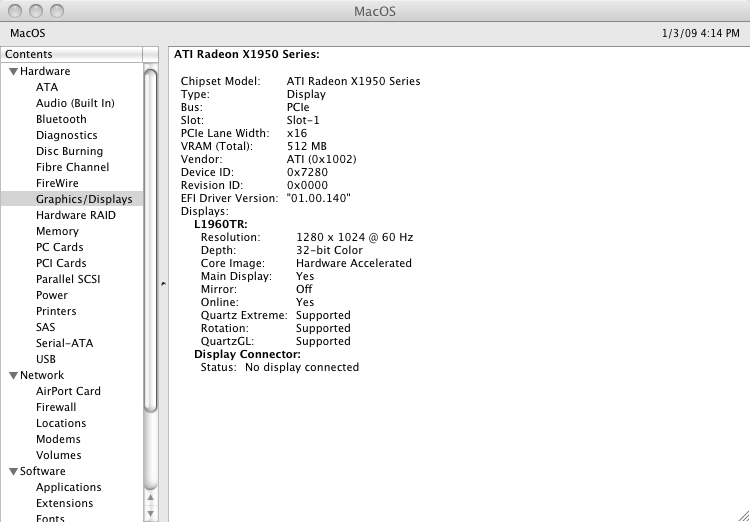

fosron Posted January 3, 2009 Share Posted January 3, 2009 Updated to 10.5.6, and with these new drivers it works like a charm! Link to comment https://www.insanelymac.com/forum/topic/58988-work-x1950gt-pro-dev_id-0x72801002-and-0x72881002/page/63/#findComment-1024973 Share on other sites More sharing options...
