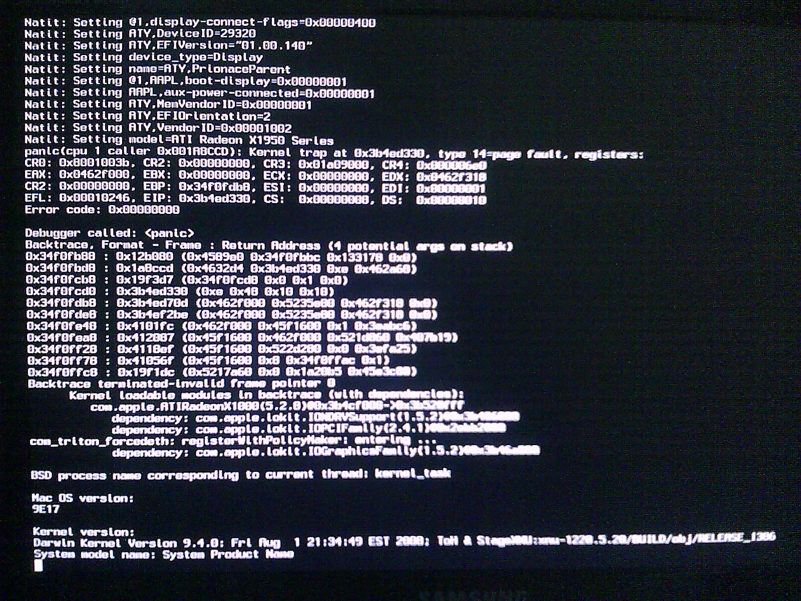

polyacryl Posted September 22, 2008 Share Posted September 22, 2008 Hello people, I still do not get it right. I have a Saphirre x1950 GT (PCI Express, 256MB, id 7288) and tried various combinations of Bronya's driver for 10.5.5 and 10.5.3. If I only install Bronya's driver for 10.5.5 I get a kernel panic. If I use ATIRadeon* from Bronya's 10.5.3 package in combination with the rest of the 10.5.5 package, I get a blue screen and a mouse cursor and nothing happens. I am really confused about which are the right files for my graphics card. Please help me, I really would appreciate it. Thank you. Edit: After testing some more last night, I think that it is ATIRadeonX1000.kext which is causing the kernel panic at boot up. I tested all of the other files in various combinations, without success, but without kernel panic, too. Link to comment https://www.insanelymac.com/forum/topic/58988-work-x1950gt-pro-dev_id-0x72801002-and-0x72881002/page/58/#findComment-900759 Share on other sites More sharing options...

polyacryl Posted September 24, 2008 Share Posted September 24, 2008 Here is a picture of the kernel panic I mentioned above. Maybe it provides some useful information. Link to comment https://www.insanelymac.com/forum/topic/58988-work-x1950gt-pro-dev_id-0x72801002-and-0x72881002/page/58/#findComment-903430 Share on other sites More sharing options...
Bronya Posted September 24, 2008 Author Share Posted September 24, 2008 Here is a picture of the kernel panic I mentioned above. Maybe it provides some useful information. OMG ! TNX . I found problem ... Please wait for 7288 ! Link to comment https://www.insanelymac.com/forum/topic/58988-work-x1950gt-pro-dev_id-0x72801002-and-0x72881002/page/58/#findComment-903891 Share on other sites More sharing options...

Bronya Posted September 28, 2008 Author Share Posted September 28, 2008 HI ! Try the it driver for 0x7288 ATIRadeonX1000.zip! Alex HQuest, Nadeem, sorry i dunno ((( for sleep . Here is a picture of the kernel panic I mentioned above. Maybe it provides some useful information. Your kernel 9.2.2 ! You should have kernel 9.5.0 ! Link to comment https://www.insanelymac.com/forum/topic/58988-work-x1950gt-pro-dev_id-0x72801002-and-0x72881002/page/58/#findComment-910091 Share on other sites More sharing options...

polyacryl Posted September 29, 2008 Share Posted September 29, 2008 HI !Try the it driver for 0x7288 ATIRadeonX1000.zip! Your kernel 9.2.2 ! You should have kernel 9.5.0 ! Thank you Bronya! Your driver works! (apart from 1 or 2 glitches here and there;) I used the vanillakernel that was 9.2.2. The mach_kernel is 9.5.0 and works fine. Thank you very very much, you are great! Link to comment https://www.insanelymac.com/forum/topic/58988-work-x1950gt-pro-dev_id-0x72801002-and-0x72881002/page/58/#findComment-911191 Share on other sites More sharing options...
