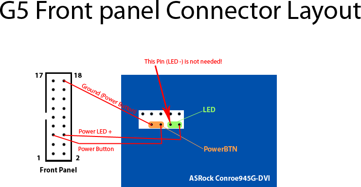

Mac'ovod Posted April 19, 2010 Share Posted April 19, 2010 Please, help! How to weld the front panel to work - USB / LED / Power Button?! Link to comment https://www.insanelymac.com/forum/topic/4525-discussion-fit-a-pc-in-a-g5-powermac-enclosure/page/39/#findComment-1451844 Share on other sites More sharing options...
scarletvw Posted April 20, 2010 Share Posted April 20, 2010 Please, help! How to weld the front panel to work - USB / LED / Power Button?! Please read through the ENTIRE topic. It WILL answer pretty much every question you have. Link to comment https://www.insanelymac.com/forum/topic/4525-discussion-fit-a-pc-in-a-g5-powermac-enclosure/page/39/#findComment-1452273 Share on other sites More sharing options...
Manu0600 Posted April 20, 2010 Share Posted April 20, 2010 Searched less than 5 page before this one and found this drawing. Hope it will help you Could all of you share your location ? Could be interesting to know in what country the best modders are… lol I am from brussels in belgium Link to comment https://www.insanelymac.com/forum/topic/4525-discussion-fit-a-pc-in-a-g5-powermac-enclosure/page/39/#findComment-1452322 Share on other sites More sharing options...
Mac'ovod Posted April 21, 2010 Share Posted April 21, 2010 YES!!!! I started LED/ Power Button and... USB! YEE!! )) This here: I'll try to make sound-out! Sorry for my English - I'm from Russia Link to comment https://www.insanelymac.com/forum/topic/4525-discussion-fit-a-pc-in-a-g5-powermac-enclosure/page/39/#findComment-1452654 Share on other sites More sharing options...
Mac'ovod Posted April 21, 2010 Share Posted April 21, 2010 Friends! Look please! 100% Work: LED, Button, Sound-Out, USB! Link to comment https://www.insanelymac.com/forum/topic/4525-discussion-fit-a-pc-in-a-g5-powermac-enclosure/page/39/#findComment-1452888 Share on other sites More sharing options...

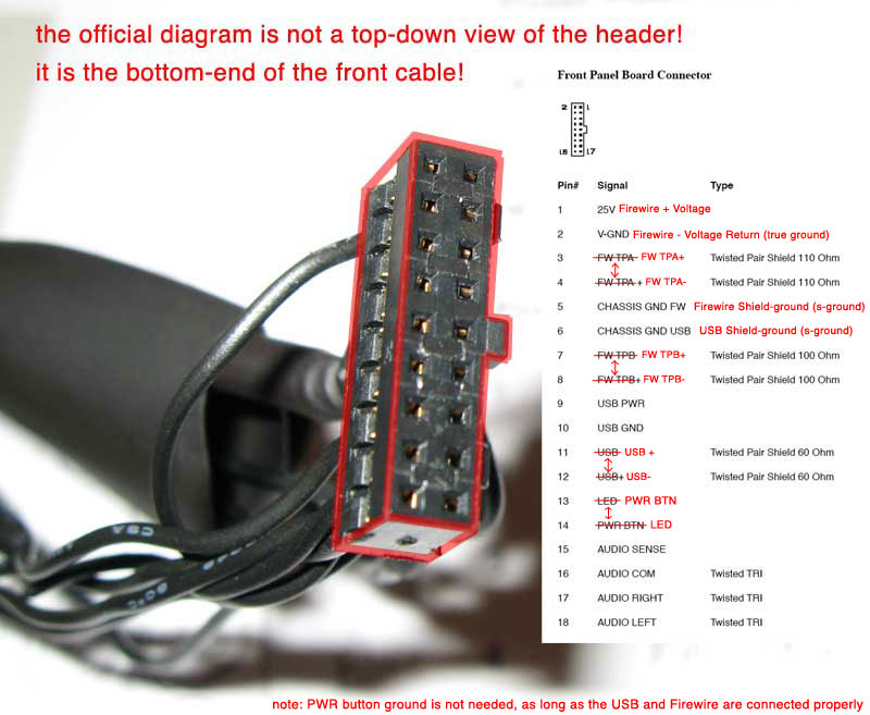

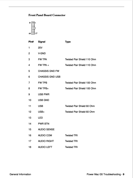

Manu0600 Posted April 22, 2010 Share Posted April 22, 2010 Found a COMPLETE diagram of the front panel Edit : the official diagram doesn't seems to be working : here is all the thigs to change to the official diagram Link to comment https://www.insanelymac.com/forum/topic/4525-discussion-fit-a-pc-in-a-g5-powermac-enclosure/page/39/#findComment-1453594 Share on other sites More sharing options...
