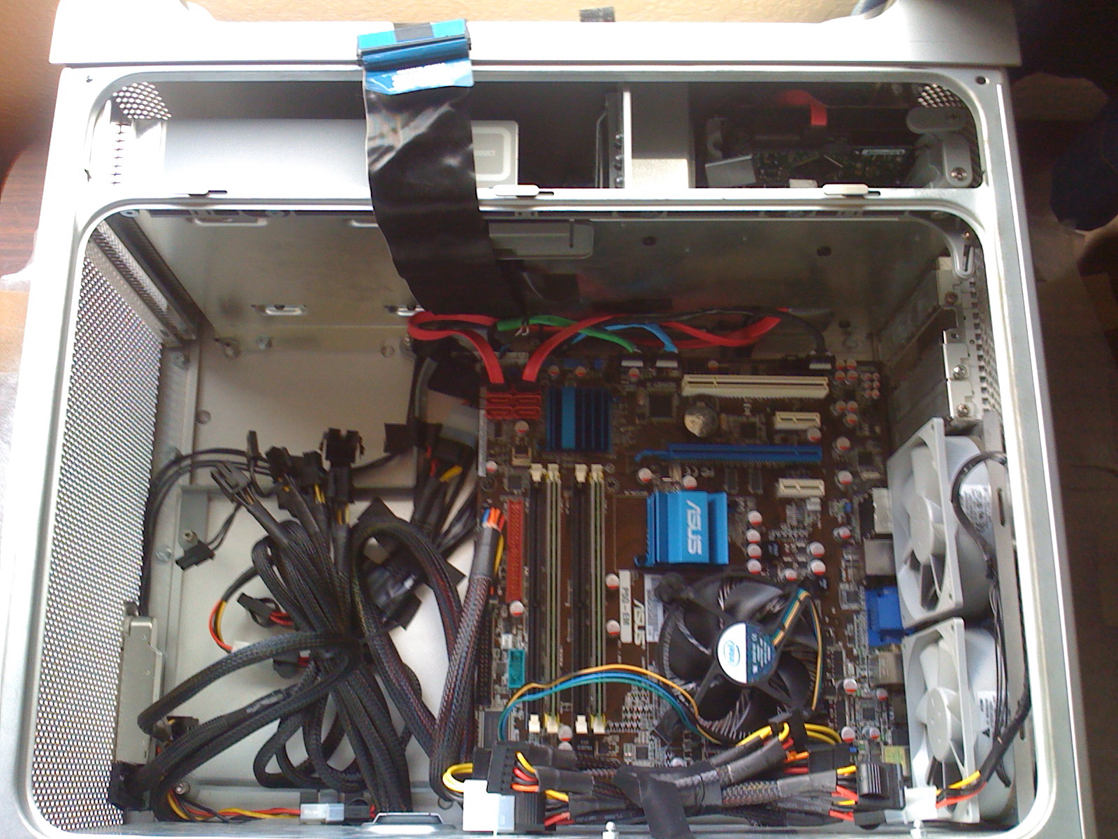

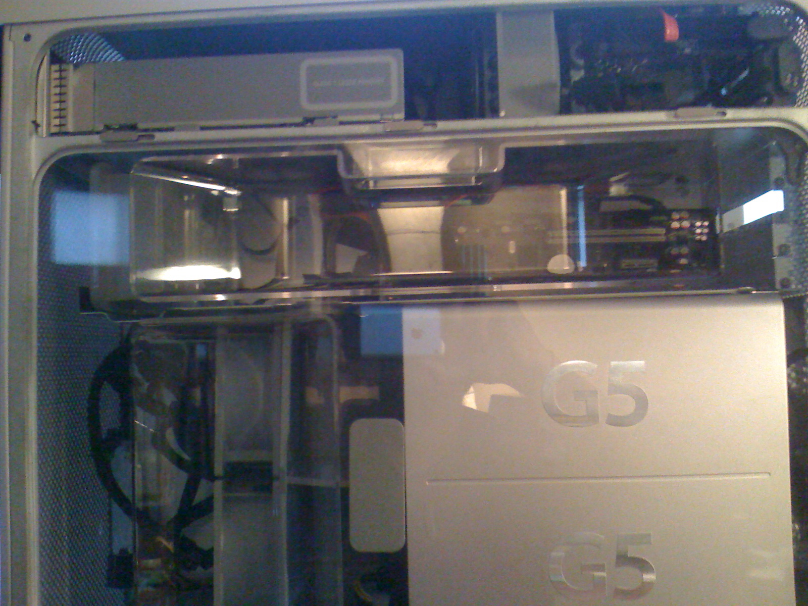

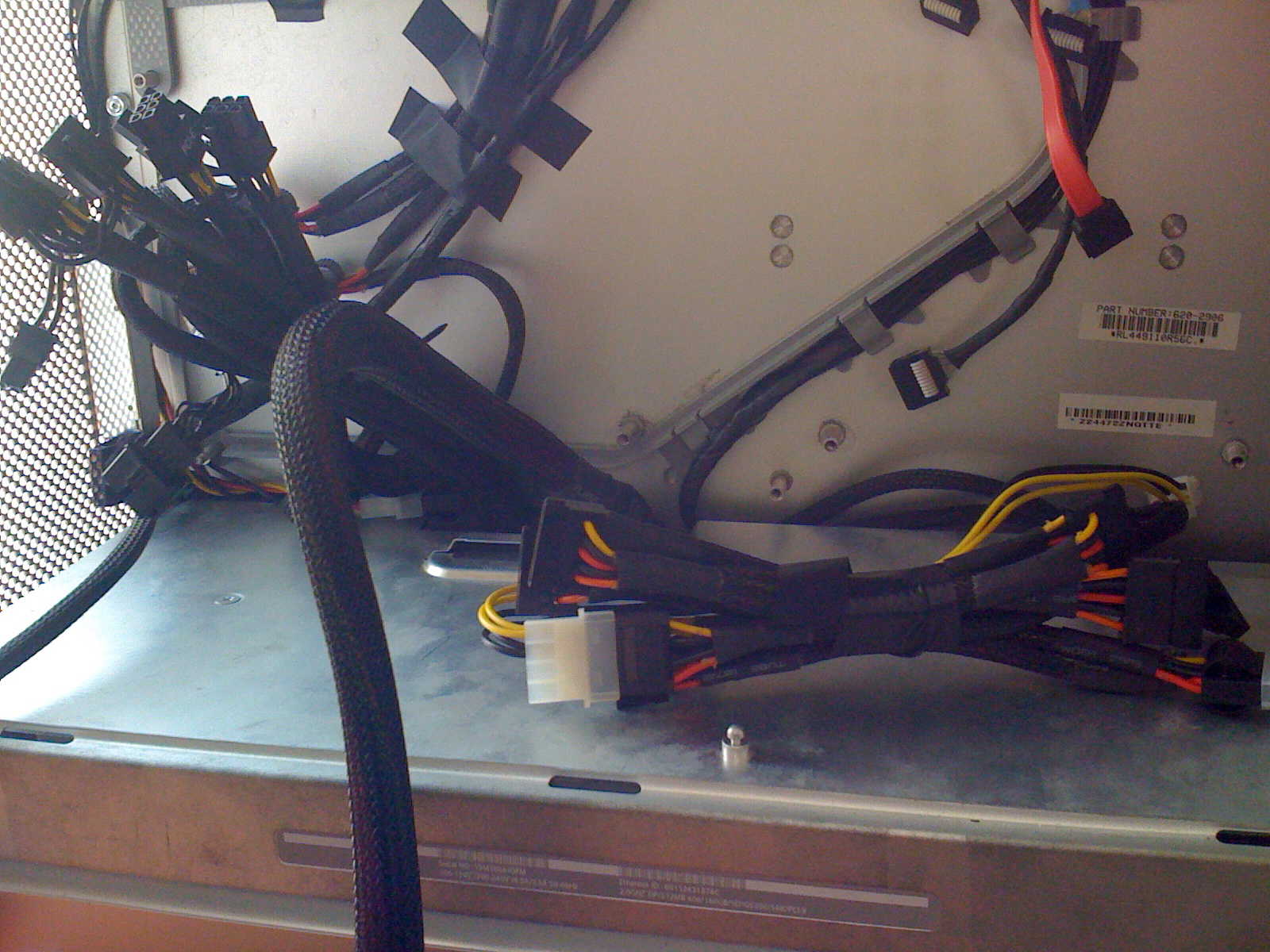

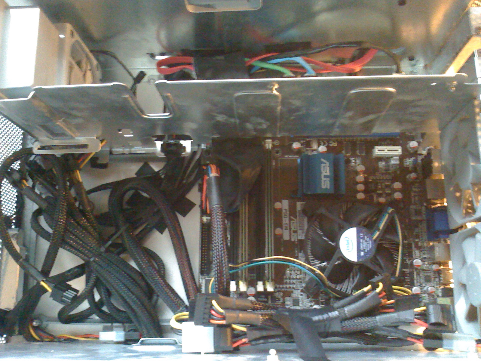

Neonflux Posted January 18, 2010 Share Posted January 18, 2010 Got my Hackintosh working on SL (except the graphics on ASUS mobo). My aim was to make it look exactly like G5 internals And Finally... Link to comment https://www.insanelymac.com/forum/topic/4525-discussion-fit-a-pc-in-a-g5-powermac-enclosure/page/37/#findComment-1388137 Share on other sites More sharing options...
ronsega Posted January 20, 2010 Share Posted January 20, 2010 Got my Hackintosh working on SL (except the graphics on ASUS mobo).My aim was to make it look exactly like G5 internals Looking good, hows the G5 I/O cable doing? I got mine all finished too. You definitely made it look like an original. As for mine, it definitely is not! Link to comment https://www.insanelymac.com/forum/topic/4525-discussion-fit-a-pc-in-a-g5-powermac-enclosure/page/37/#findComment-1390216 Share on other sites More sharing options...

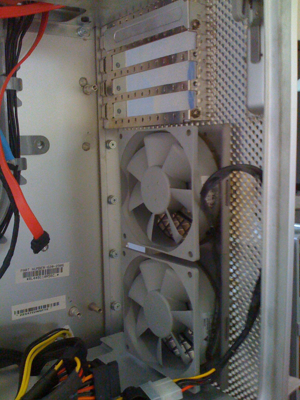

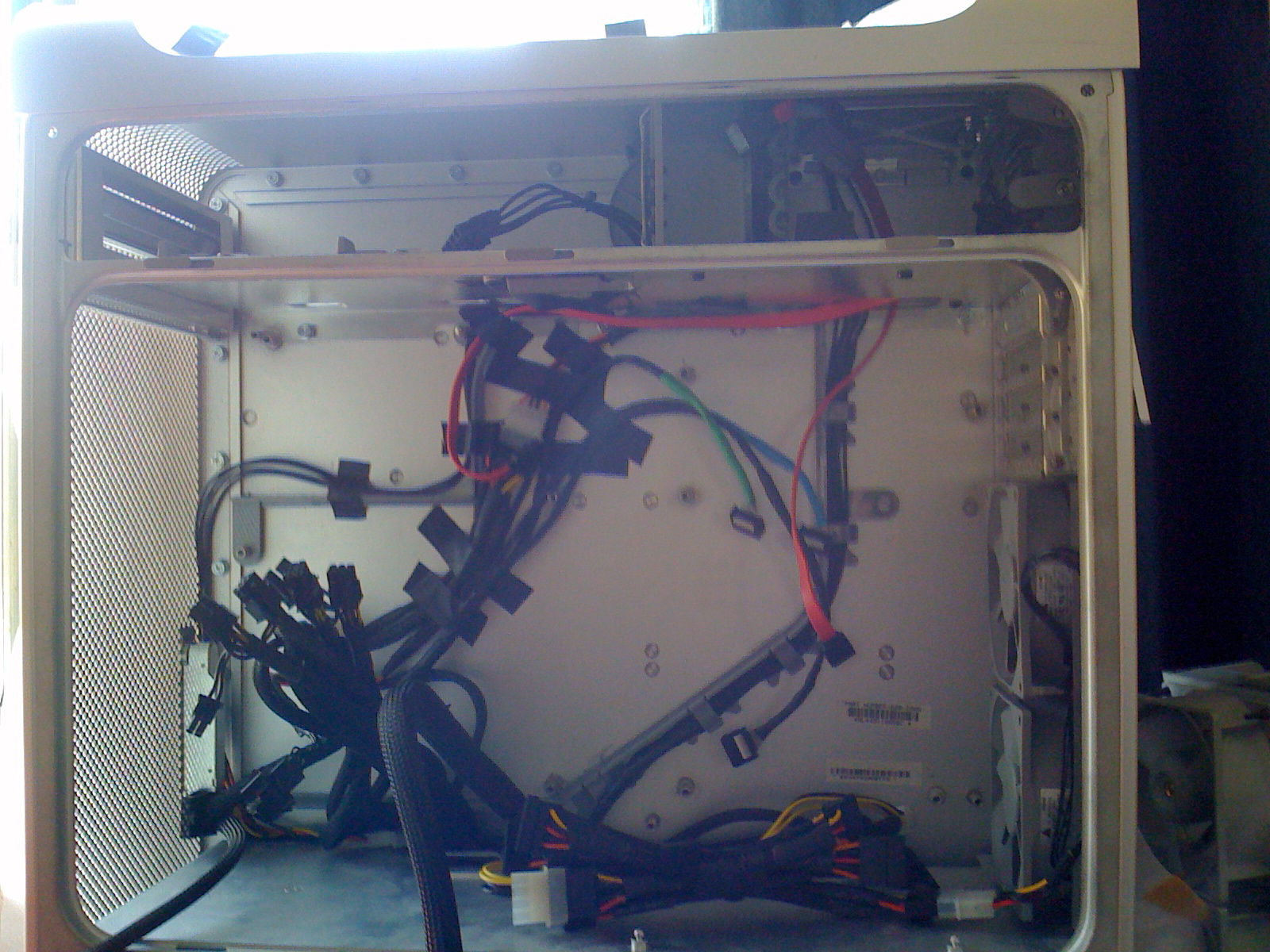

oshak Posted January 24, 2010 Share Posted January 24, 2010 Ok, 5 pcbs done in total, 2 cable sets. But back to my own project Got the BlackIce 184 GTX today, that's one fat rad. Need to little improve that mounting, not the most secure there is. Yes that rad will come over the first pci/pcie slot, worry not in my mobo pci-e x16 slot is at second place, that is just dead dummy board Xsolid, just wondering if you could make me a wire adapter for the front panel G5? i suck at electrical... i would totally pay more than what you said on previous post, PM when you get this because your mailbox is full! thanks!! Louis Link to comment https://www.insanelymac.com/forum/topic/4525-discussion-fit-a-pc-in-a-g5-powermac-enclosure/page/37/#findComment-1394857 Share on other sites More sharing options...

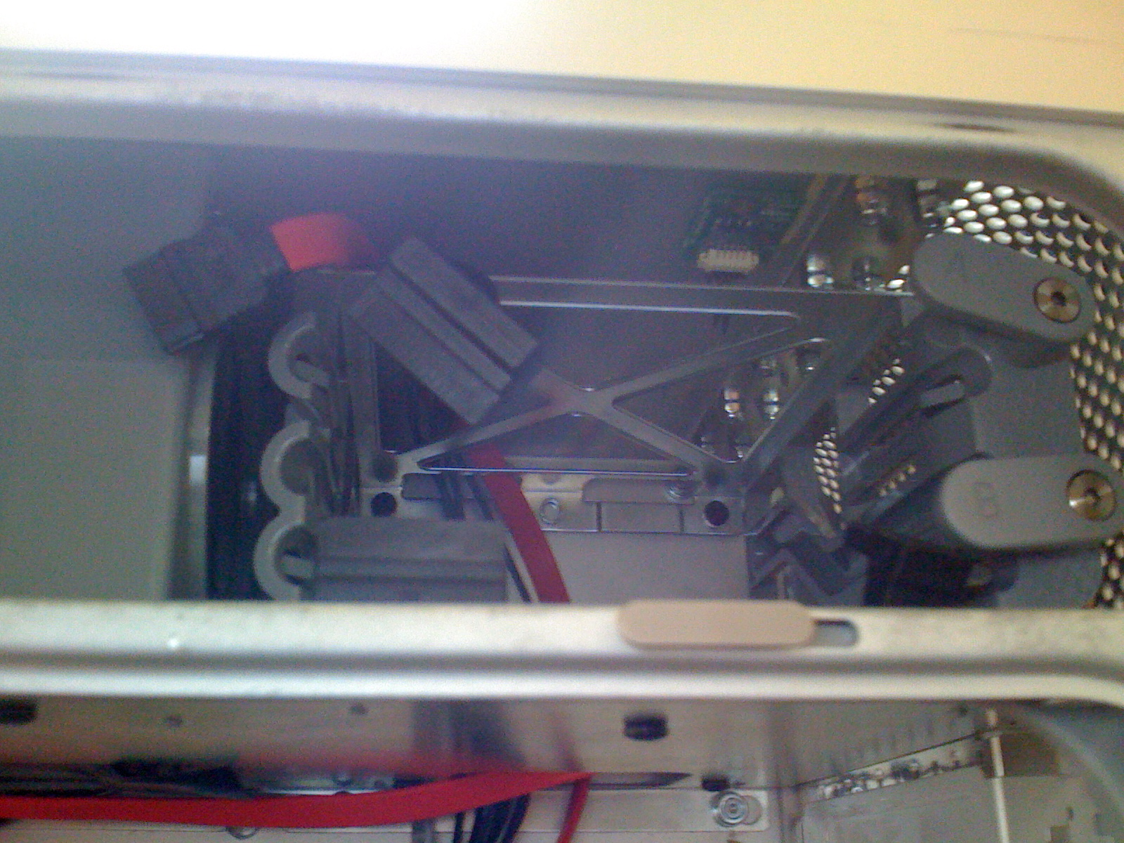

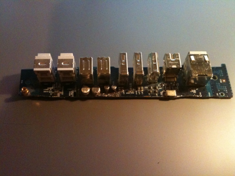

M4K10 Posted January 25, 2010 Share Posted January 25, 2010 Just finished my own G5 mod. I mounted a tray on some standoffs for my matx board and ran jumpers to custom made panel mounts. I also went for the original G5 motherboard rear panel approach and sawed off the section needed. But I have hit a snag, my hackintosh continues to give me "usb current overdraw notice" every time i plug something other than say my usb bluetooth adapter into the adapter i created. When i plug in a hard drive, i get the error over and over again. I will have to rip the computer apart again so that i can look at my adapter, although i am sure it is not my soldering as i triple checked for bridges and such. Anyway, when i get everything running smooth i will post up some pics. Link to comment https://www.insanelymac.com/forum/topic/4525-discussion-fit-a-pc-in-a-g5-powermac-enclosure/page/37/#findComment-1395086 Share on other sites More sharing options...

oshak Posted February 2, 2010 Share Posted February 2, 2010 i gutted the case, welded new motherboard insert, cuted the back for lianli mobo tray, made a bracket for double 120mm rad, things are coming along... when i gutted the case i found a heat sensor on the top of the HDD bay and on the bottom, anyone was successful using it ? i will be running 2 x1.5tb on the hd bay, i am scared things will fry... any idea? cheers! Link to comment https://www.insanelymac.com/forum/topic/4525-discussion-fit-a-pc-in-a-g5-powermac-enclosure/page/37/#findComment-1402365 Share on other sites More sharing options...

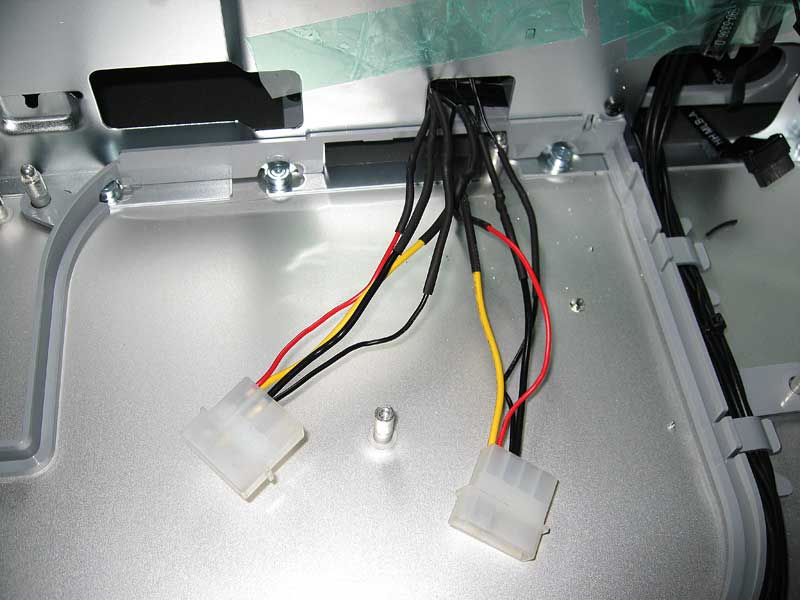

oshak Posted February 6, 2010 Share Posted February 6, 2010 is this thread dead? anyone over here? i have tons of question, another one about wiring the hdd fan... to wire the fan on a molex in 5v, do i put the 2 (12v and 5v) wires on the red , connect the 2 ground in the middle on black and the leave the yellow empty? i am not sure what im doing nd i dont want to fry the fans... on previous post that was posted " I sent both +12v lines to one molex, and then both +5v to another molex, but you can arrange things however you want, as long as you power the outer lines, and ground the 2 inner lines." and he posted a picture but doesnt seem like that, seem like 12 and 5v are connected together. i am confuse... help please! Link to comment https://www.insanelymac.com/forum/topic/4525-discussion-fit-a-pc-in-a-g5-powermac-enclosure/page/37/#findComment-1404605 Share on other sites More sharing options...
Baudouin Posted February 9, 2010 Share Posted February 9, 2010 is this thread dead?anyone over here? i have tons of question, another one about wiring the hdd fan... to wire the fan on a molex in 5v, do i put the 2 (12v and 5v) wires on the red , connect the 2 ground in the middle on black and the leave the yellow empty? i am not sure what im doing nd i dont want to fry the fans... on previous post that was posted " I sent both +12v lines to one molex, and then both +5v to another molex, but you can arrange things however you want, as long as you power the outer lines, and ground the 2 inner lines." and he posted a picture but doesnt seem like that, seem like 12 and 5v are connected together. i am confuse... help please! If you connect the cables respecting the colors, red to red and yellow to yellow, the fans will blow at full speed 12V, same if you connect all the cables to the yellow; 12V. To have your fans blowing slower: 5V, you have to connect the two colored cables from the fan, red and yellow to the red one from the molex, so your fans will run @5V. Yoou can make one plug for each fan or connect all the cables together depending if you want to be able to connect the fans separatly; one at a time or the both always at the same time. Link to comment https://www.insanelymac.com/forum/topic/4525-discussion-fit-a-pc-in-a-g5-powermac-enclosure/page/37/#findComment-1406788 Share on other sites More sharing options...
oshak Posted February 10, 2010 Share Posted February 10, 2010 If you connect the cables respecting the colors, red to red and yellow to yellow, the fans will blow at full speed 12V, same if you connect all the cables to the yellow; 12V. To have your fans blowing slower: 5V, you have to connect the two colored cables from the fan, red and yellow to the red one from the molex, so your fans will run @5V. Yoou can make one plug for each fan or connect all the cables together depending if you want to be able to connect the fans separatly; one at a time or the both always at the same time. thank! ill get to work now! here another question... my last one i think... i want to extend the psu wire to the back of the case with a foot or normal electrical wire., i need to know how do i connect... brown with black, blue with white and green together? i never seen brown and blue wire before... i guess all power supply have them but its my first mod... cheers!! Link to comment https://www.insanelymac.com/forum/topic/4525-discussion-fit-a-pc-in-a-g5-powermac-enclosure/page/37/#findComment-1407257 Share on other sites More sharing options...
Baudouin Posted February 10, 2010 Share Posted February 10, 2010 thank!ill get to work now! here another question... my last one i think... i want to extend the psu wire to the back of the case with a foot or normal electrical wire., i need to know how do i connect... brown with black, blue with white and green together? i never seen brown and blue wire before... i guess all power supply have them but its my first mod... cheers!! I guesss you're talking about a PC PSU. So you connect one wire (brown or blue) from the PSU to one (white or black) from the normal electrical and the two green together. You have some nice Powermac G5 fans diagrams from technojunkie. I am showing the soldering in Visit My Hackintosh from the post 15. Cheers, Link to comment https://www.insanelymac.com/forum/topic/4525-discussion-fit-a-pc-in-a-g5-powermac-enclosure/page/37/#findComment-1407274 Share on other sites More sharing options...
oshak Posted February 10, 2010 Share Posted February 10, 2010 I guesss you're talking about a PC PSU. So you connect one wire (brown or blue) from the PSU to one (white or black) from the normal electrical and the two green together.You have some nice Powermac G5 fans diagrams from technojunkie. I am showing the soldering in Visit My Hackintosh from the post 15. Cheers, i dont understand... i wired the fan the way you told me all one one molex so i can just have them running all thetime... when i plug it in my psu, the psu shuts down, what the hell? does it do that when your connection are wrong? i hope they are not because they all black and i didnt write what is what... what a headache? ill look at your post for sure... Link to comment https://www.insanelymac.com/forum/topic/4525-discussion-fit-a-pc-in-a-g5-powermac-enclosure/page/37/#findComment-1407312 Share on other sites More sharing options...
