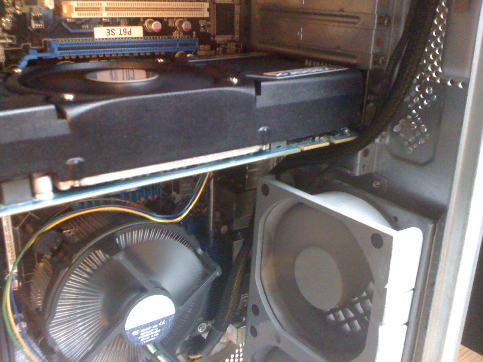

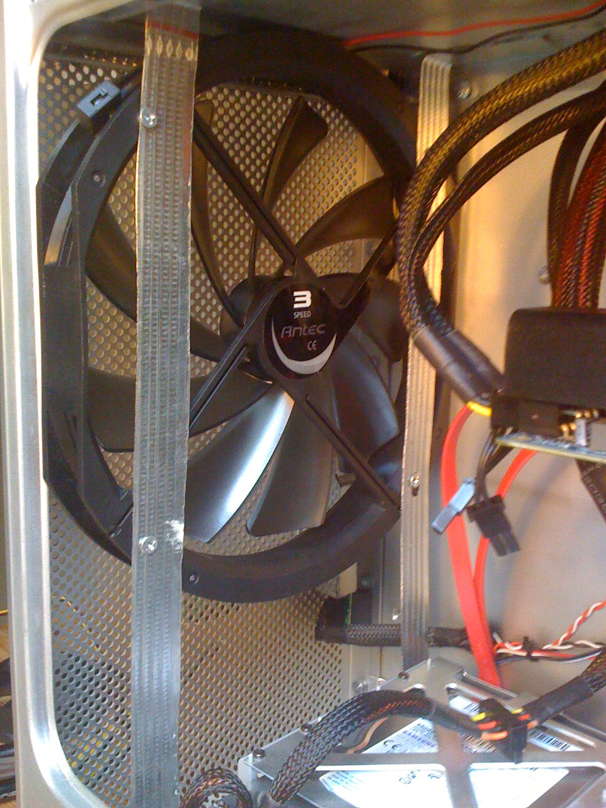

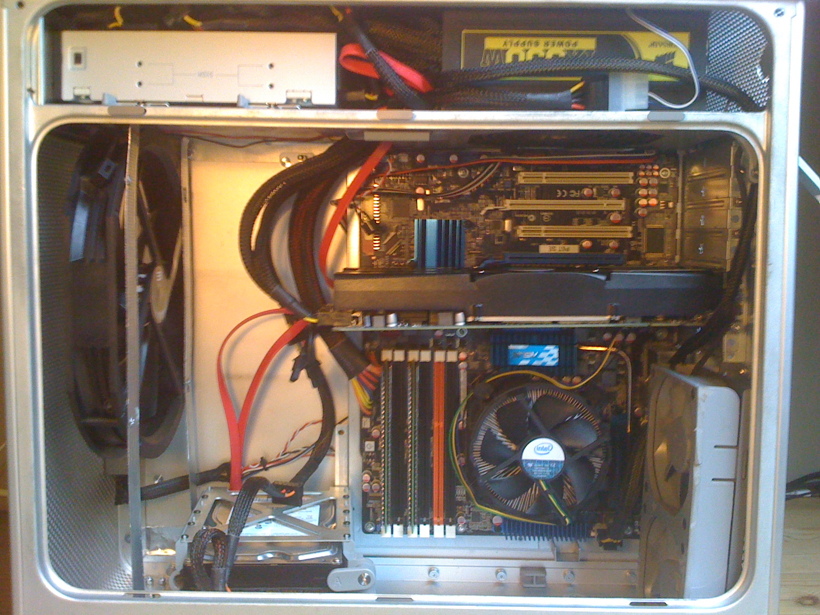

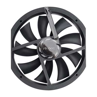

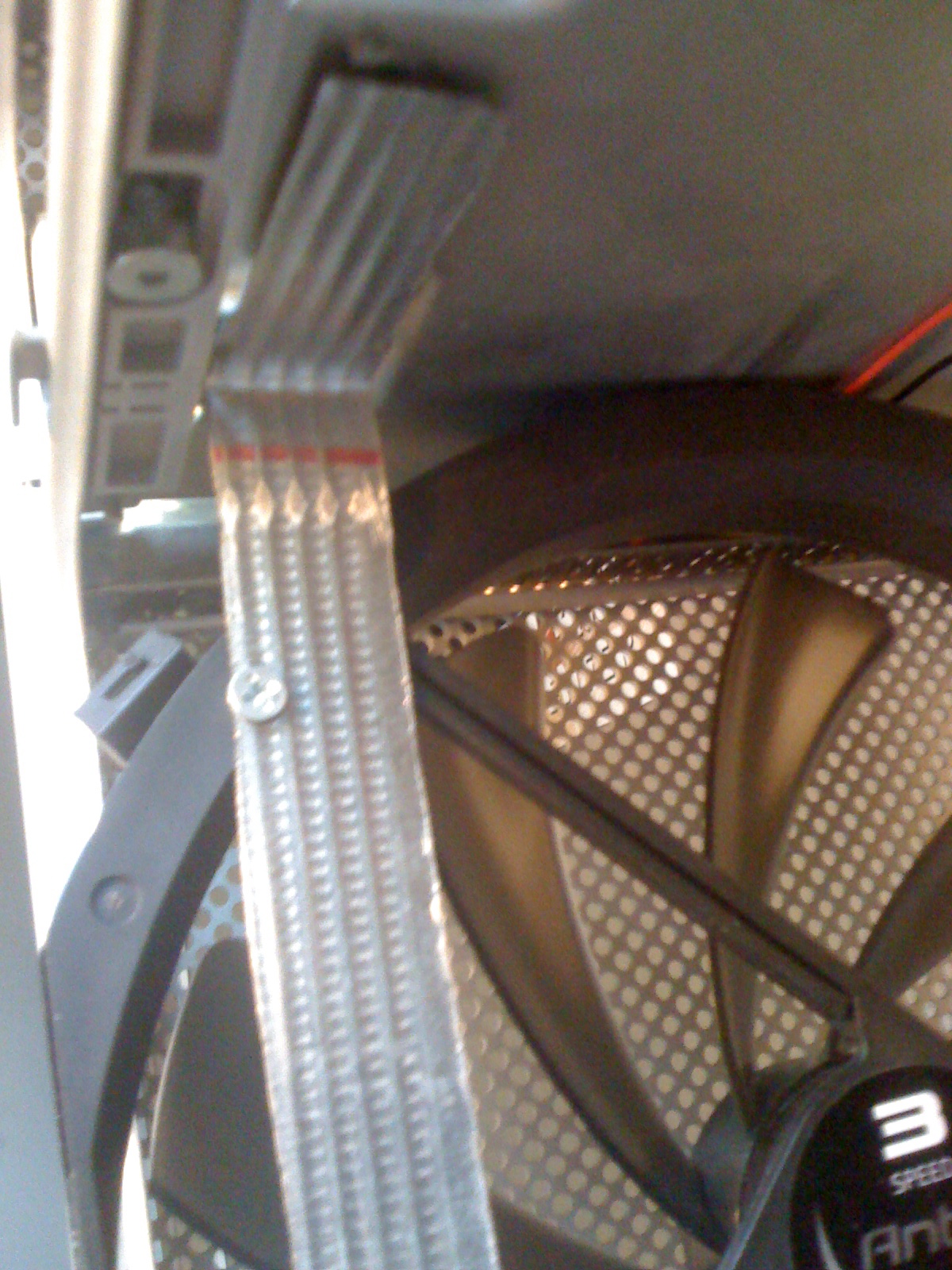

Manu0600 Posted August 16, 2010 Share Posted August 16, 2010 little update for me : I've aded a 200mm fan at the front of the case : the Antec Big Boy. It fits perfectly : 1mm larger and the case wouldn't close. I'll post some photos later. Link to comment https://www.insanelymac.com/forum/topic/4525-discussion-fit-a-pc-in-a-g5-powermac-enclosure/page/41/#findComment-1531443 Share on other sites More sharing options...

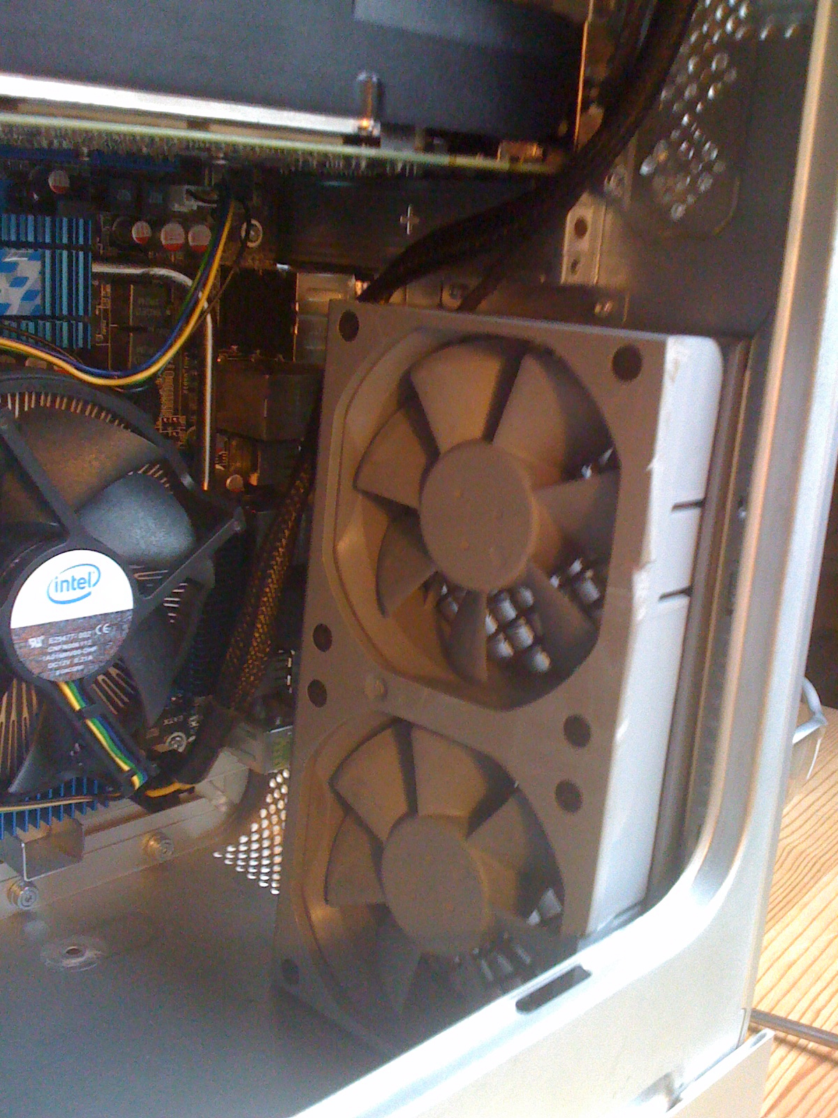

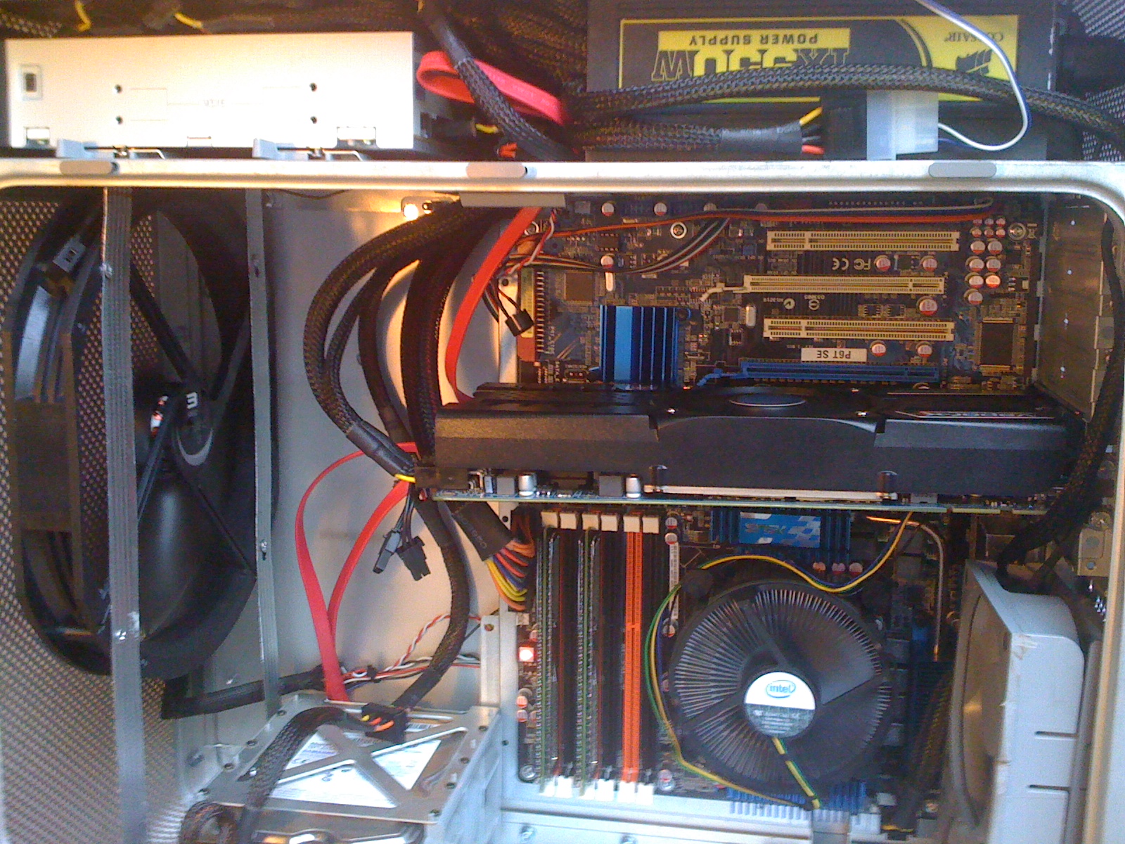

Manu0600 Posted August 27, 2010 Share Posted August 27, 2010 I am now posting the photos of my mobo with the 200mm fan : Here is the system up and running under Mac OS X (you don't see right there that it is OS X, but it is !! The only thing you see are the fans spinning... lol) Link to comment https://www.insanelymac.com/forum/topic/4525-discussion-fit-a-pc-in-a-g5-powermac-enclosure/page/41/#findComment-1538306 Share on other sites More sharing options...

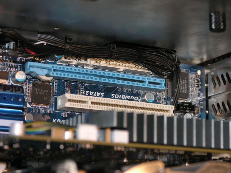

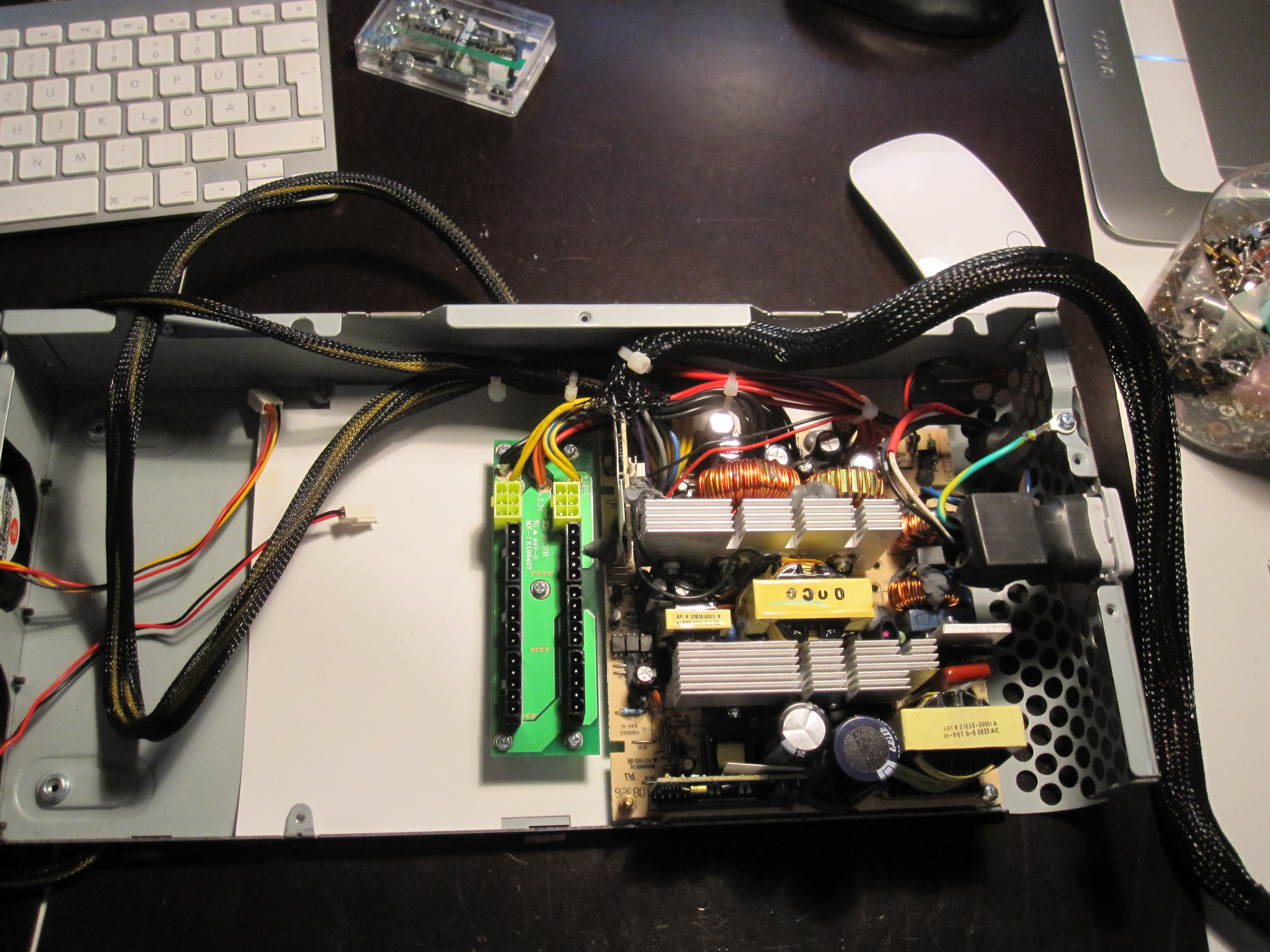

PoloBear Posted September 4, 2010 Share Posted September 4, 2010 PSU: If you mount the PSU at th bottom of the case, there is plenty of space... G5 PSU is huge, PC really small, the use the original PSU case is advised... the cover holds the screws of the separating plate...but then you use this space... I didn´t put the disks down there, hard to reach them.... HEIGHT: 285 mm Link to comment https://www.insanelymac.com/forum/topic/4525-discussion-fit-a-pc-in-a-g5-powermac-enclosure/page/41/#findComment-1542605 Share on other sites More sharing options...

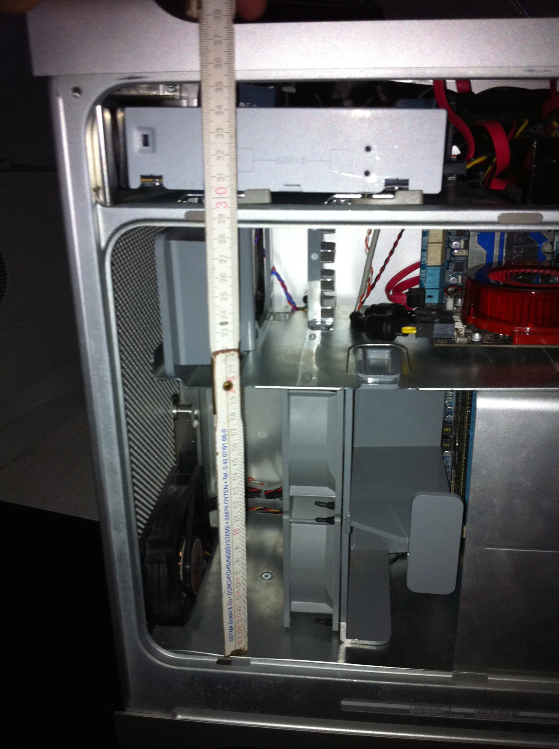

rorydaredking Posted September 4, 2010 Share Posted September 4, 2010 Cheers mate, I tried scaling it from a picture on my screen, then working it out, and I got 290mm roughly. So not a bad guess at all. Looks like I will just about be able to fit my gigabyte X58A-UD3R board in (the one from tonymac's custoMac Pro) sideways, and then have enough room to connect display extensions! Excellent Also, I am planning on going down the original usb etc port board, and soldering extensions onto that. Will USB 3.0 work if I use a 3.0 certified extension cable and shield it properly? Or will the port itself stop the USB 3.0? Rory Link to comment https://www.insanelymac.com/forum/topic/4525-discussion-fit-a-pc-in-a-g5-powermac-enclosure/page/41/#findComment-1542803 Share on other sites More sharing options...

PoloBear Posted September 5, 2010 Share Posted September 5, 2010 I didn´t cut the case, just added lots of USB-Ports and made everything work with usb... I use a Soundblaster Xfi, boot time went down to 6 seconds, and no more problems with lost audio on Gigabyte-board.... Bluetooth dongle is small enough to fit in the case. Network Cards either PCI or USB, wired or wireless possible. And the machine works fine, quiet and cool... Link to comment https://www.insanelymac.com/forum/topic/4525-discussion-fit-a-pc-in-a-g5-powermac-enclosure/page/41/#findComment-1543251 Share on other sites More sharing options...
